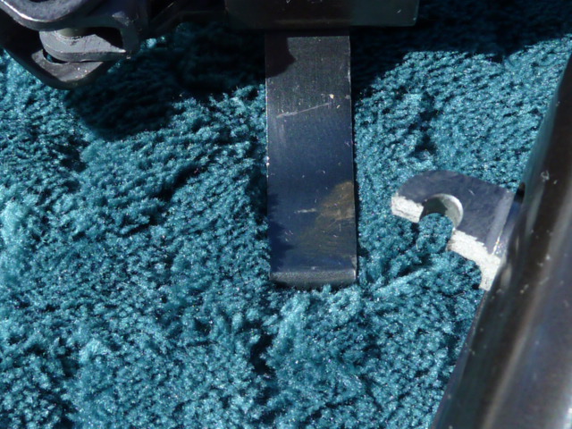

Well I had a long review of mine (K98 springer; purchased 9/2020) almost written up and then one 'static spark' and computer locked up and all was lost. Since I don't have the desire at this time to do it all over again, here is the 'condensed version':
While I really like the K98's appearance, I cannot recommend one based on the experience with mine. The second time I took it out (first time was sight-in and chrono), the gun had a significant failure after the first shot (less than 100 pellets fired total since new):
The cocking stroke was suddenly way "off" and then I could not cock the gun. When I got home, I discovered the "hinge pin" (the part the cocking arm is attached to to push the compression tube back during cocking) had fractured in half (see photo). In addition, the wood-stock had split (4-5" in length) at one side of the underarm slot, and there was another gouge on the top (appears the anti-bear-trap safety release lever had impacted it). Obviously, this gives me a very disappointed type rating (and a "cannot recommend", for either the K98, and the 460 "Magnum" which appears to share the same 'action').
The piece that fractured appears to be way too thin/small to handle the force applied to it during cocking of such a powerful springer. In addition, the piece seems to be made of what we used to call "pot metal" (possibly a sintered or MIM piece). I'm not sure how many other owners have had such a failure, but to have it happen in essentially a brand-new gun does not give me any confidence that it will hold up after repair. "Buyer(s) Beware!!"
In another post, I wrote up my thoughts on the K98 (springer version). In short, I really liked everything except 2 things:
1) the cocking arm latch seems poor: it doesn't take much of a bump for the arm to release and drop down. Sometimes, the arm releases at the vibration of the shot.
2) Much more of an issue is the fact my K98 broke in less than 100 shots. The "hinge pin" (connects cocking arm to compression tube) fractured; the result being inability to cock the gun, and a 4+" long split in the wood stock. The part appears totally inadequate (and, possibly made of cheap 'sintered' or MIM metal) to handle the high forces applied to it cocking such a powerful springer (mine chrono'd around 1050 fps in 0.177 with 8 gr. pellets).
OK, maybe 3 things I did not like, #3 being what appears to be trigger guard and fore-end band made of plastic.
REAL nice looking gun though (but it's real tough for me to get past that failure at 100 rounds....). Photo is of the broken hinge pin:

Well, I messed up here-putting the same info (about my K98 breakage) on this post twice....
Anyway, I am not sure if I got what we call in the USA a "Lemon" (a bad one) or not. There has to be quite a few similar 460 Magnums around, and the K98 'action' seems to be more or less a model 48/52 changed form sidelever to underlever cocking (a parts diagram for the 48 shows what appears to be the same "hinge pin" part that connects the cocking arm to the sliding compression tube), and I know there are a LOT of 48/52s around and I cannot imagine they are all breaking that piece.
Did, by chance Diana recently change the material of that hinge pin (say, from machined to cast or MIM or something with less strength) or is mine a "1 in 100,000" defective one? I guess I'll send it in for warranty repair and see what happens (still not happy about having to pay $40+ to ship the gun in though...).
