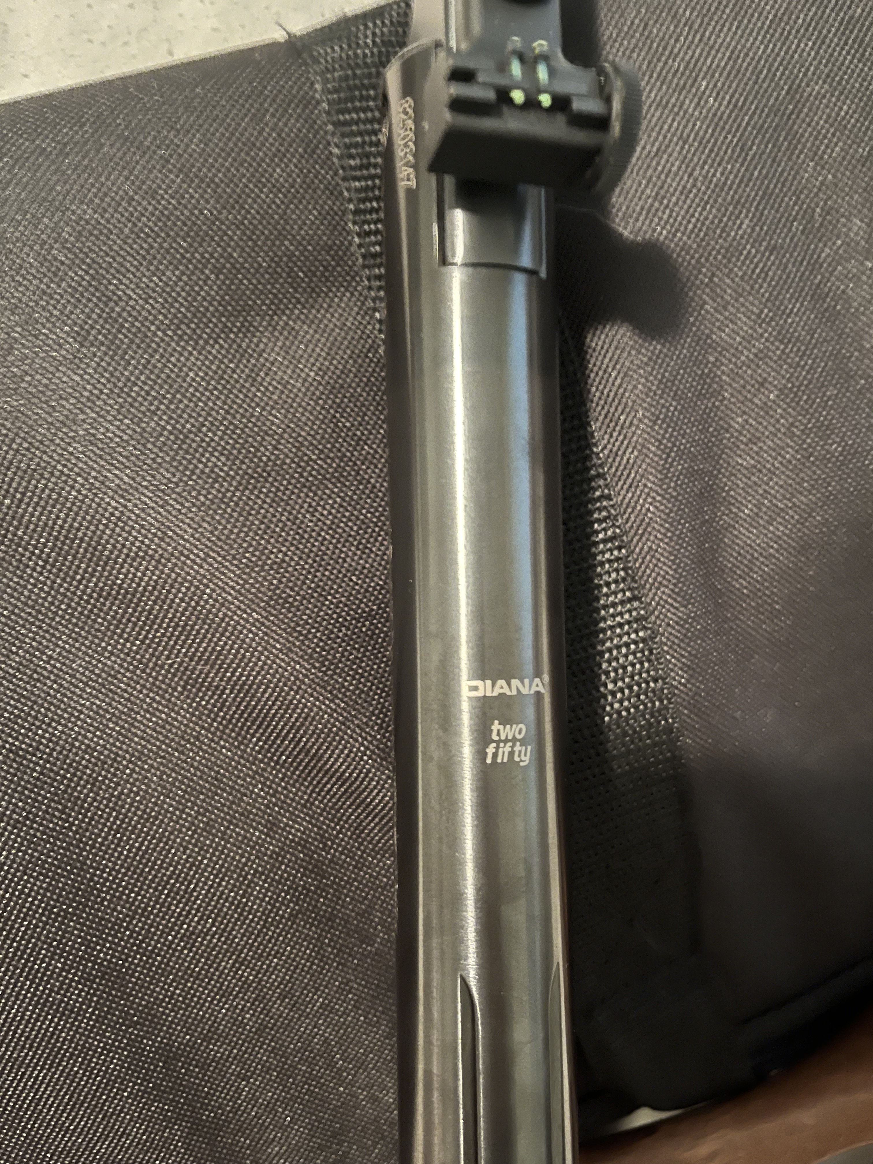

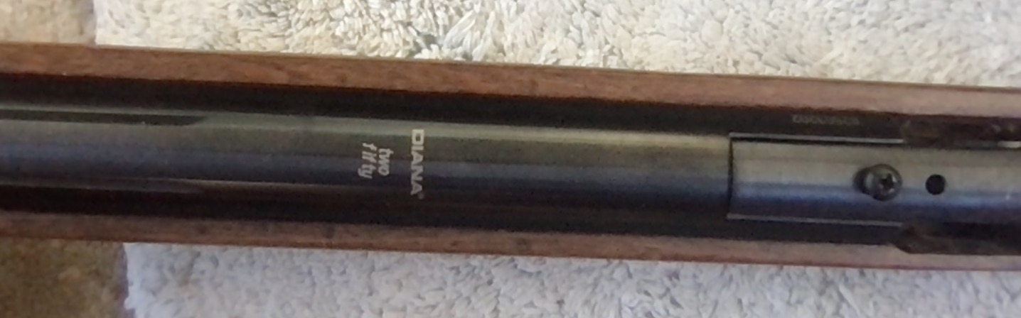

There's a difference between your model 250 and a model two fifty, the mod.250 is a vintage rifle made in Germany, the Mod. two forty, two fifty, and two sixty are made in China for Diana, they are meant to be inexpensive entry level air rifles, they are easily identified by the model markings, German made rifles marked with numbers, the Chinese made rifle are have the numbers spelled out, 250 vs two fifty in lower case letters, the Chinese made rifles are Nitro Piston powered.
Pics
