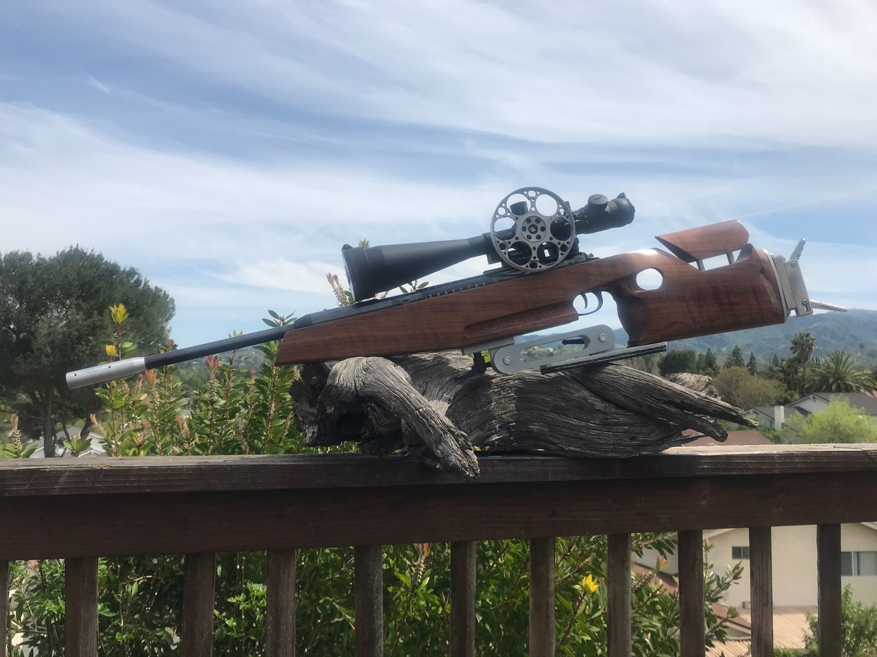

We will see...just need a range to sight in
