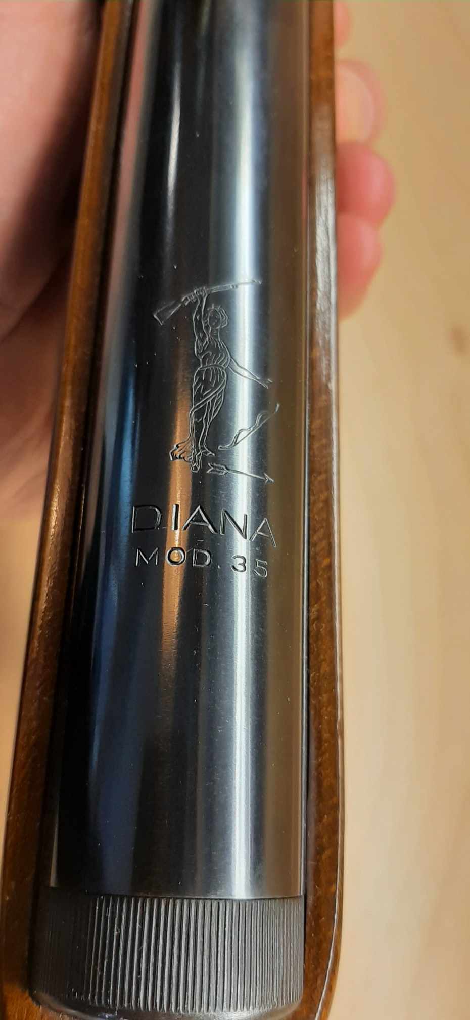

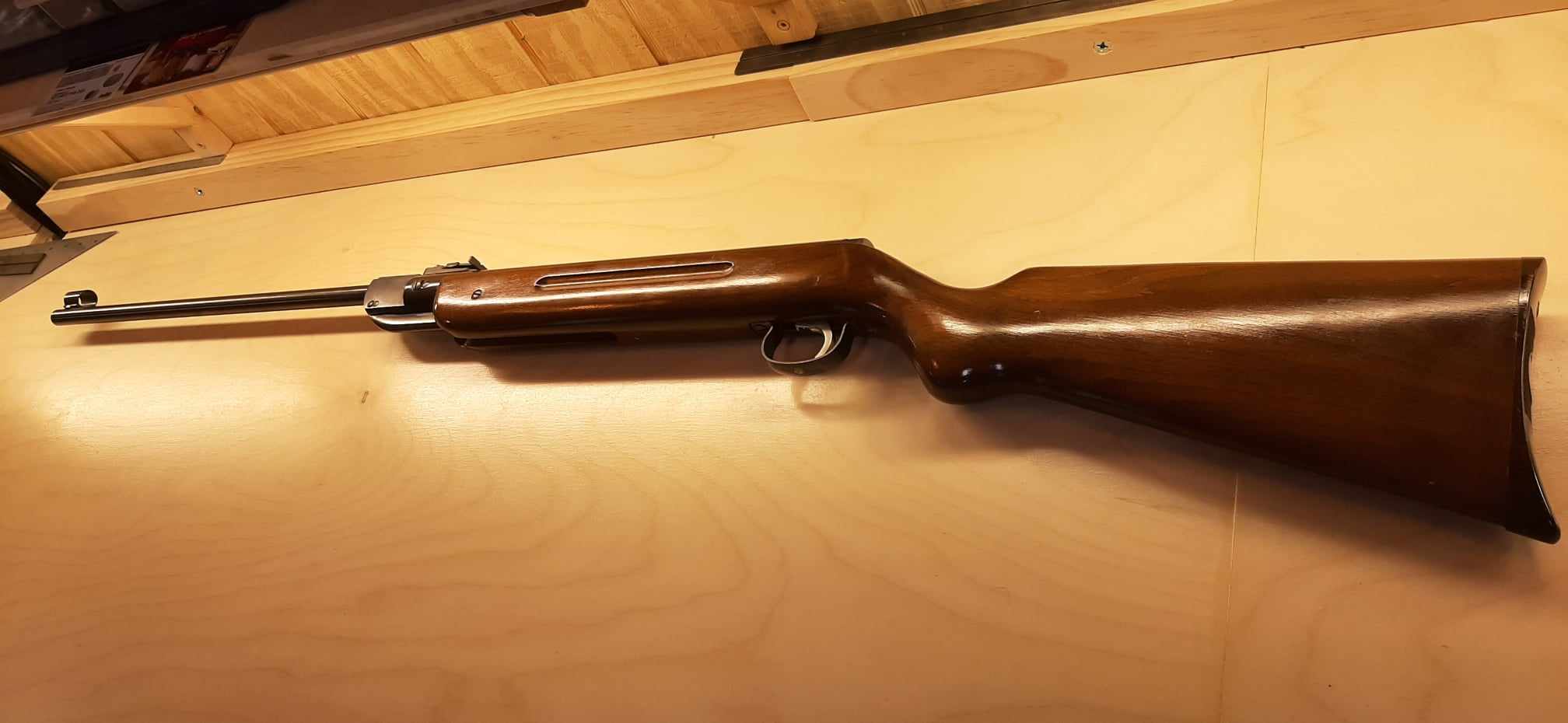

Greetings. New member and first post. I am new to air guns as I recently acquired a Diana Model 35 from my father-in-law. I believe he purchased it in, what was then, West Germany around 1950. It has seen little use, and has been well stored. It probably has not been fired in 10-15 years until one recent test cock and pull with no ordinance. That may have been a dumb move on my part as I'm not sure what, if any, maintenance has been performed. I assume that good seals are key to a compressed air rifle.

I'm also curious about the manufacture date. As mentioned, I believe it was purchased by my FIL in the early 50s. From what I have read so far, there have been several mods to the gun before it was discontinued/replaced in the 80s. It does not have a manufactured date anywhere on the metal body. I understand that the dating on the barrel where it meets the wood stock didn't start until the 60s. There is a lovely image of a woman (statue?) dropping her bow and arrow while her airgun overhead.

Probably late-50's, early-60's gun. The lovely aluminum trigger and slender finger-groove stock went out around 1964, give or take. Should be around 700 FPS with light .177 ammo if in good fettle.
Dianas of that era have VERY high-quality mainsprings and leather piston seals. It is always wise to take down and check out a gun so old - to make sure some kid hasn't tried to shoot nails out of it etc.! - but in the condition you describe it may need nothing more than a bit of lube down the transfer port (for which my choice would be Beeman Ultra Lube, or Abbey SM 50).
