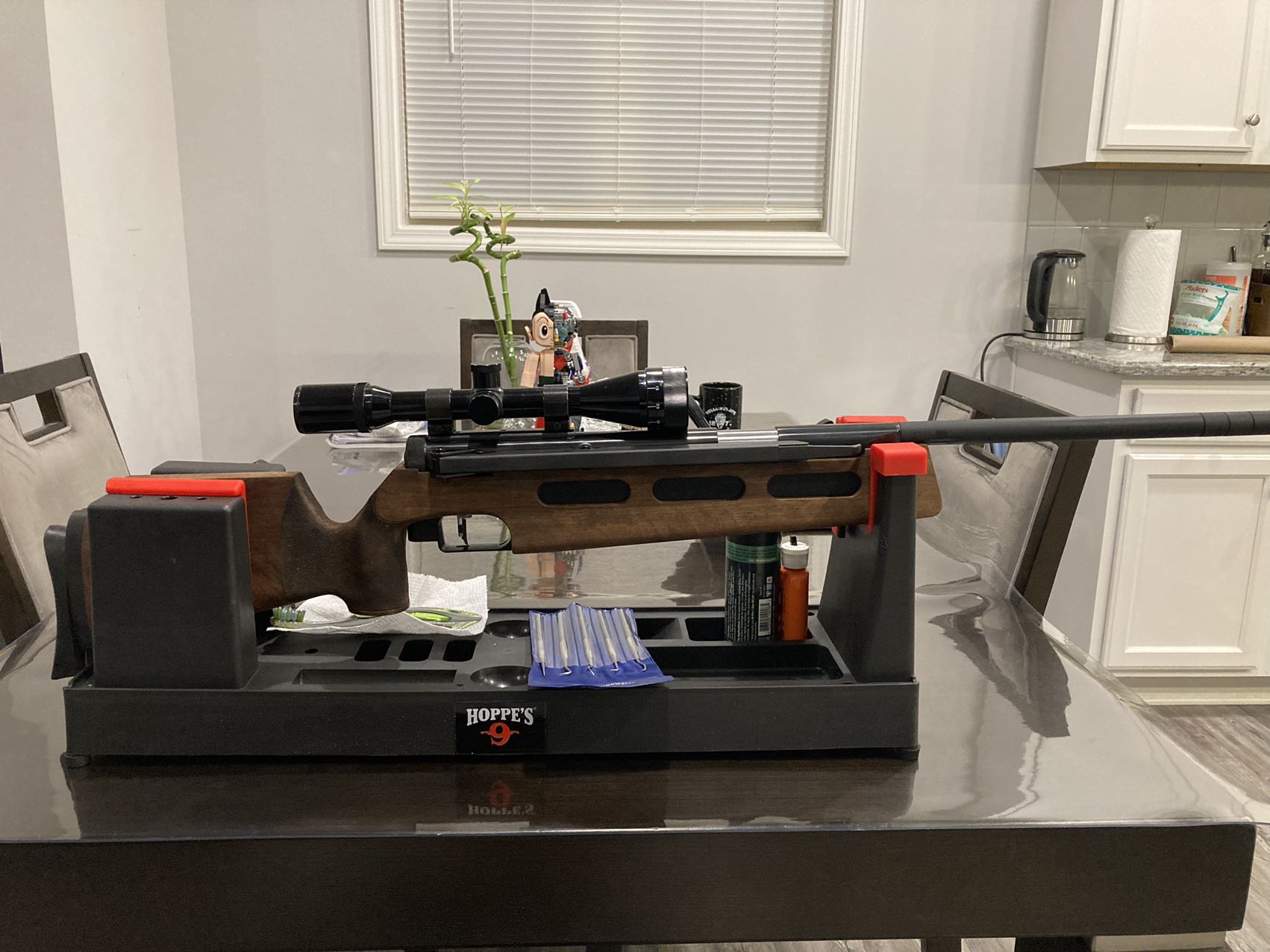

I just got a diana model 75 yesterday, it looks very nice so I think it is ready to shoot. I spend about an hour to cleaning and oil it up to made she looks prettier. The wood stock is very good and the bluing is shiny, cocking is smooth and I really like the cocking sound, the trigger is very light. I was very excited and I fired it, and then the pellet didn't move. :ROFLMAO::ROFLMAO:
I really like the rifle, but I know model 75 is hard to repair especially that I have two stupid hands.
