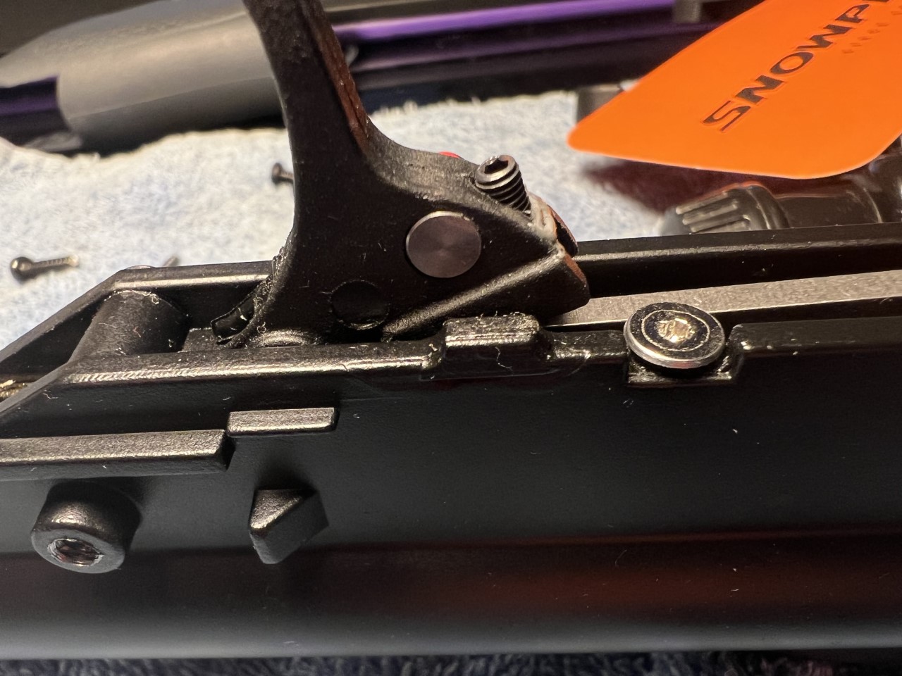

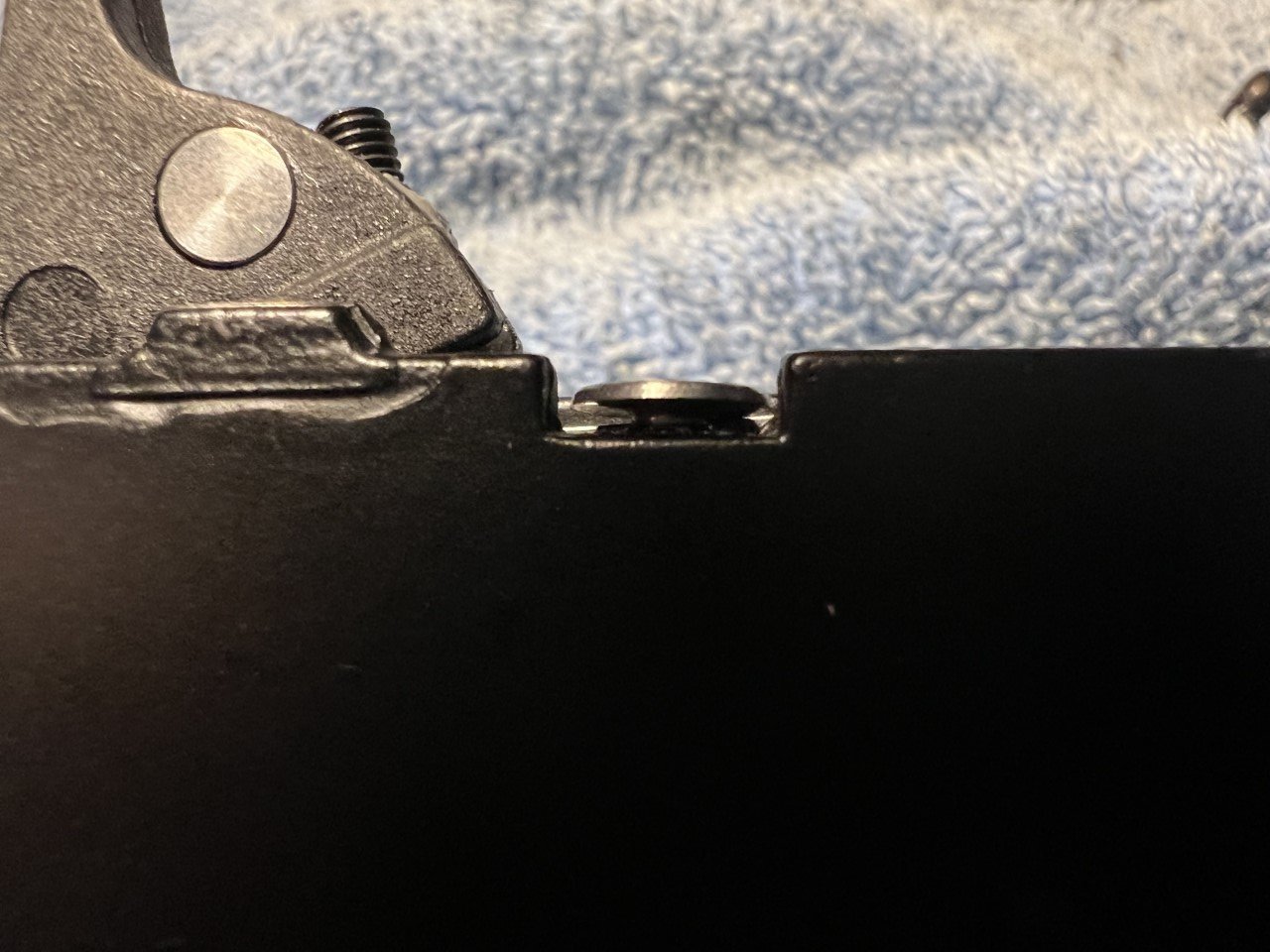

here are 2 pictures in both you will see and trigger adjustment screw it is a longer one and you will see the silver screw that is in the frame
silver screw needs to be made to be able to fit it the recess in the frame so a drill and a file is needed
it set the sear and the factory made the screw so it would depress the sear only so far and it is not enough
the trigger adjustment screw does 2 things
one it takes up the slop in the trigger and the other is push the sear far enough to fire the gun

View attachment 408574View attachment 408575

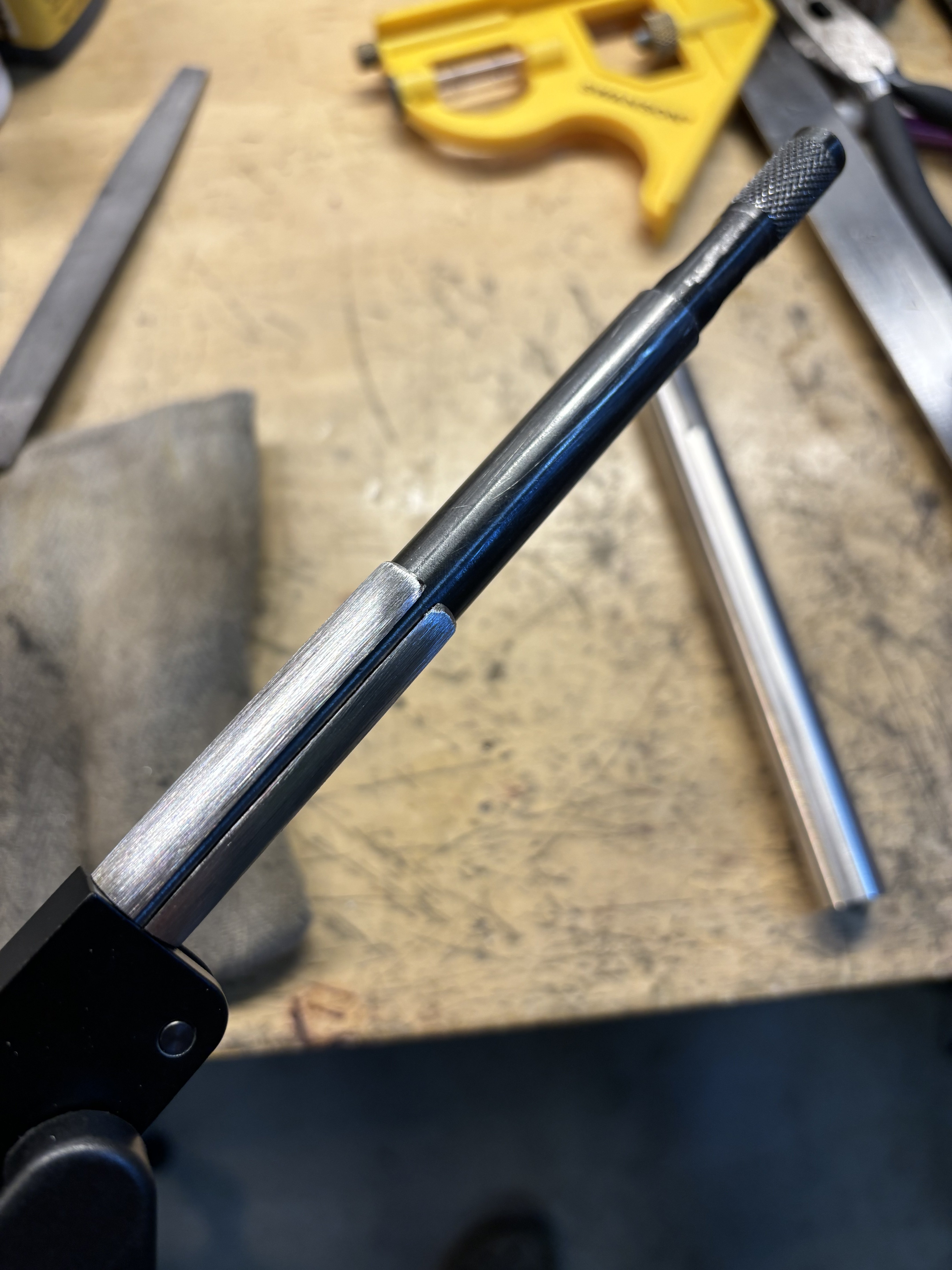

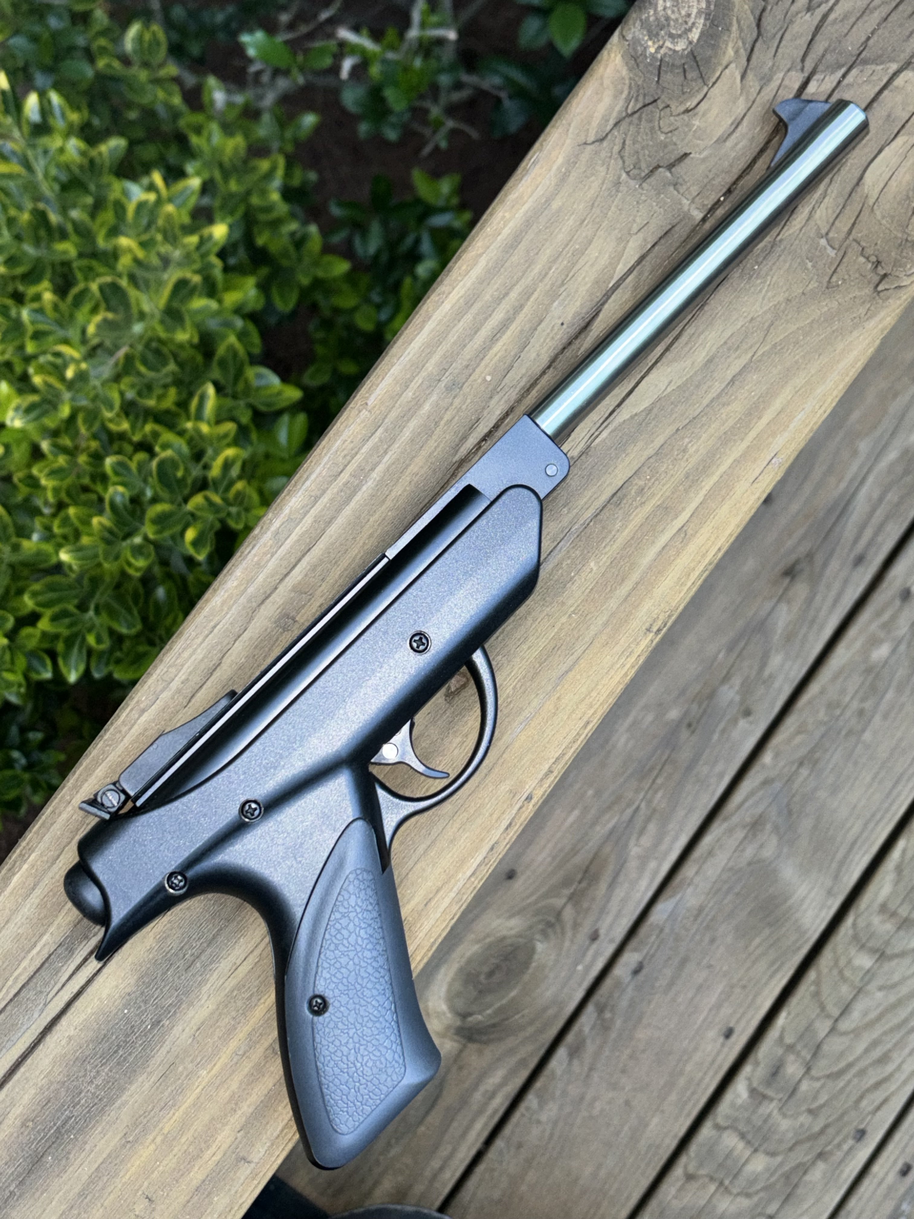

Congrats on the new pistol. I was lured by the cheap cost $59 and bought one of the off brands to see if it could be turned into a really good shooter. I’m a tinkerer and love the challenge and this was cheap enough to “play“ with. I’ve done one of the trigger screw mods but need to drill/tap and install the additional trigger screw next. Like others have stated the barrel was absolutely filthy. It took many patches to come clean. Also took it completely apart and gave it a good clean, deburr, polish and lube. I’ve also taken it a step further and made/added a 16mm o.d. SS barrel shroud ($12 Amazon) for added forward weight. I didn’t like how light the pistol is and how skinny that barrel is. I will also add some epoxy mixed with lead shot to the grip frame for some additional weight. It now feels and balances much better in my hand and the added weight in the frame will help even more. I really do like the overall look and feel of this little pistol and (cheap fun) and will enjoy working it to its accuracy potential.
Here’s some pic of the front sight and how it’s just press fit onto the barrel knurling. Note the barrel has two flats on it and appears to be threaded into the breech as evidenced by wrench marks made on the flats as it was twisted. I just pulled the front sight straight off trying not to twist it too much while doing so. Also shown is the barrel bushing I made to support the rear of the shroud. It’s made from a piece of the shroud with a slit cut in it and crimped to fit tight on the barrel and shroud i.d.
