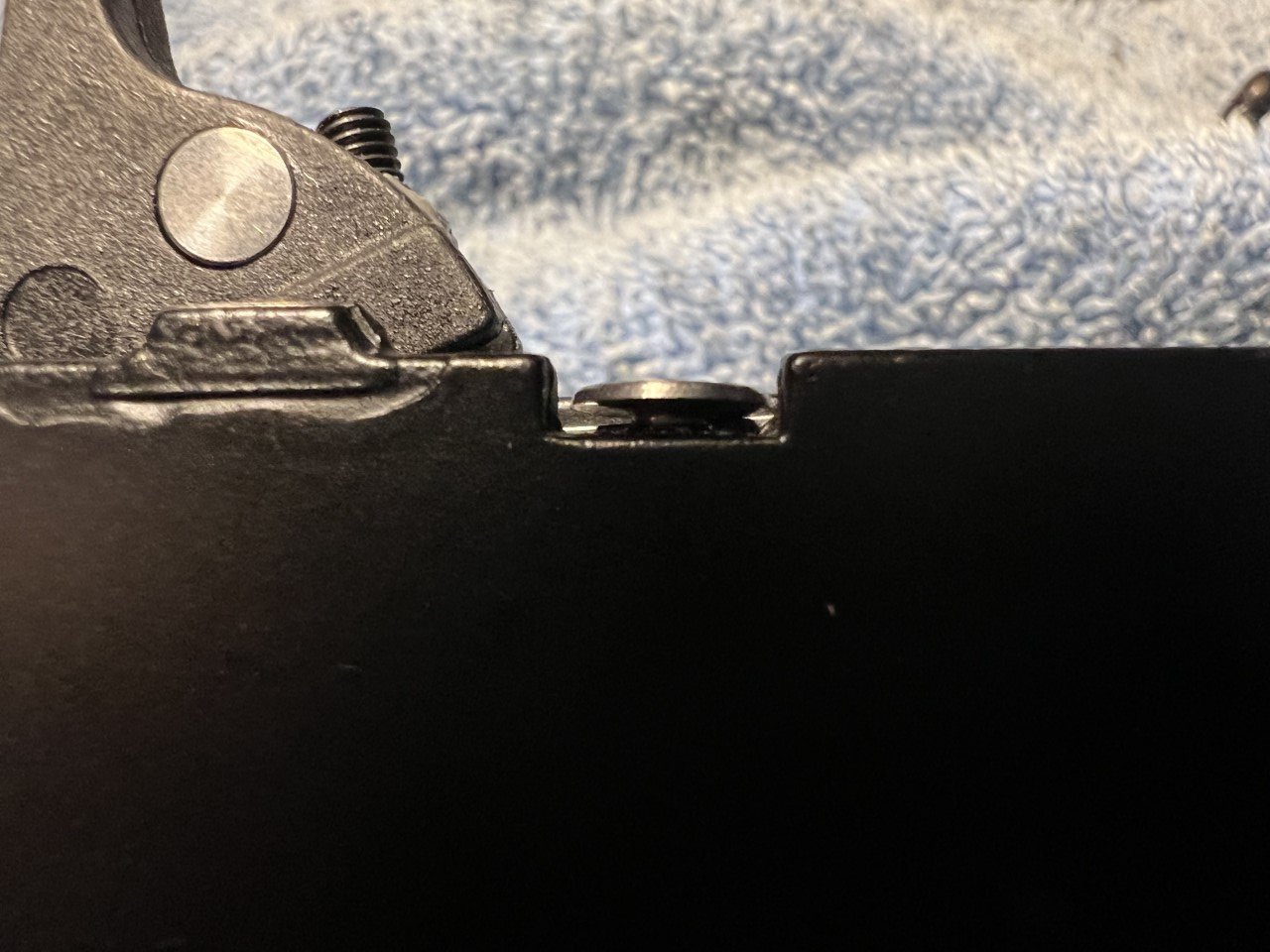

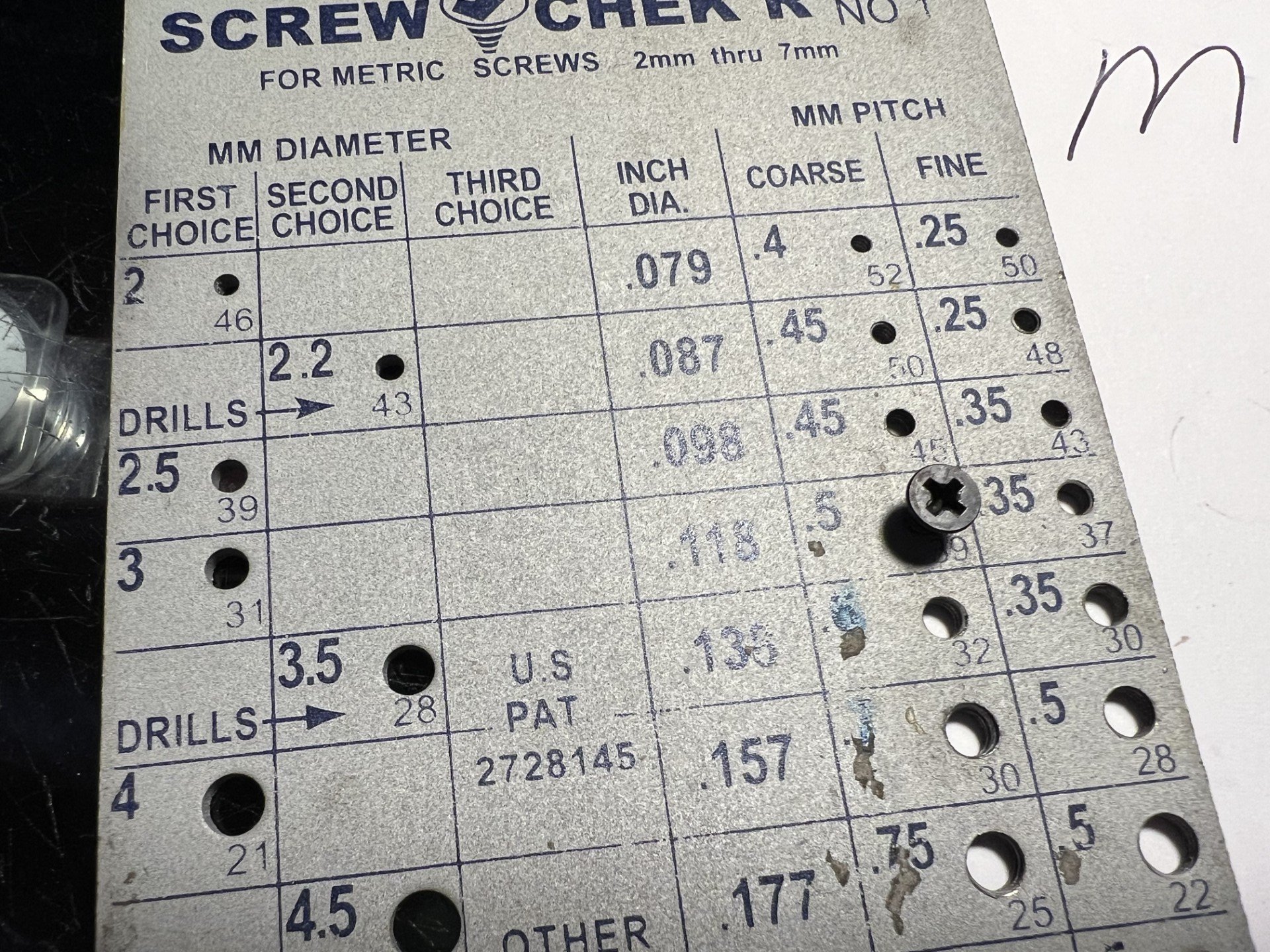

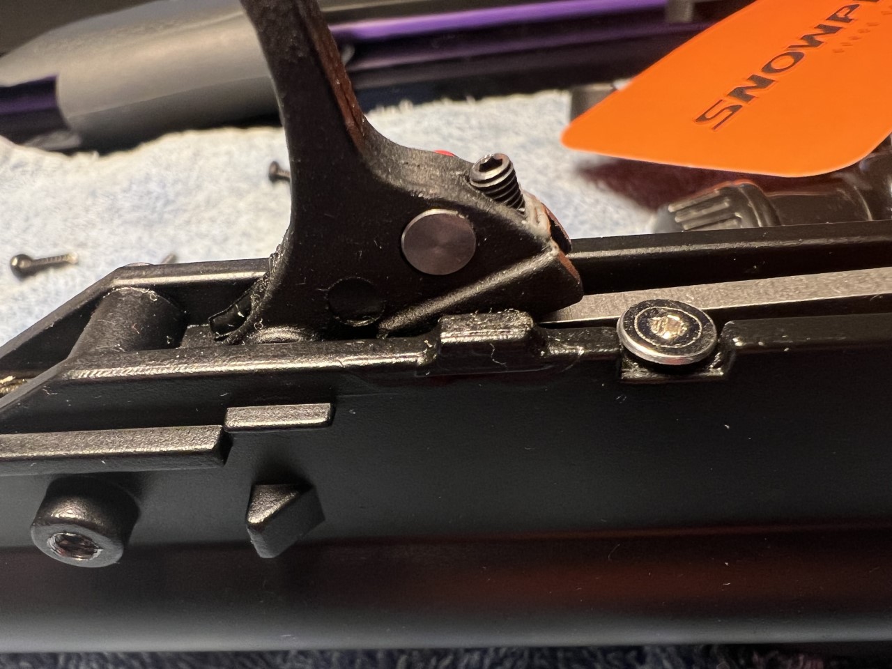

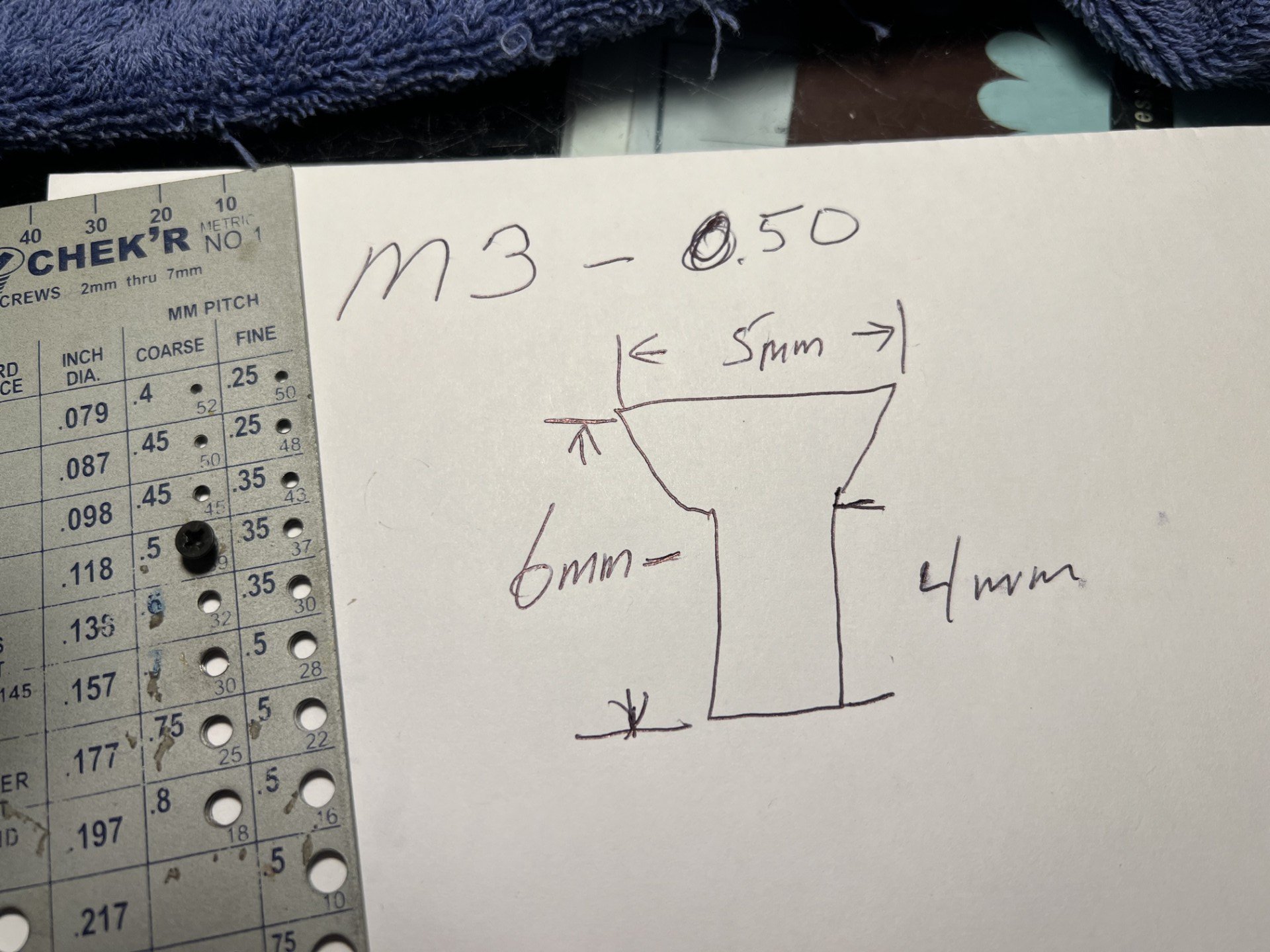

Hello again marflow 777, I took my sights off to make room for my red dot sight. I put the screws in a little bag and my wife threw them away on accident. would you happen to know the size of the two little screws? I still have the spring and the one screw for adjustable height. thanks for any info....
