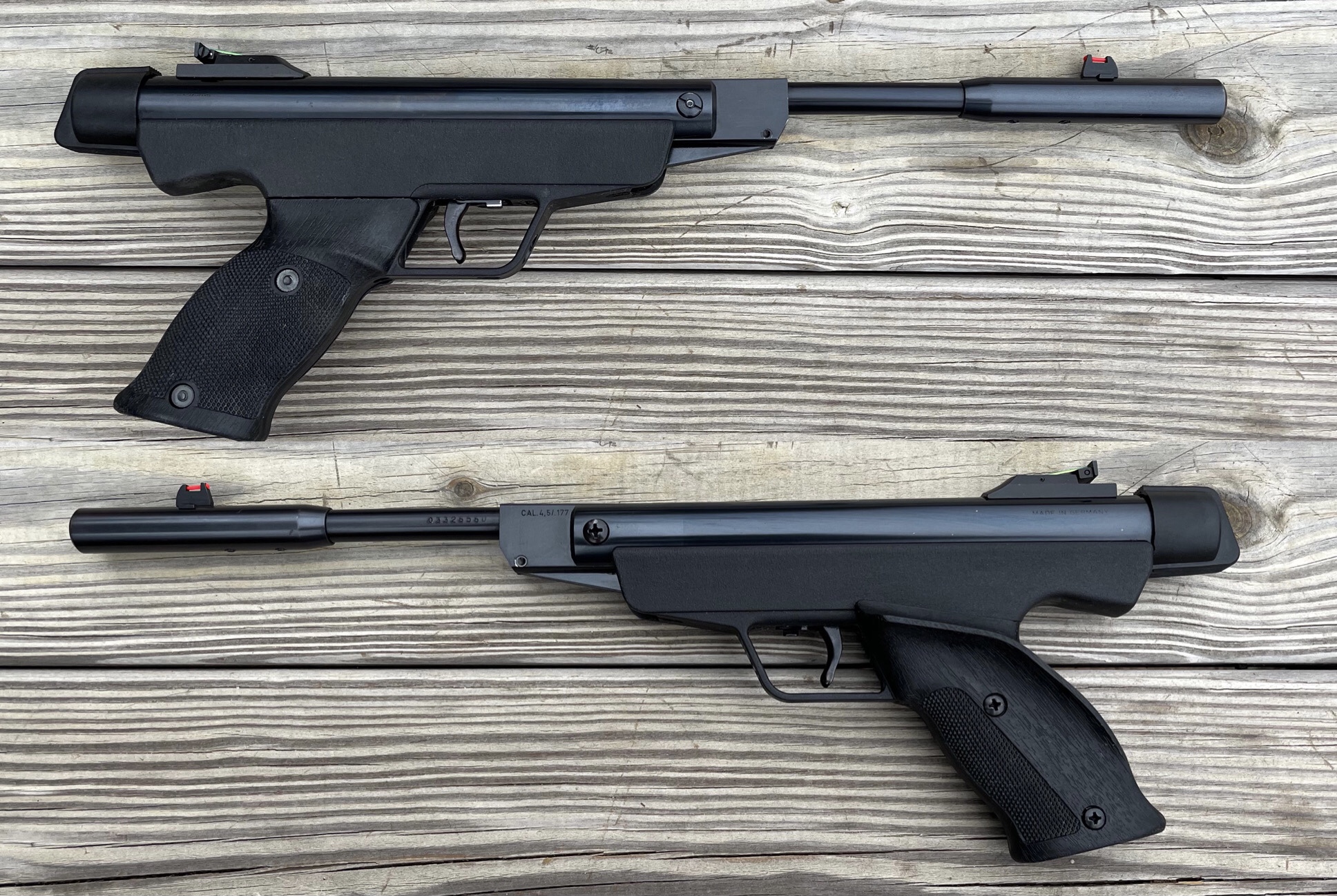

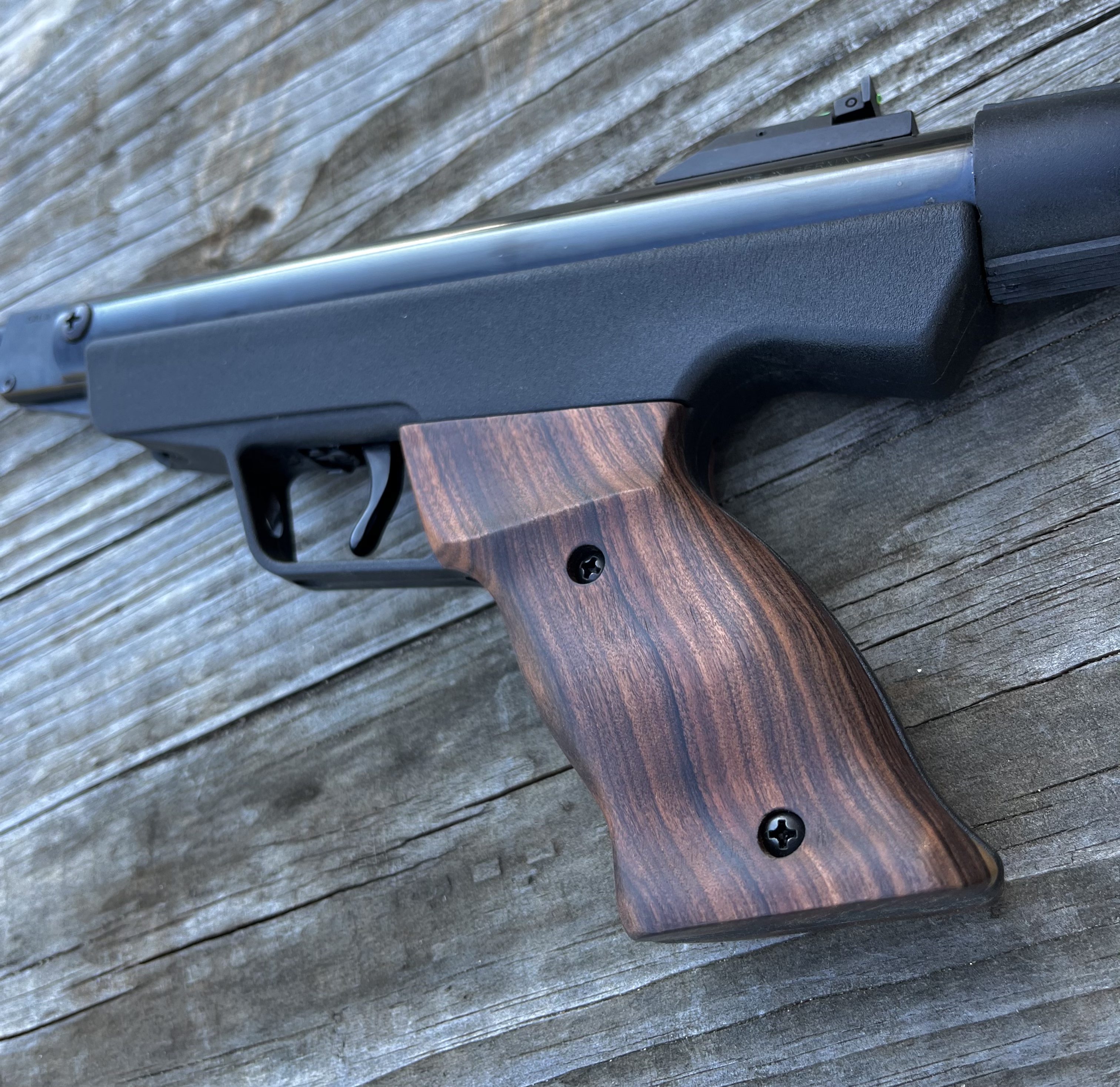

Just acquired this Diana P5 Magnum. I have had many Diana pistols over the decades. The German made ones are disappearing. Mostly China these days. Being a lefty I have always hated the plastic right hand grip panels Diana used on their pistols. I prefer an ambidextrous (wood) grip as I switch hands to cock and load then switch back to shoot. I had left hand, wood match grips decades ago and didn’t like them at all. Very uncomfortable when cocking and loading. So, I finally made wood grips. Bolivian Rosewood. Fits my extra large hands good. Looks better than plastic to. IMHO
before and after

there were factory grip like you show as an option and yours are very nice

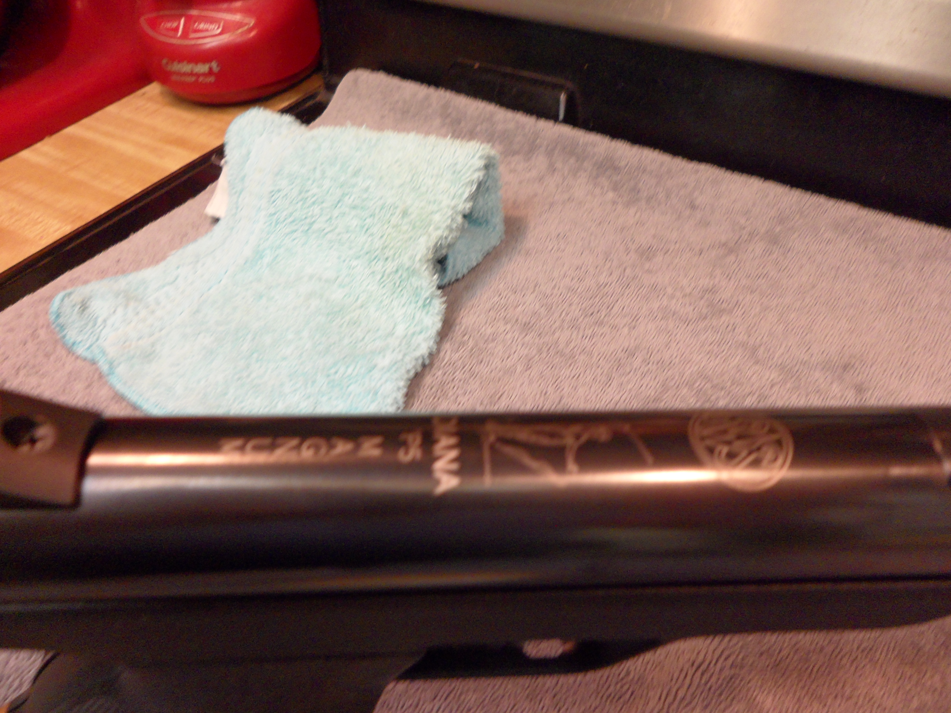

This one shoots very mild. Easy to cock. Fantastic trigger. Nice fiber optic sights. Haven’t done an accuracy test yet. Will update. Like the idea of an aluminum cap. Picture?

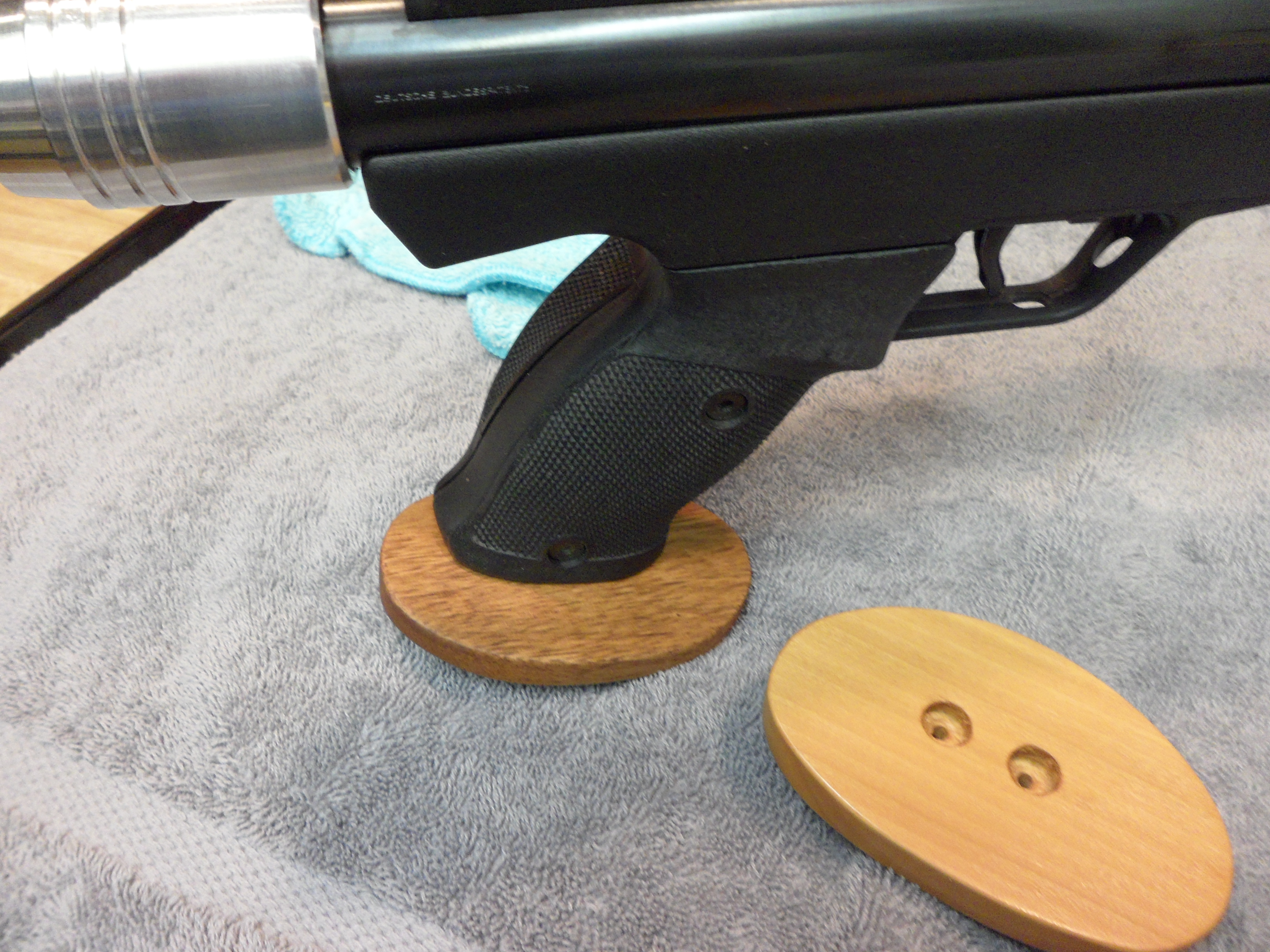

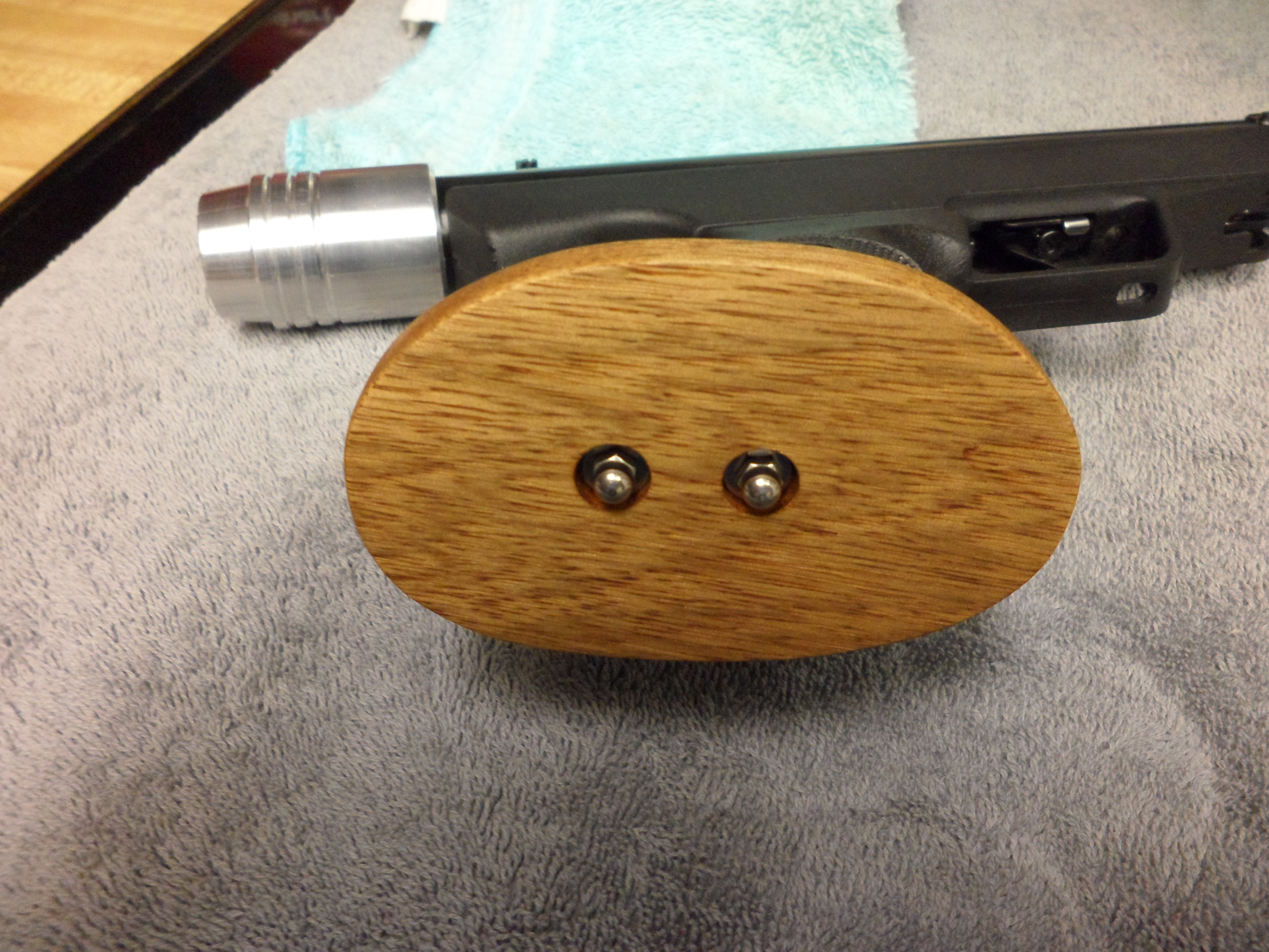

i have made some bottom shelves our of both wood and aluminum with screws epoxied in the right grip panel and nutted off with acorn nuts but even with them in place my 105mm hand just fits

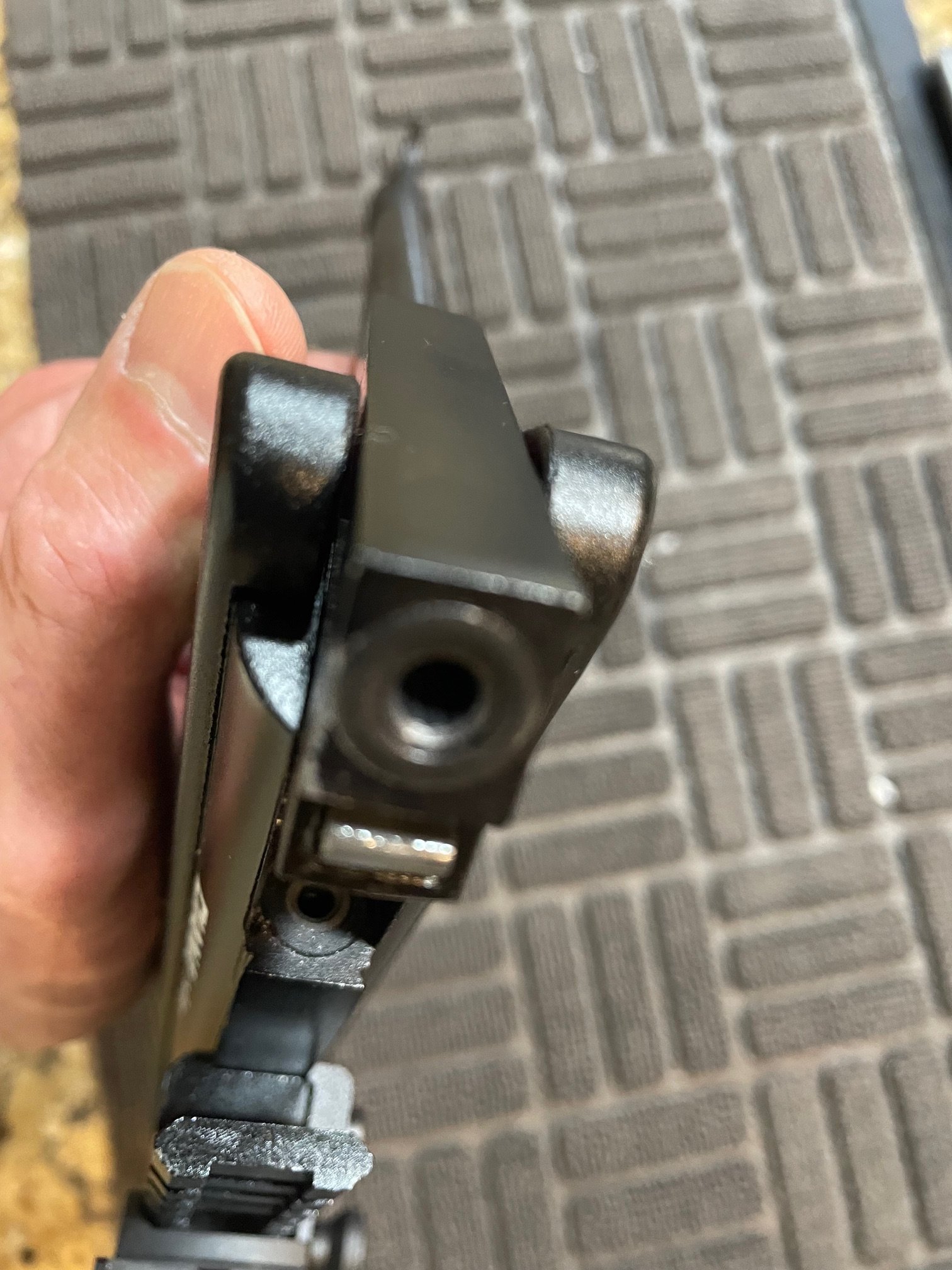

it is interesting when a post is made like here and you have the pistol and have not even looked at it for years
and get to shoot it and find it has a problem not so much in how it works but the barrel has been shimmed by someone with something i cannot remove
to much shim means the barrel is pointed down and that means you have to run the rear sight all the way up and run out of adjustment
i have been using 2.5mm x 7mm breech Orings and i thought i would install a new one at first only to find i was way worse the old one is 2.2mm and that is too much
the barrels have a spline on them and the pistol i am working on, no spline is visible
don't know what i am going to do at this point but the Dremel might be bought in to play
my point in all of this is, that how the barrel closes is very important and with the P-5 or 5G Mag your rear sight adjustment is very little and after trying to remove it and shim it the little screws will not move

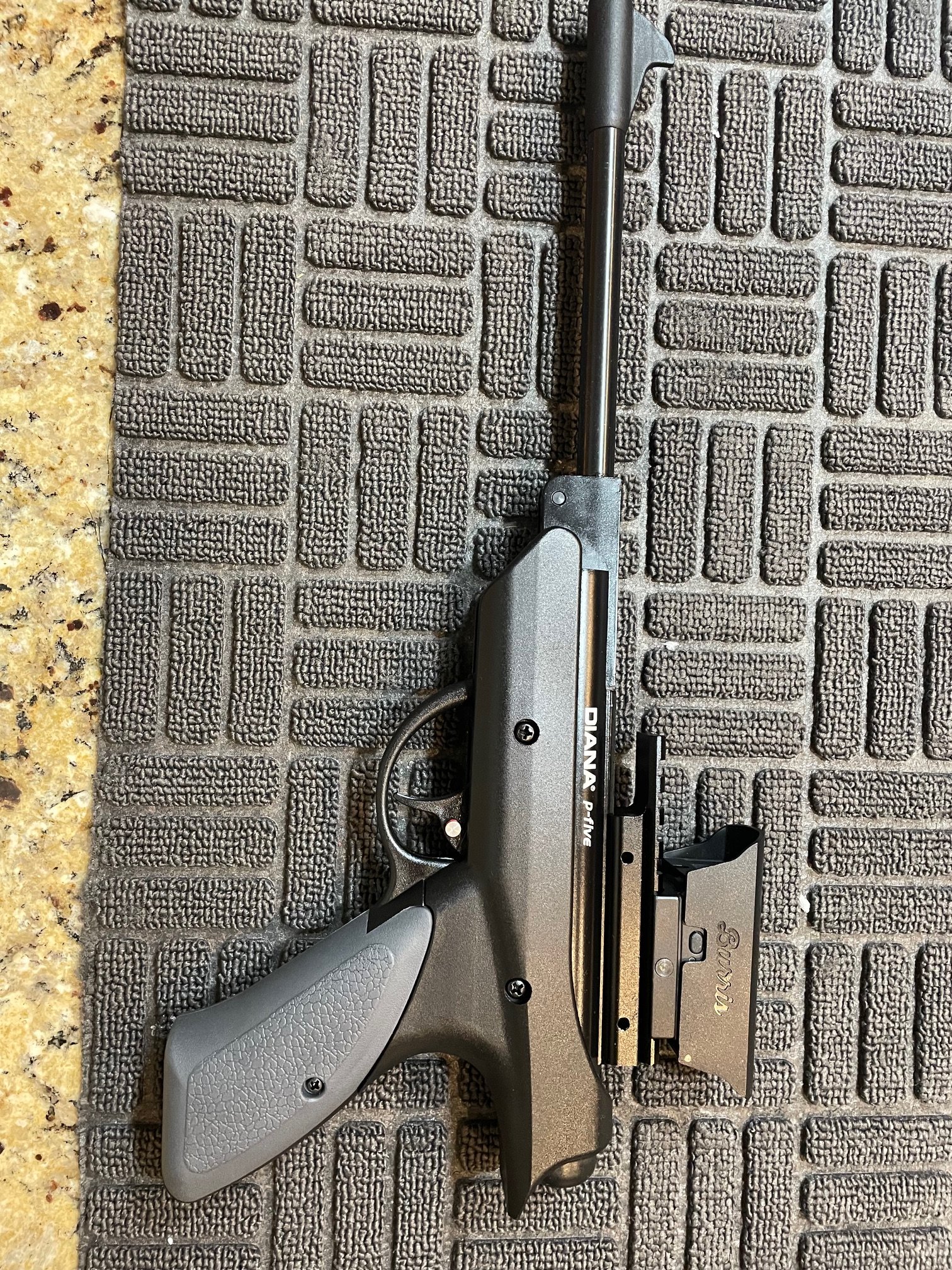

Didn't mean to hijack your thread BoG but since you asked, I did get it today and for $60 I am pleased with the pistol.
It is certainly no magnum at about 400 fps. The look and feel is much like my Diana Chaser, though the grip fits me much better. It took me a while to learn how it wants to be gripped (medium, not light) and the POI change between different grip holds is huge. The trigger pull has long creep but it is smooth, consistent and fairly light.
I first got the irons zeroed and needed the rear to go way over to the right. Then I removed them and mounted a 3 MOA red dot. At 10 yards over a bag it shot poorly with all my Crosman Premier pellets but did well with 7.0g Meisterkugelns, R10 Match, H&N Barracuda Match, and H&N Sport. It did very well with JSB Match S100 and JSP Match Middle Weight. It did outstanding with JSB Match Exact 8.44g.
All were a single 5 shot group and I didn't measure them because I was using a shoot n see target to just get a quick feel for the pellets it might like. Those targets make the holes look much larger individually but make the groups look like one hole even though regular target paper would not show them touching so the groups were surely larger than they appeared but still, I could see the pistol can shoot.
I like it. I wouldn't want to shoot a benchrest or 10 meter pistol match with it but it is a good pistol for general target shooting and plinking. Don't know that it would have the power for any pesting.
BTW Marflow 777, no fiber optics on this one.

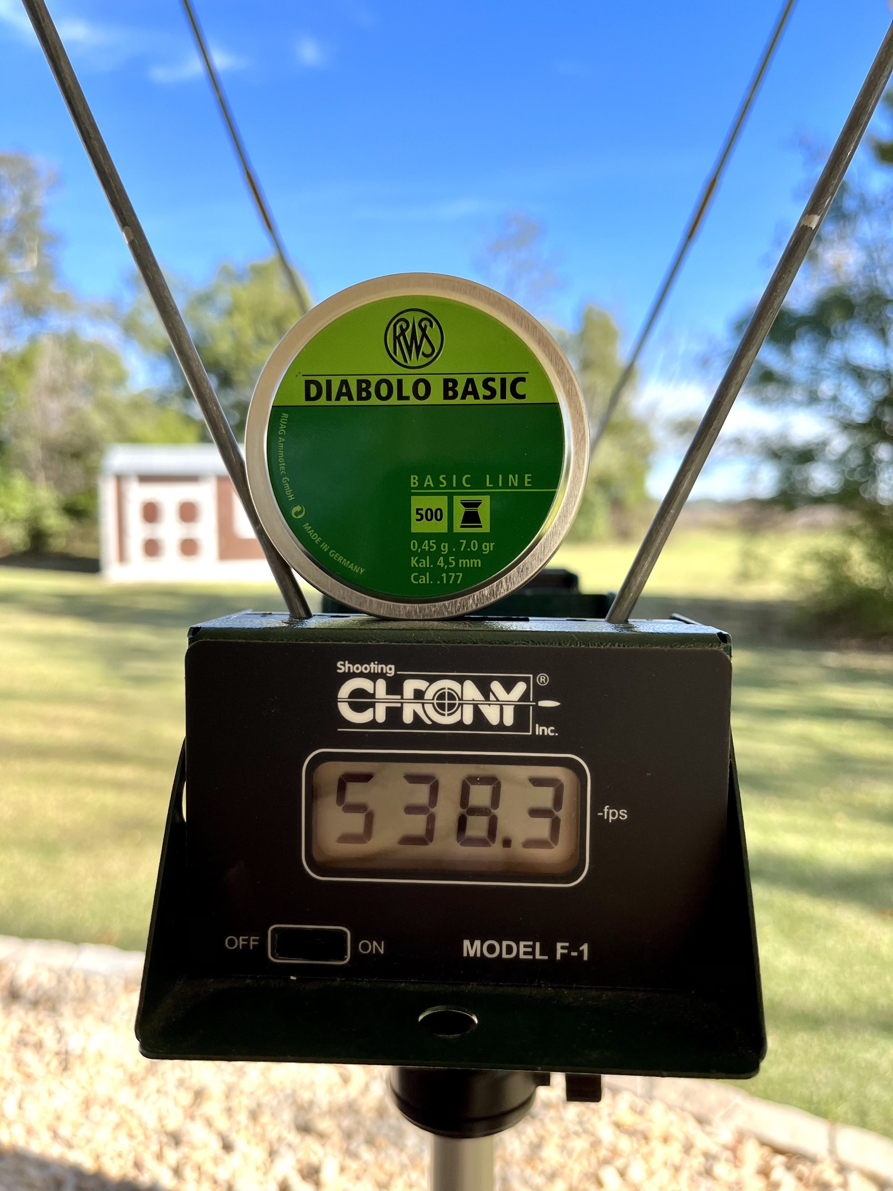

Nice looking pistol sjs. I still may get one for the use of a dot. At that price, you can go wrong. I did chronograph some different pellets yesterday. Didn’t do an accuracy test yet. Had to loctite the screws and set overnight. These 7.0 Hobby and Basic ran very good. The Basic I have found are like the Meisterkuglen and much cheaper. Used them in league shooting decades ago when they were called Geco. I did drop in a drop of chamber oil. Being a used gun, I want to establish a good new base line. Now getting over 600fps. Dieseling. Shoots good. Will do an accuracy test when it calms down. Keep us all updated on your P-five. I’m sure others would like to know.
