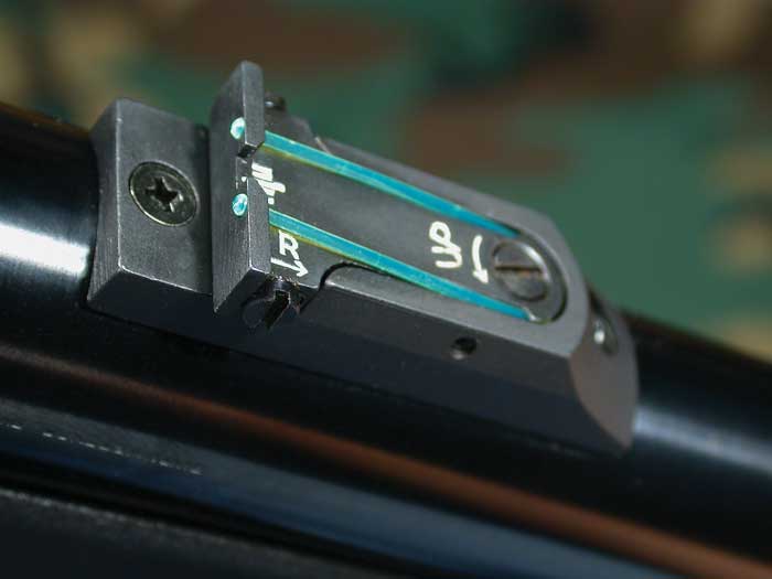

that spring is for the model 5 and 6 but not the P5 so my mistake
how did you lose that spring
i have 2 P5's but you have take a little bitty pin out to get to that spring on mine and that part is not listed
it sits in a pocket and i would have to know the pocket diameter
i would guess either 4mm or 3mm wire diameter would be in the .5-.5mm range length in the 8-10mm range

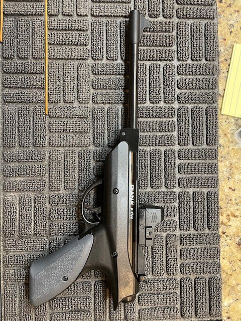

No problem, I still have the Chambers website as a possible parts source for the future, and I emailed Diana asking how I could buy one from them. I had removed the rear sight assembly and mounted a red dot. I decided to try the iron sights again and remounted the rear sight assembly. I was outside in the grass trying to zero it while shooting offhand, and I raised the elevation screw a touch too much and the spring popped out. It could not have gone far but I have not been able to find it. So, for now, the red dot is back on the rail.

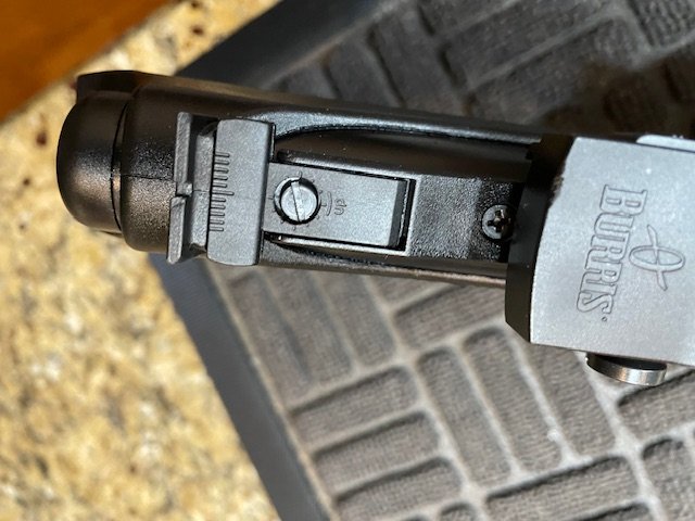

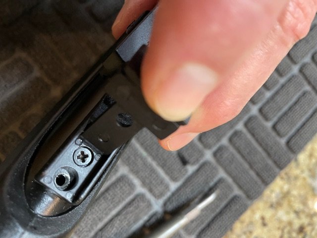

can you show me the sight and pistol
with the pin in place this sight doesn't not come apart i took the adjustment screw out of mine today and with the screw out the spring is trapped by the pin now if it has a model 5g-6g style sight that has been put on the pistol then the info i gave you is correct and a replacement can found at Amazon
i have tried to remove those style sight but the screw are soft and could be spun on the backside
