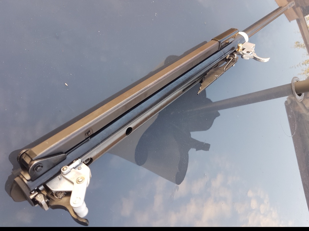

you can tie the cocking lever in the open position for travel .Do not think it would be a pellet that’s stuck I was able to fire it once and saw where it hit the target. Unless a pellet has been stuck down in guide somewhere and was never realized by previous owner. Tried some lube on the trigger but being cocked makes me hesitant to try dissembling anything and going much further. Will definitely call the repair guy in CT tomorrow. Thanks for that contact didn’t know I had an expert in driving distance

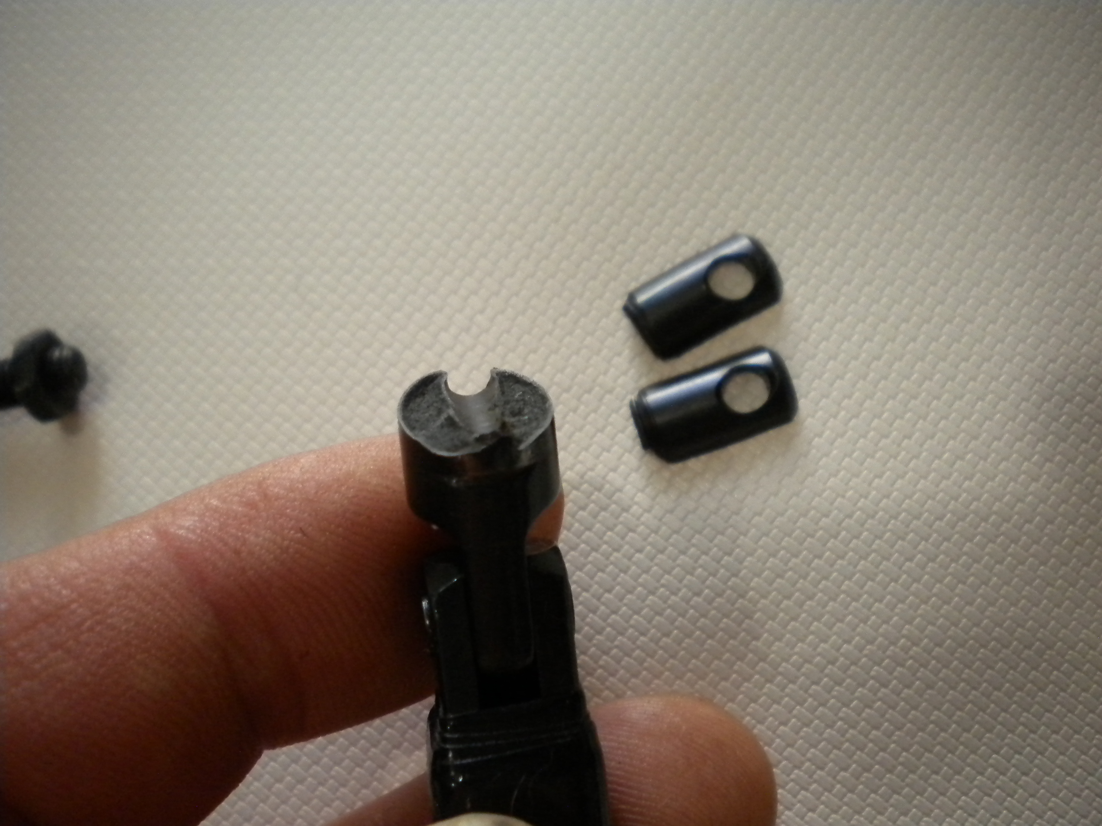

Yes, that's exactly how it was.The impact was very strong, the piston could split. The rifle was sold as is.I'm back from the World's.

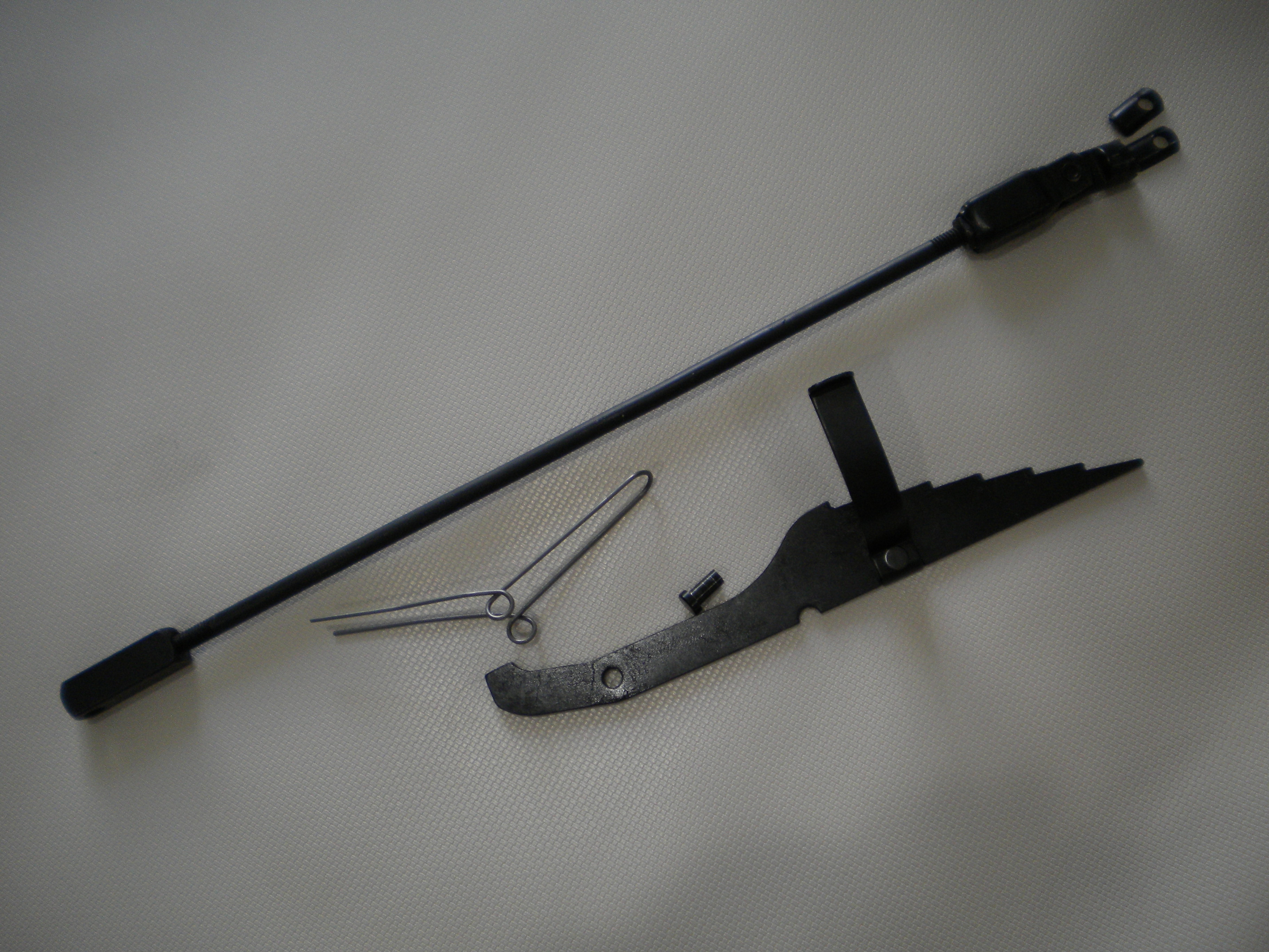

The pictures paint a clear picture, the fracture of the cocking lever linkage knuckle is an impact fracture, not a fatigue one.
This tells me that there was a strong "mishap", perhaps even a detonation (far more violent than a "dieseling").
And, yes, recently applied WD40 COULD have caused this.

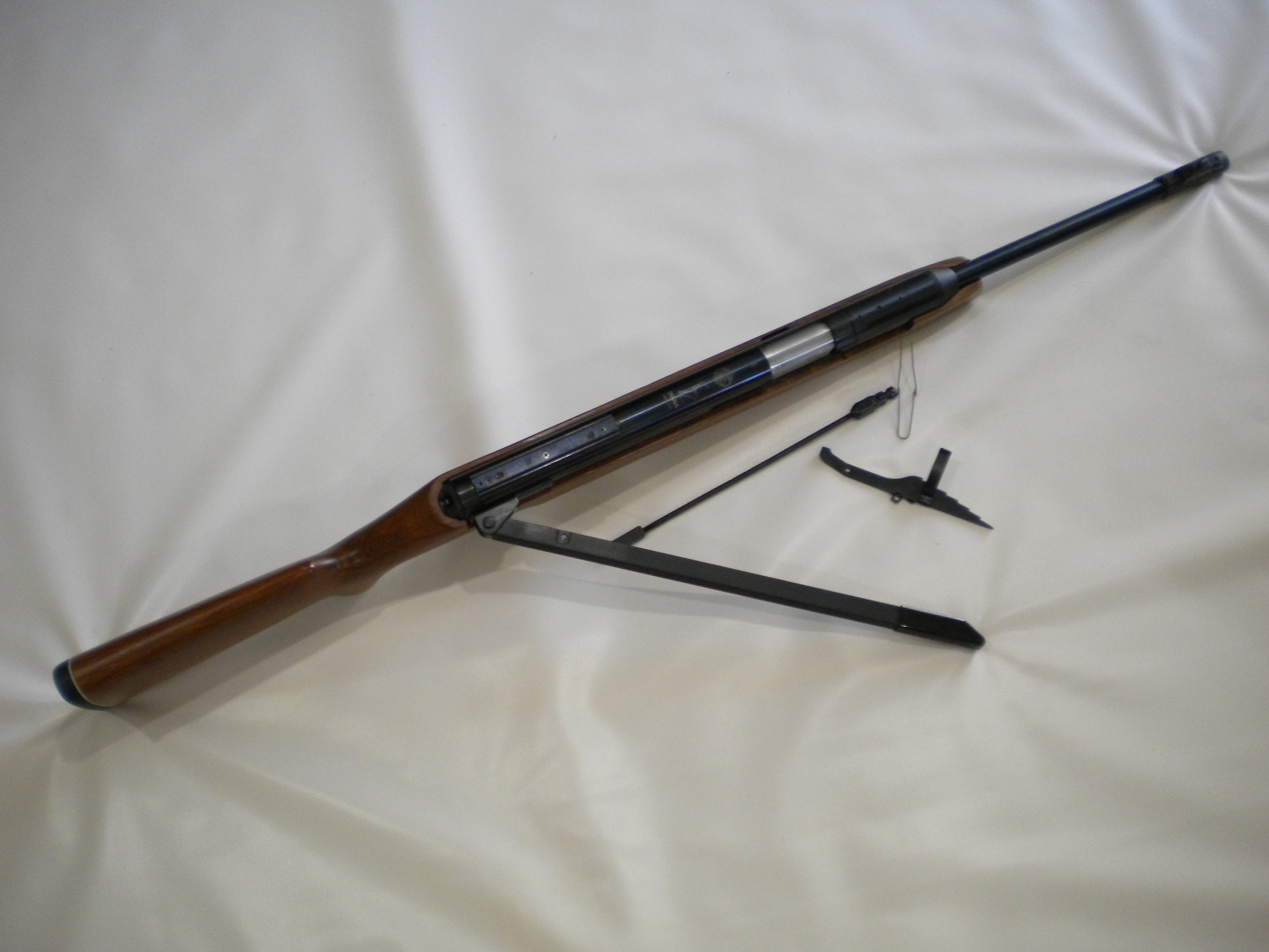

All the parts in the picture are available, the cost of repair would be:
Parts .- $45.00
Parts Payment and shipping from Europe.- $40
Labor.- $202.50
Return shipping and insurance.- About $50
Let me know what you want to do.
