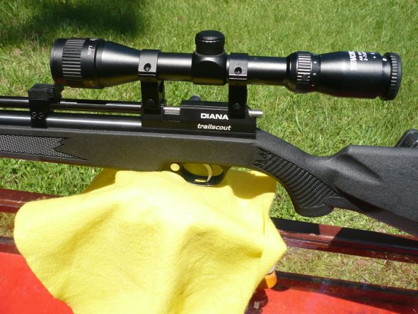

The .22 caliber version is a clone atheistically speaking of the .177 caliber with the exception of caliber, synthetic stock etc. I won’t go into detail on description as all this was covered previously in the .177 caliber post I made on this site. What I am interested in is the performance of the .22 caliber.

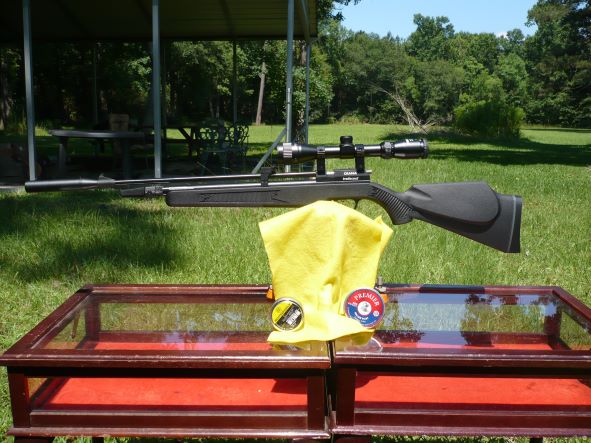

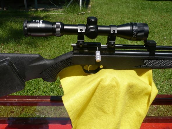

I could see no other problems so inserted the 3- 12 gm C02 carts as per instructions with the cartridge adaptor and charged the rifle with no problems. I installed a Winchester 2x7x32 AO scope and will use the first charge to adjust and sight in the Rifle and check out other aspects, magazine function, trigger adjustment etc; and did then did a full shot count test with the second charge. This might be a good place to point out as I mentioned previously with the .177 caliber, that there is no anti- double feed device with this magazine fed rifle, so due diligence is required to avoid a double charge!!
I adjusted the trigger and set@ 1.75 lbs. Using Crosman PMHP 14.3 grains first shot across Chronographed registered 565 FPS/ 10.1 ft. lb. this met the advertised spec. of 560 fps. I then tried some 14 grain RWS MATCH which delivered 568 FPS/10.0 ft. lb. again meeting advertised velocity spec. These are the two pellets I used for accuracy testing. I used the loaded magazines for accuracy testing! All testing conducted from bench @ 25 yds. The Crosman PMHP delivered 1.185 inch 5 shot center to center groups consistently and fairly concentric the RWS Match delivered .625 inch 5 shot center to cemter groups very concentric. In essence the Crosman PMHP can deliver consistent 1 inch center to center groups and the RWS Match consistent 5/8 inch center to center groups at 25 yards.

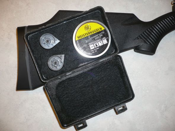

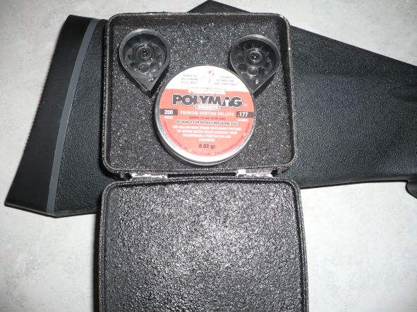

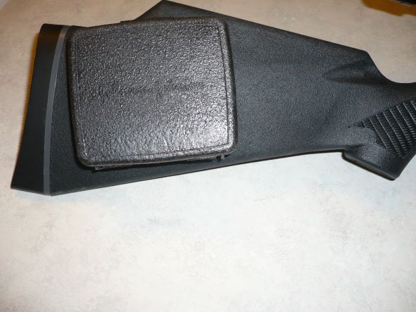

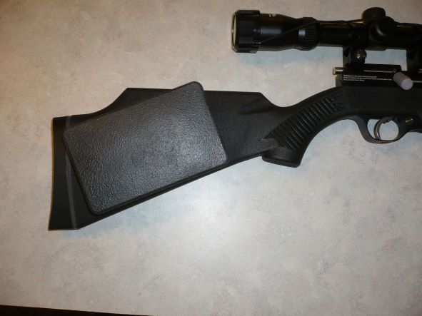

On a side note ; I permanently attached a small storage box on the stock of each.177 &.22 unit unit, to store the mags and one can of pellets, this allowed me to always have mags, and pellets readily available at all times , also helped keep me from misplacing the mags!! I can load up 3 mags and head out and have a full day of shooting and not need anything!! I will enclose a photo, some may consider the boxes distracting, but I will go for function over form in most cases anyhow!! Not a recommendation for anyone else just works for me!!!!
