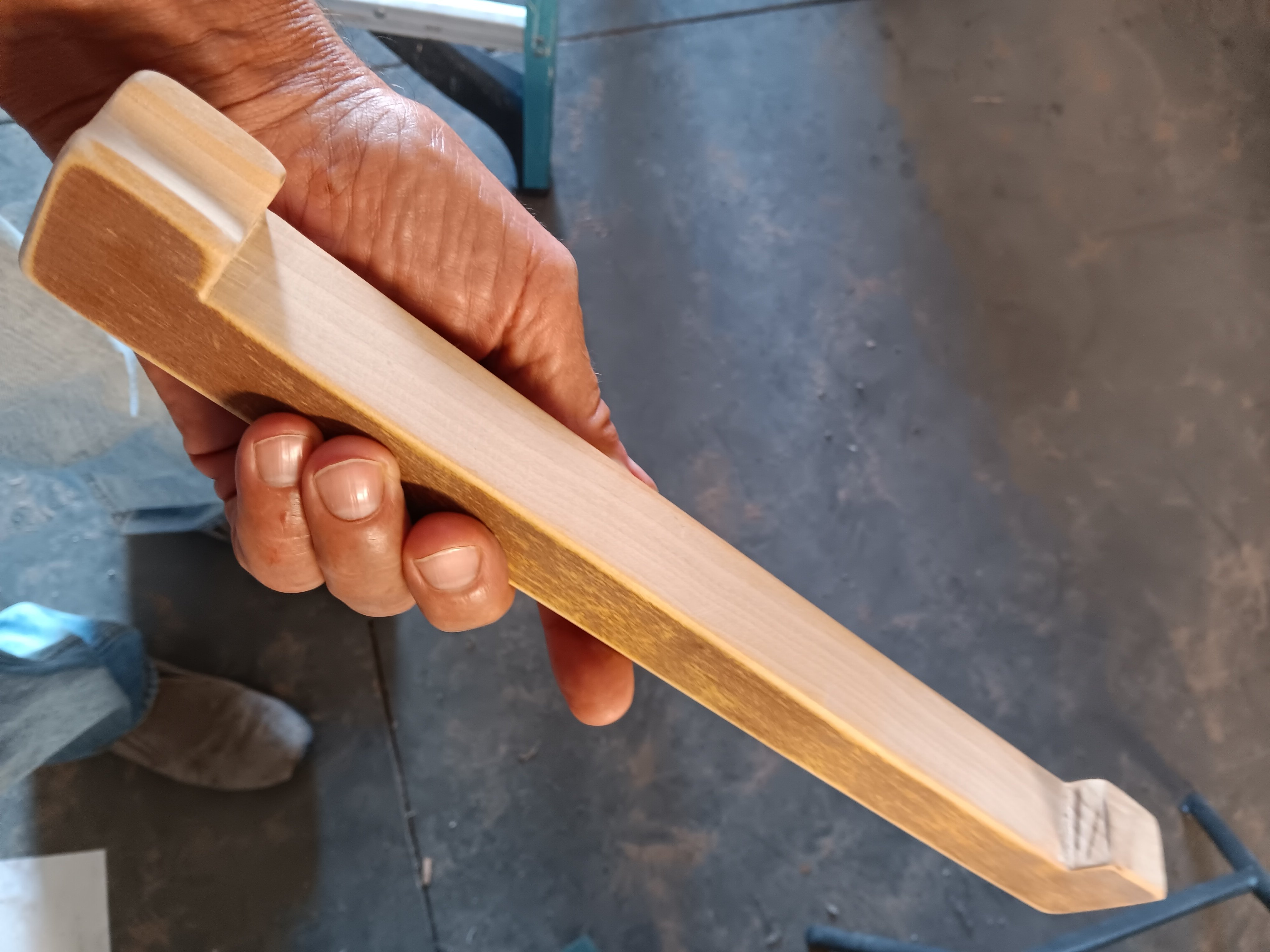

Breech wide open but can't close unless you remove the wood clock block .😉
A fitted block of wood that fit between the tube and breech block when opened (90°). To just chock and prevent that happening would work good ..
That is exactly how I do it on the springer. I use a much thinner wedge but the same idea.
For the 97 I've got a 1" round piece of hardwood about 1.5" long with a taper at one end. You stuff it in there one way to clean it. Turn it around the other way to replace the breech seal. I stuff it under the cocking lever to keep the pressure off the breech seal in storage.
It's a far out and groovy airgun accessory I made from a tornillo mesquite limb. But a piece of 3/4" schedule 40 pvc would work dandy too.

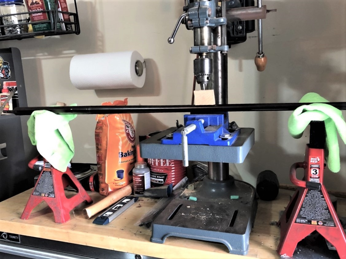

Barrel is definitely bent. Shooting over 14 inches high at 25 yards, Tried to switch the droop compensation mount backwards but the impact point went too low to adjust up with the scope. Have to bend the barrel down or see if a zero droop mount will work. However, the action opens when you bend it down, How do you hold it to bend it???? If I use a padded vise, afraid I might clamp to hard. Good new is it still shows hard. Got 850 fps with 14.6 grain pellets. No apparent damage on stock and action but will look at it when I take off the stock to bend the barrel.

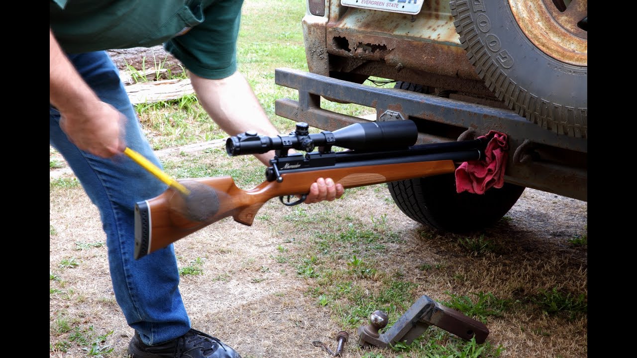

The old trap shooters with a plain barrel gun would just go looking for a tree with a healthy crotch low enough to the ground. Insert barrel in to the crotch and push or pull to bend the barrel. Most trap shooters prefer their pattern be 70-100 percent high.
Yaaaa buddy . I bent one or two barrels using a tree .. but that was in anger and disgust of the guns performance 🤤

So you put the pressure in the middle of the barrel with it supported on both ends rather than clamp the receiver side and bend the top of the barrel.
I put a fulcrum poit at the pivot block. And put the jig on the other side.
Search for "barrel bending" and you'll get details. I've posted my trials and tribulations as well as several others. I'd link to my post but im not sure how. Use the search function.
That all depends are where it is bent? Without having your rifle in my possession or you supplying detailed pictures then it is going to be hard to help you?
My guess your barrel is bent at the block? Here is a link to help you when a barrel is slammed shut........
