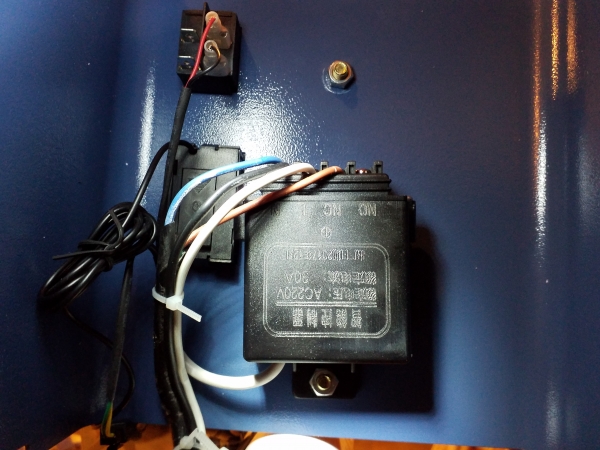

Got my Yong Heng compressor last weekend . Offered $240.00 for 220v with adjustable pressure shut off. Figured I would run it on existing 220v line I already have @ home. When I opened the package there is only a standart 110v (type A) 2 prong plug. Unit clearly labled 220v inside case & on outside. Did some looking online and discovered europe and China have 220v residential source on a single wire. Already stepped up to 220v. Has anyone else purchased this type of compressor, and what did you do? Is anyone willing to post a few pics of the wiring & labels inside their 110v.unit so I could compare? Don't want to burn electronics or motor by just plugging it in. Thanks in advance.
Hawkeye51, I got the same compressor and cut the plug went to home depot got a 220 male plug and wired it on the end of the compressor, I also made a 10ft extension cord out of a old heavy #10 stranded electric cord. Been using it for a few months now and works great. I also bought a tile saw water pump to replace the one that came with it as it worked intermittently.(home depot royobe). I put a 7lb bag of ice and enough water to cover the pump and it keeps it cool for 34-40 minutes to top off my cf tank 106cf.

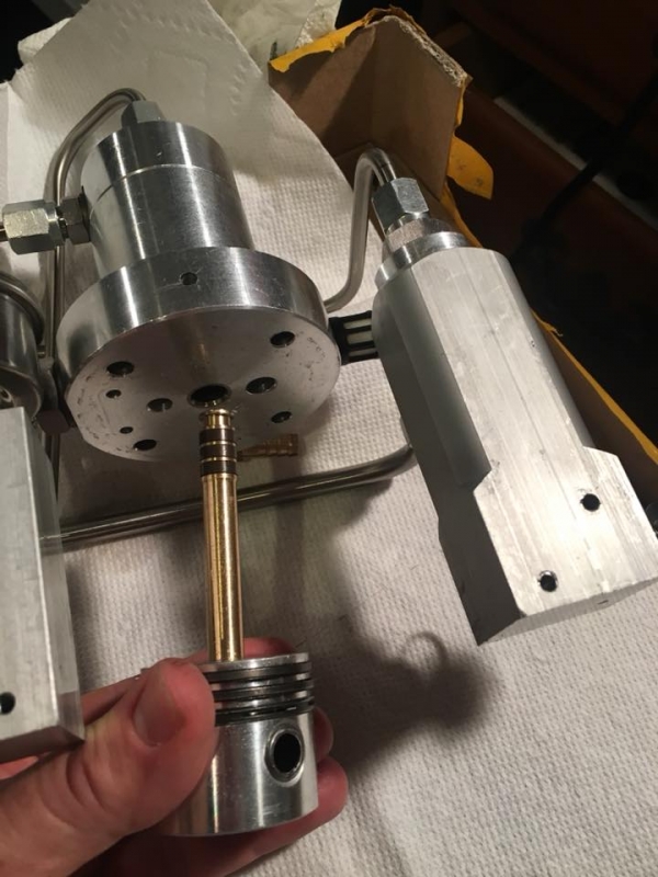

The piston rod on my Yong Heng seized. There is a dipper on the rod that mysteriously broke, thus depriving the crankpin of oil. I ordered a new piston assembly from Ali Express for only $20 BUT...... The new assembly second stage piston did not fit in the Yong Heng. The new part had 4 plastic rings, and the original had three. They looked identical in diameter, but in fact the new second stage piston was a few thousands too large. "Okaaaaaay....." sez me. "We're not done yet." I took apart the new assembly and moved the new rod to my old original piston set to replace the original rod that seized. This time the reassembly went smoothly. But after about a 3 minute run under no load to wear in the new rod I got a catastrophic failure. The failure point was where the first stage and second stage pistons are connected. I tried hard, but I'm done with Yong Heng. Even if yours runs great for a while, it will need a rebuild. I could not find a reliable source of correct parts. Without that, you're screwed at some point down the road.
