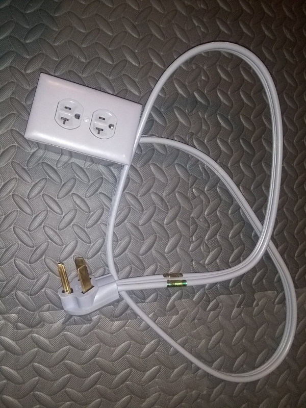

I purchased the 220v version and it cam with a standard north american 110v plug. instead of cutting up the power cable i simple went to lowes and bought a dryer power cord, a single pvc electrical box and a 3 prong outlet. I was able to screw the ring terminals of the dryer cord directly to the 3 prong outlet. Now i have an adapter cable just for the Yong Heng.

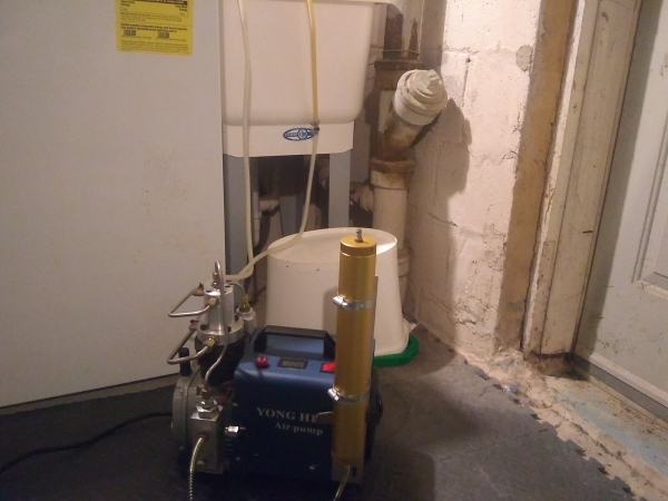

I use the deep sink faucet to push the cooling water through the compressor so no pump needed with the advantage of a constant cool flow of water. Temps seem to hover in the upper 40 degree C range.
