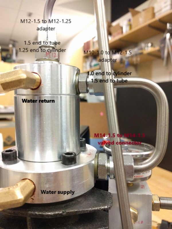

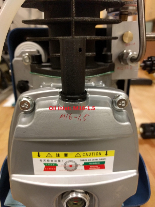

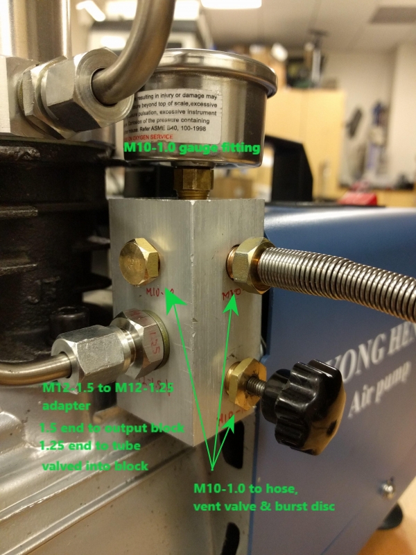

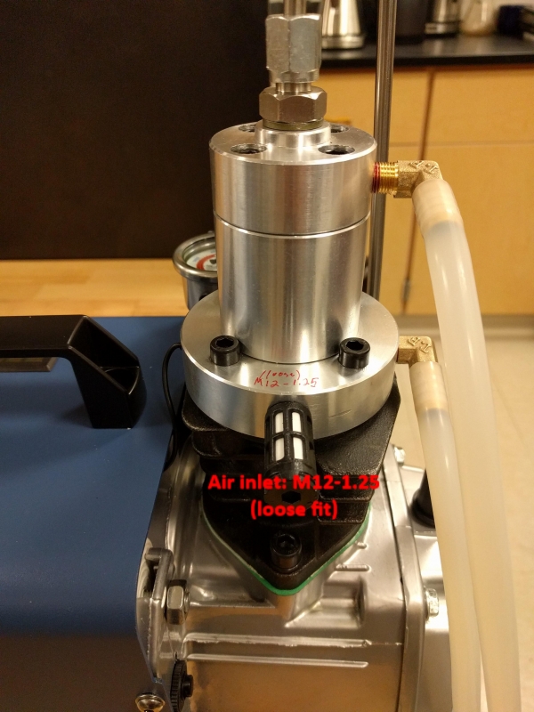

I have started gathering basic info about the YH compressors - thought you (@kayakairgun) might find the fittings sizes helpful, so while I will request a new thread once the info is more organized, here are some pics with fittings sizes labeled for you. I matched the fittings by actually checking them against a thread and pitch gauge like this one: https://www.amazon.com/dp/B003FJW0GK/ref=cm_sw_r_tw_dp_U_x_3uNxAb63T009N
So in the meantime, here you go.

The threaded hole on the gold filter is M10-1.0 (on both ends), the threaded hole in the smaller black air filter is also M10-1.0. At least, that's the case for both of mine (as well as for some even smaller anodized aluminum filters that came with my hand pump. 1/8"BSPP is 28tpi, not M10-1.0, which has a pitch of 1.0mm. It's a bit nuts, but I've found English standard (ie, npt), metric standard and BSPP fittings on my Yong Heng compressor.
"prfssrlee"The threaded hole on the gold filter is M10-1.0 (on both ends), the threaded hole in the smaller black air filter is also M10-1.0. At least, that's the case for both of mine (as well as for some even smaller anodized aluminum filters that came with my hand pump. 1/8"BSPP is 28tpi, not M10-1.0, which has a pitch of 1.0mm. It's a bit nuts, but I've found English standard (ie, npt), metric standard and BSPP fittings on my Yong Heng compressor.
prfssrlee I actually got my Tuxing filter today and it is not compatible with the Joe B. foster fittings. I will keep the inlet male foster on the Tuxing to hook-up the first stage filter but have ordered the proper male metric to 1/8' bspp fitting and an Air Venturi male foster with female threads so I can use my Joe B. fill hose instead of theirs. I hope this works. By the way I ordered my Yong Heng a few days ago and got a message that it is preparing to ship. I hope this is a faster process. Bill
Interesting. I know each end tapped on the gold filter is M10*1, but 1/8” NPT fits just fine. I used a 1/8” npt male foster before I knew the correct size. It’s been on there for many months. The other end has the M10*1 male foster, and that screws in further that the 1/8” npt, but both screw in far enough to be safe and leak free.
@Centercut- Yes, 1/8"npt is 27tpi, which is almost 1.0metric (which would technically be 25.4tpi) so it does screw in a good ways and can seal. The bigger difference is that the sealing on npt threads is done with the threads (which is why they are tapered and why you probably used teflon tape), but the M10-1.0 thread is mainly intended to be face-sealed with that little white teflon gasket inside (which is why the threads are parallel). At least, that's how I understand it.
I bet your 1/8"npt is stainless steel and the hole is aluminum, so you are engaging enough of the threads and deforming the aluminum so don't have an issue. My guess is you wouldn't want to do the reverse - ie, thread an aluminum npt male into a stainless metric female - because then you'd be deforming the male threads and have the possibility of thread failure.
Yes, I do think you’re correct. The male foster that came with the filter screws in almost all the way but I think it’s still a thread seal and I used Teflon tape on that one also. It is maybe one thread from making contact with the end cap. The other side with the npt thread is about 3 threads from being all the way in but still has about 4 threads engagement and I also used Teflon tape.

I agree with Centercut and prfssrlee. All three 1/8 bspp 1/8 npt and 10x1 mm are very similar and some will fit one way but not the other. The 1/8npt male will screw into 1/8 bspp female until it binds on the taper but 1/8 bspp will not screw into 1/8 npt female at all and then you have bspt which I don't think is compatible with anything. That is why I just cut the thread that I need over whatever I have but only once and I only cut parallel over taper, never the other way round. I wish that everybody could agree on one standard but that is never gunna happen. prfssrlee is right about using Teflon tape on the tapers and washers, O-rings or molded washers on the parallel ones with a mixture of both when marrying two different types. As for the different QD fittings, even if they seem compatible, they sometimes damage the O-rings and let go towards the end of the fill. That is why I use a non-return fitting on the bottle side so I don't lose the whole fill if one goes when I'm not nearby. That really makes my brown eye blue. Hey Bill, try this. I ordered a couple myself.​https://www.ebay.com.au/itm/292235740409
