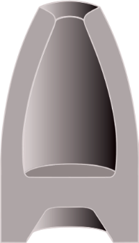

Hybrids and Ratsnipers are a different design that requires an extra die and step to produce because most of the projectile is hollow. This allows greater expansion at low velocities. NSA slugs have a narrow hollowpoint that still expands well without fragmenting like the more fragile hollow slugs. More velocity = more expansion for NSA.

Hybrids/Ratsipers should be called hollow slugs because the give greater expansion at typical pellet power levels and cost around 2 to 3X more per shot due to the extra steps in manufacturing.
 Hollow slug like the hybrid.

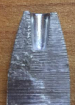

Hollow point like NSA.
