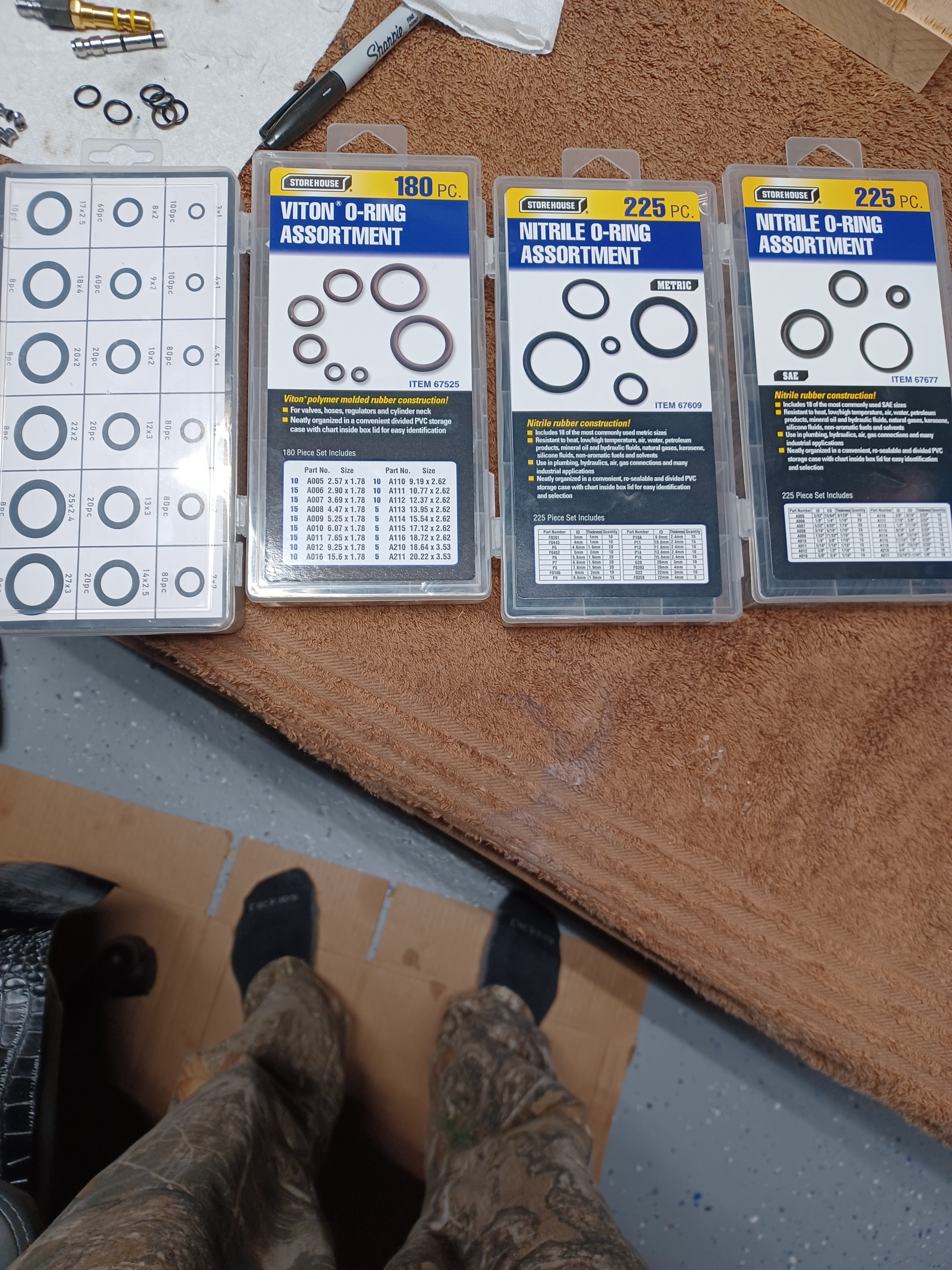

Also I've never removed barrel bands nor removed perfectly working silencers unless theres issues. If you enjoy shooting these , purchase some oring kit from harbor freight and amazon, there inexpensive and you can take on any future repairs.
Yes I can confirm both points! The factory pickle seems to work really well on mine. Especially at the ~20fpe level. I also used the HF Oring kit to fix a leaking cylinder seal on my Urban.
