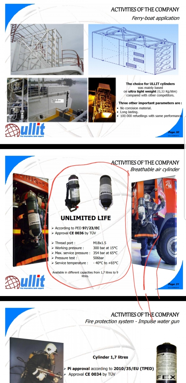

I just came across and I am amaized to see it.
Its made of three pieces. Top and bottom are screwed into the central cylinder pipe.
Any idea of price?
Anyone used these?

No sir,
These cylinders are made through a different technology.
These are not one piece rather these are made of three pieces. Bottom is separate piece that is screwed into the cylinder body and again the top area is also screwed into the cylinder body.
These are bigger in size but are light weight.
Built quality looks amazing.

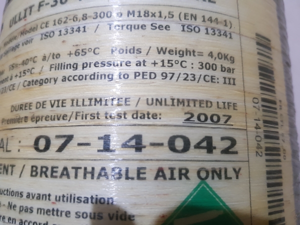

I wonder that how they write unlimited life on these cylinders.
What will be the price of a new one like this?

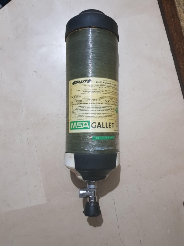

I do not believe they have a DOT Special Permit number. Hence they would not be sold or allowed in the USA. At least to be transported in commerce. I may be wrong, but I would be surprised that it was truly a 3 piece design operating at this pressure. The black caps on either end are most likely just protection to help protect the vulnerable domes from impacts.
Yes those two rubber shields are just protectors but under those shield there are threads through which 3 cylinder parts have been screwed in to each other to make one complete cylinder
Mark spot on, can’t transport and no reputable US based business would risk the liability of filling such a system without a DOT sticker. Heck my local dive shot spun itself up into a complete tizzy over the LE sticker on my Air Venturi 66cuft tank. I ended up leaving it with them and sending them a bunch of extra info on the DOT Permit, my pouchsee order from Pyramyd, and an explanation of the LE Recertified program.
I currently have an Interspiro. In Europe, no DOT, same exact tanks, ANY carbon fiber 4500psi tank has a 30 year life. DOT is BS. I'll be buying a Crosman compressor for around $600 & filling that tank until I die, which won't be from a 4500psi filled grenade. Don't listen to me, or let me tell you what's safe or not. I'm just saying I'm not going to expose my tank to pressures of 7-11K when hydro tested. Again, same tanks, 30 year life & I'll be dead of natural causes before that tank expires in 30 years.
