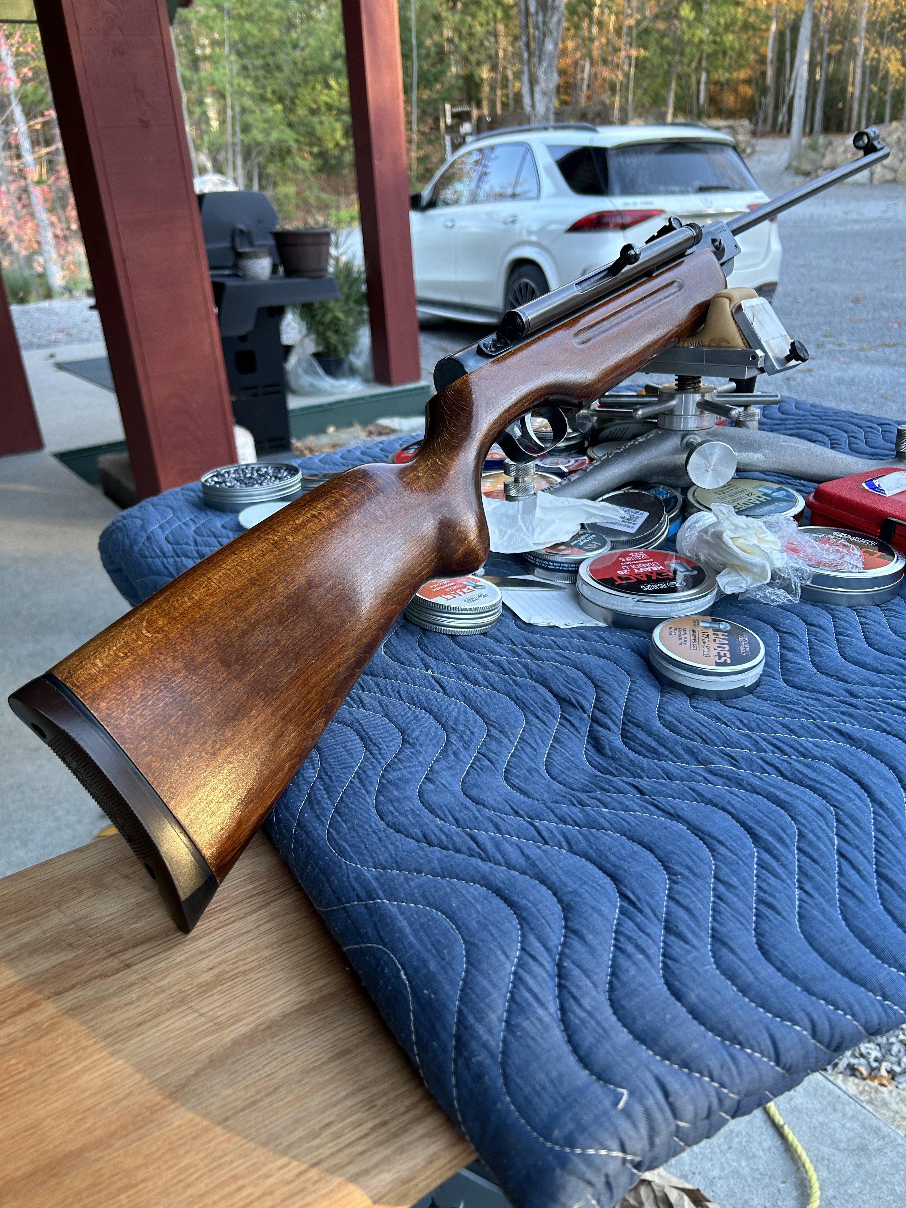

Ironically, I just got a new old gun last week. That dieseling is intentional. A Weihrauch Barakuda. I have no intention of using any ether in it but I will be shooting it. It’s a beautiful shooting gun. Crow

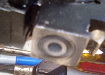

My new HW95L was dieseling caused by over oiling/greasing by the factory. Excellent info on this forum and erratic POI indicated that I needed to correct this problem. Chrono #s indicated FPS was also swinging about 75 FPS. I installed an ARH kit with a Vortek seal along with a through clean/polish of the internals. I also used GPL-205, Krytox lube which is known as non-dieseling. The rifle averages about 17 FPE with 14.66 gr FTT pellets and the accuracy has returned while the FPS varies about 10/12 over 10 shots. This is the old seal that shows the damage caused by dieseling. I cannot detect any smoke coming from the shot cycle now and this is after about 8K shots with the ARH kit. The GPL-205 lube is expensive but IMO it is well worth the cost.
Wow, that seal is fried! I haven’t been keeping up with the latest trends in airguns (my newest airgun was made in 1994) so please forgive my ignorance. What is Krytox for? The spring or the piston seal?
