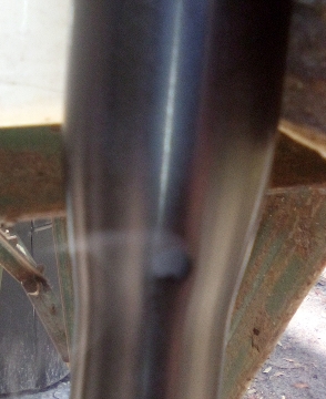

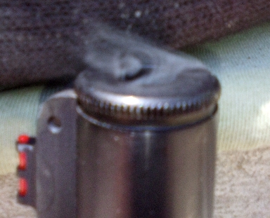

I got a hatsan 95qe. All the cleaning and krytox and still ...
Portrayed actual shooting of it ..😜

All my springers smoke a little. Even after many thousand rounds. It's not excessive. Just a whiff of vapor. I figured they all do it. I've shot many different brands and types. Every one I've shot will do it a bit.
Some cleaning penetrants will remain in the barrel after cleaning. I notice the vapor more afterwards. I started using an acetone patch after cleaning to get the oils out. It works dandy. Still there is a bit of vapor in the tube after each shot on every gun I own.
I don't consider it "dieseling" or "detonation". It's just the pellet farting when the pressure hits it.
I thought dieseling was the result of burning lubricants in the compression tube, not the barrel. How do cleaning solvents burn in the barrel? Maybe I misunderstood what you were saying.
Oil under pressure burns. Dieseling can occur anywhere there is enough pressure. When that piston slams it pressures up everything behind the pellet.
There can be more oil and more pressure in the comp tube for sure. So diseling and DETONATION occurs there first. But it also occurs in an oily barrel.
"Dieseling" is vapor lingering after the shot. "Detonation" is when it pops because the burning oils cause more pressure.
Different oils vaporize at different pressures. The stuff they use in a comp tube is pretty stable. The stuff you clean a barrel with is not. It diesels (burns) easily. After a few shots the stuff in the comp tube is (ideally) burned off. Every time you clean your barrel you coat it with oils that are going to vaporize and "diesel" a bit.
The goo they put in the barrel after manufacturing is nasty waxy stuff. It gets down into the nap of the metal and can't be all cleaned out. It takes a good cleaning, a hundred shots and another good cleaning and polishing to get it all out. It "diesels" too.
So "detonation" is extreme "dieseling" and dieseling is smoke or vapor lingering after the shot. Both can occur in the comp tube or the barrel. Excessive dieseling is an indication of a fire (detonation) somewhere. In the comp tube it will destroy a seal. In the barrel it's less critical.
To keep dieseling down in the barrel get all the oil out of it after cleaning. A couple dry patches will do it. A patch damp with acetone really strips the oil out but is probably unnecessary. As long as the bore isn't swimming in oil a couple shots will take care of it.
