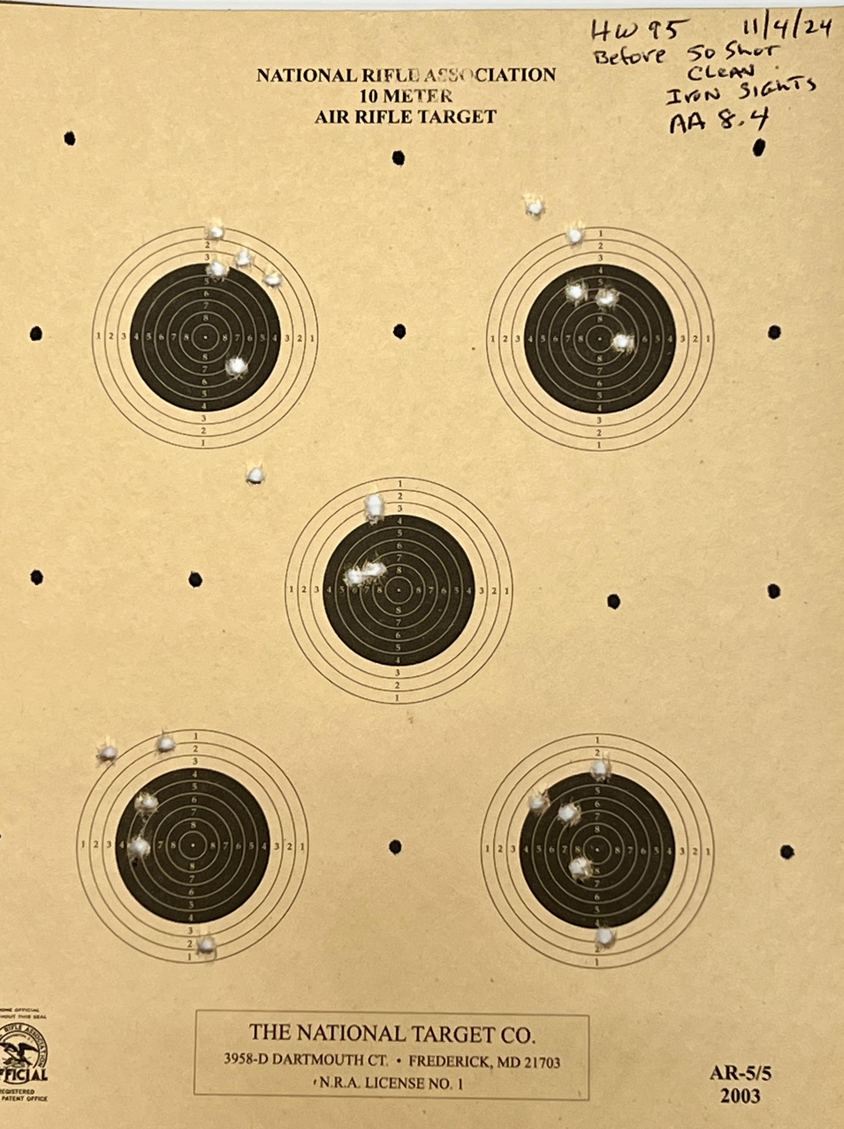

The stock screws were the first thing I looked at. They were ok. I cleaned the barrel twice, the second time included polishing with JB Bore paste. I pushed a slug through it and the rifling grooves in the slug looked clean and uniform. Right now, I'm shooting with the factory iron sights. Regardless, the shot scatter shouldn't be this bad. Vortek spring kit is on the way. BTW, I bought this used from AOA. It looks brand new and spotless on the outside. I'll bet it was returned for it's not so good accuracy.

I notice the flyers first, then the smell, then see smoke when I cock the barrel.
Well are you shooting rested or free hand / standing? With the r9 my freehand standing is maybe 1" at 10mm group on a good day
Sandbag. I've used the same setup for a number of other rifles. All of my .177 rifles will shoot one hole with 10 shots.

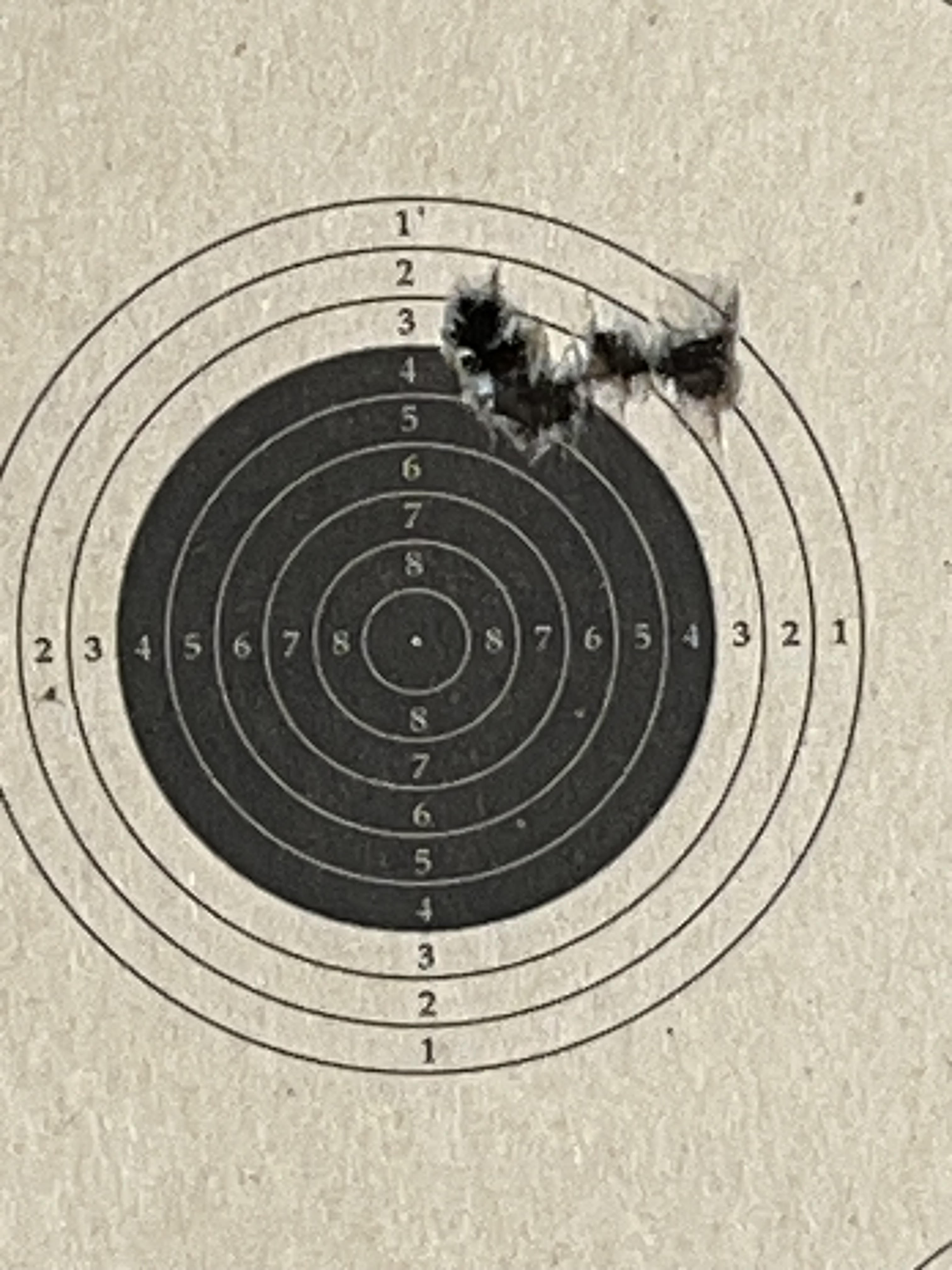

I did some more shooting this afternoon and I think I may have found part of the solution. The first targets I shot, I laid the gun forward on the sandbag with fairly light pressure on my shoulder. This thing recoils like a .300 Win Mag. Then I moved it forward on the bag and held it tightly on my shoulder. Group size was cut in half.
