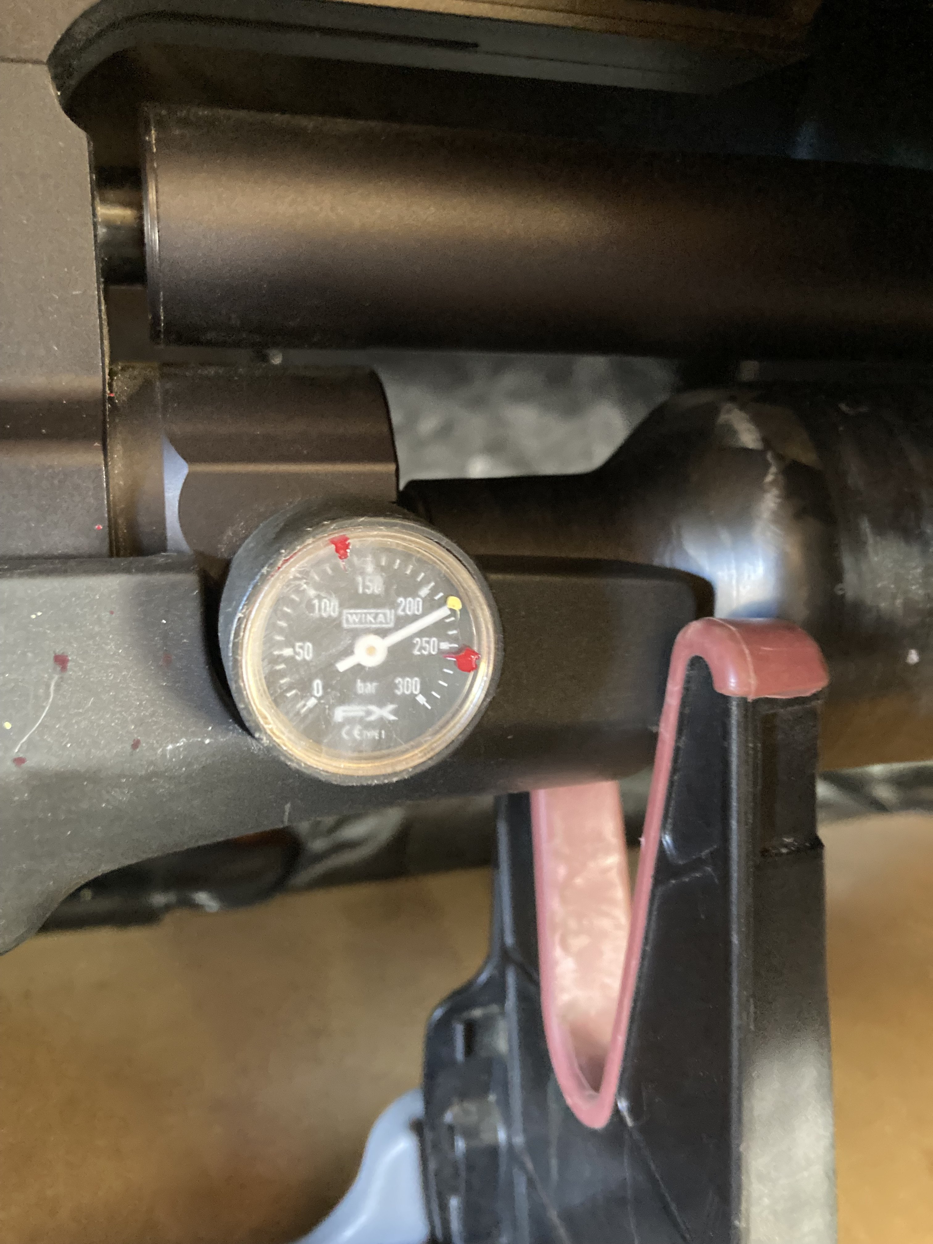

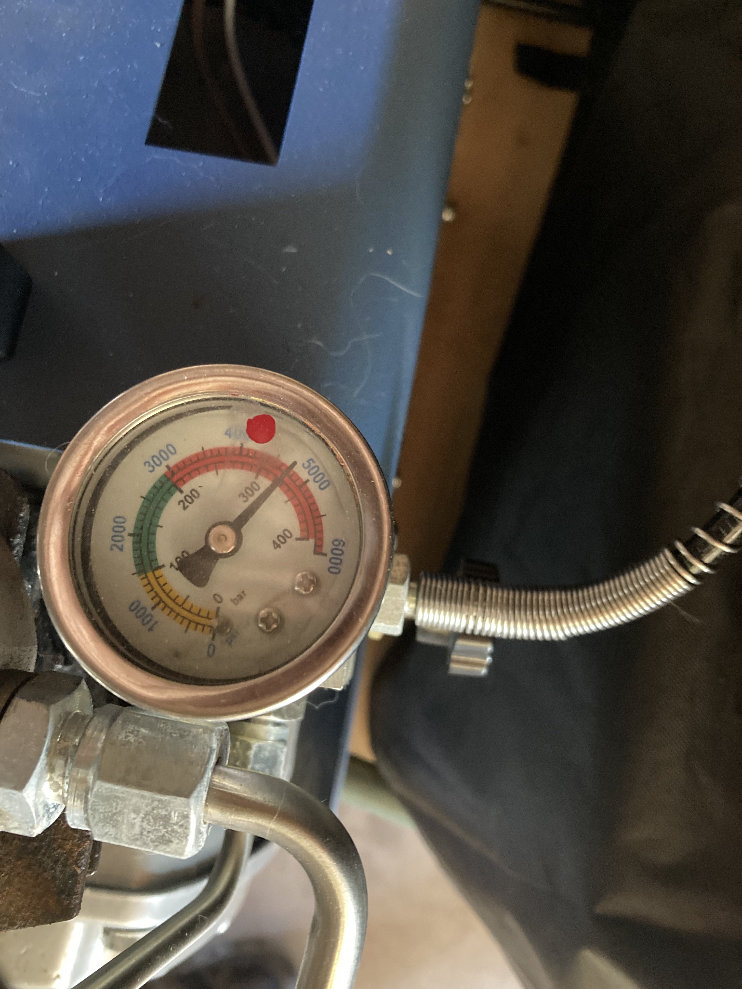

normal to have this much press diff gun bottle v compressor? been like this from start

Yong heng gauges spring to a memory pretty quick. Have good trustworthy non chinese gauges in line to confirm psi and supervise it. Don't trust the auto stop anymore. Mine was the same way before I gave it away. Redundancy in measuring is good for your safety and your guns.
Reactions: OldVet and Cran
NO! that's a 100 bar difference, waaaay too much to feel comfortable with. No telling which is right, but I'd put more trust in the Wika. If in doubt, I never go above the lowest one, until i can confirm with another gauge.
The compressor reading high failed safely at least. It's going to lead to fudging the auto stop which leaves too much room to find out how your burst discs and orings are doing. Yong heng work, but they're a big time liability imho. I went thru 3. Now I have a big dive clone and swear by the disposable toauto orange shoebox clones. They're cheap and work really well for their size.

thank you both, i think im gonna get did guages for the guns AND COMP if... thanks again
I never trust auto stop on anything! As far as the gauges I don't trust the ones on the compressor. I fill tanks and, on the valves, I have gauges and on the tanks themselves I have them, plus I never fill my pcp from any compressor. If you can get yourself a bottle if your compressor will fill even a small bottle and pair it up with a good quality gauge and get it checked every now and then. They aren't cheap but safety is everything.

thanks for the input. Im just shootin 2 acre bak yard full of ground squirrels, fill the bottle to 225, reg at 125 which gives me seven mags worth, then back to the ban for more of each. Keeps me from shooting below reg press. I tried a auto shutoff, kinda scared me then it quit… so, i think im gonna put an oil filled on the comp and a digital on the gun… pricey but, as you say…

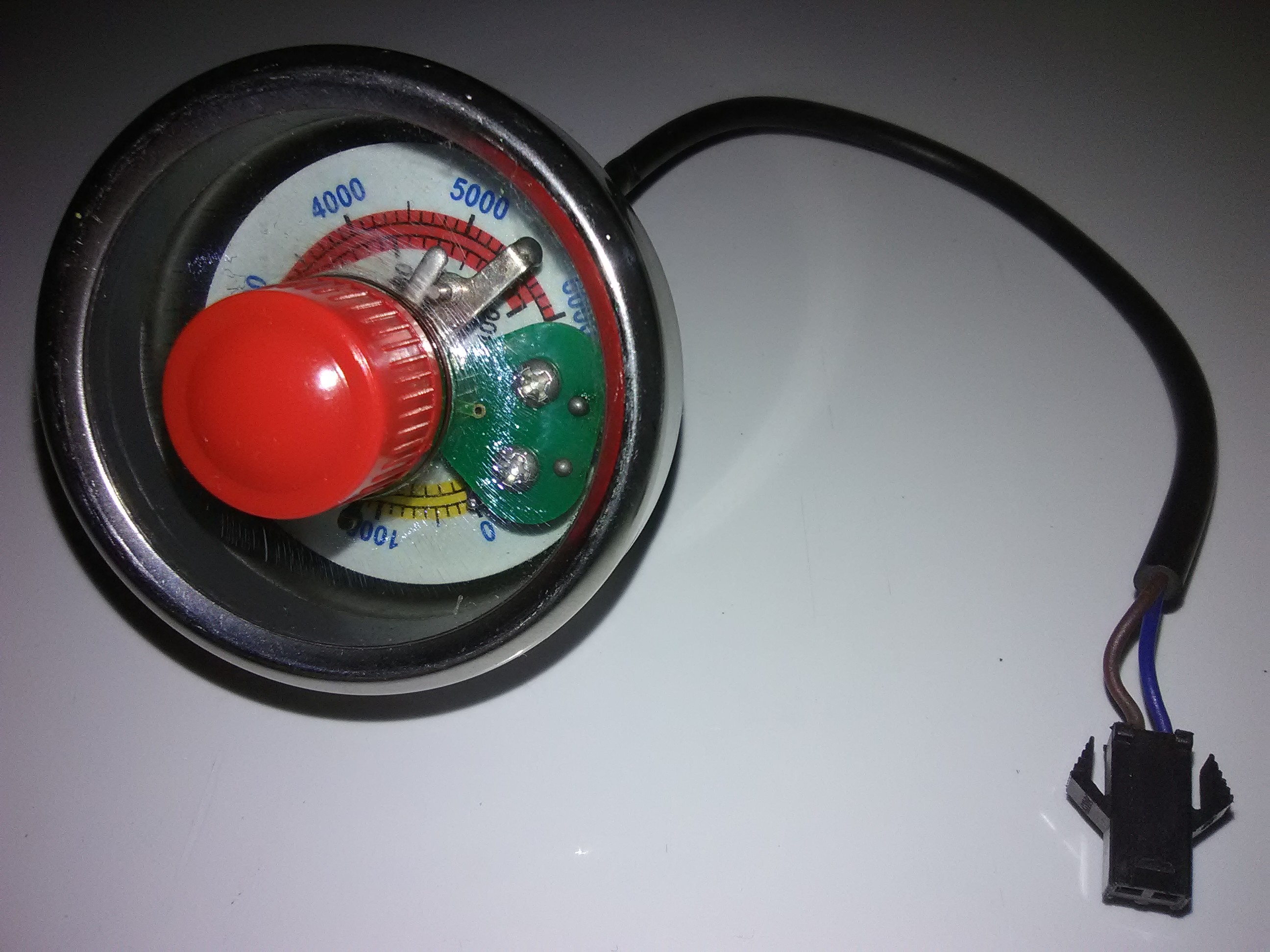

I have a few of these, one on my yong heng and one on my tuxing. They are affordable, and better than what comes on the compressors
