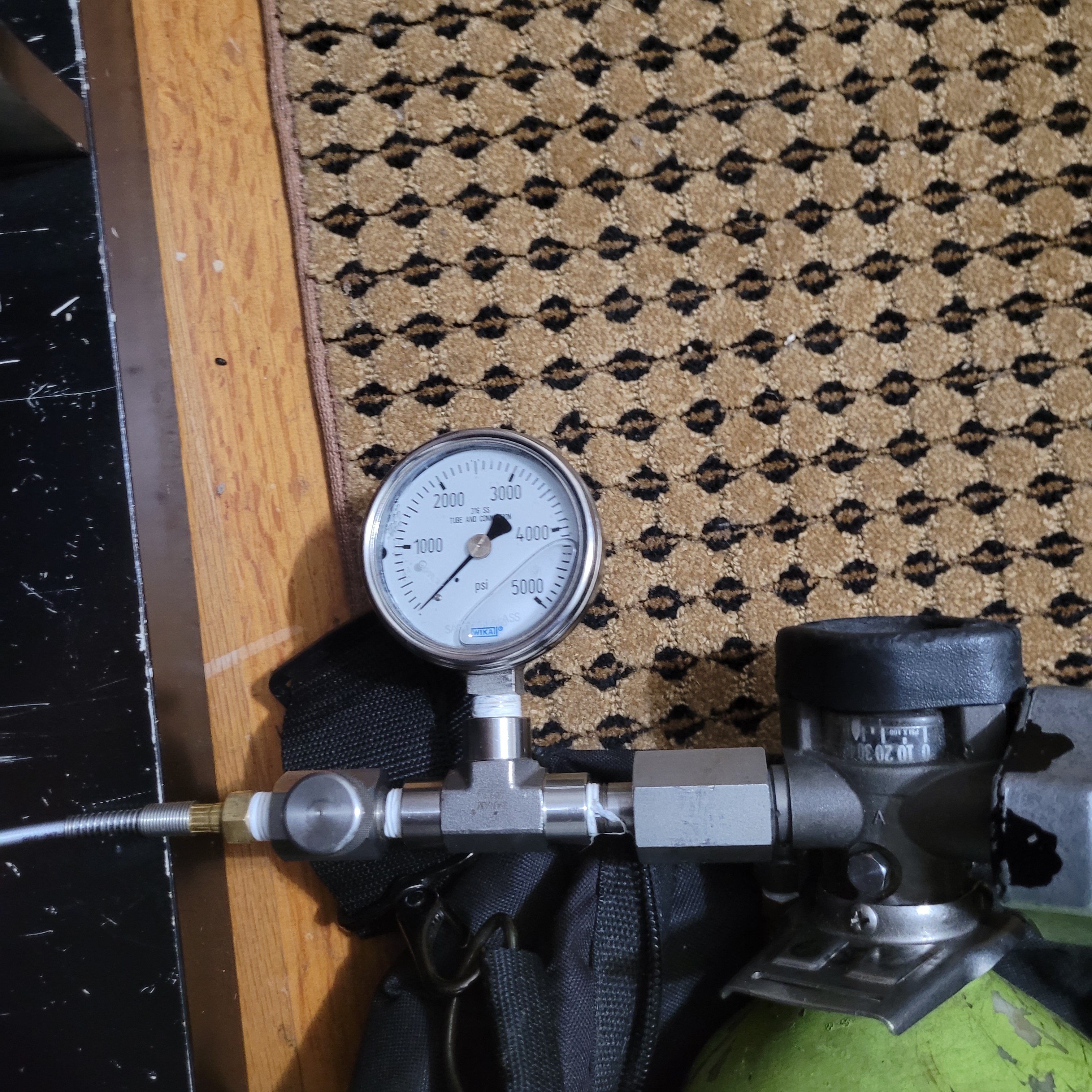

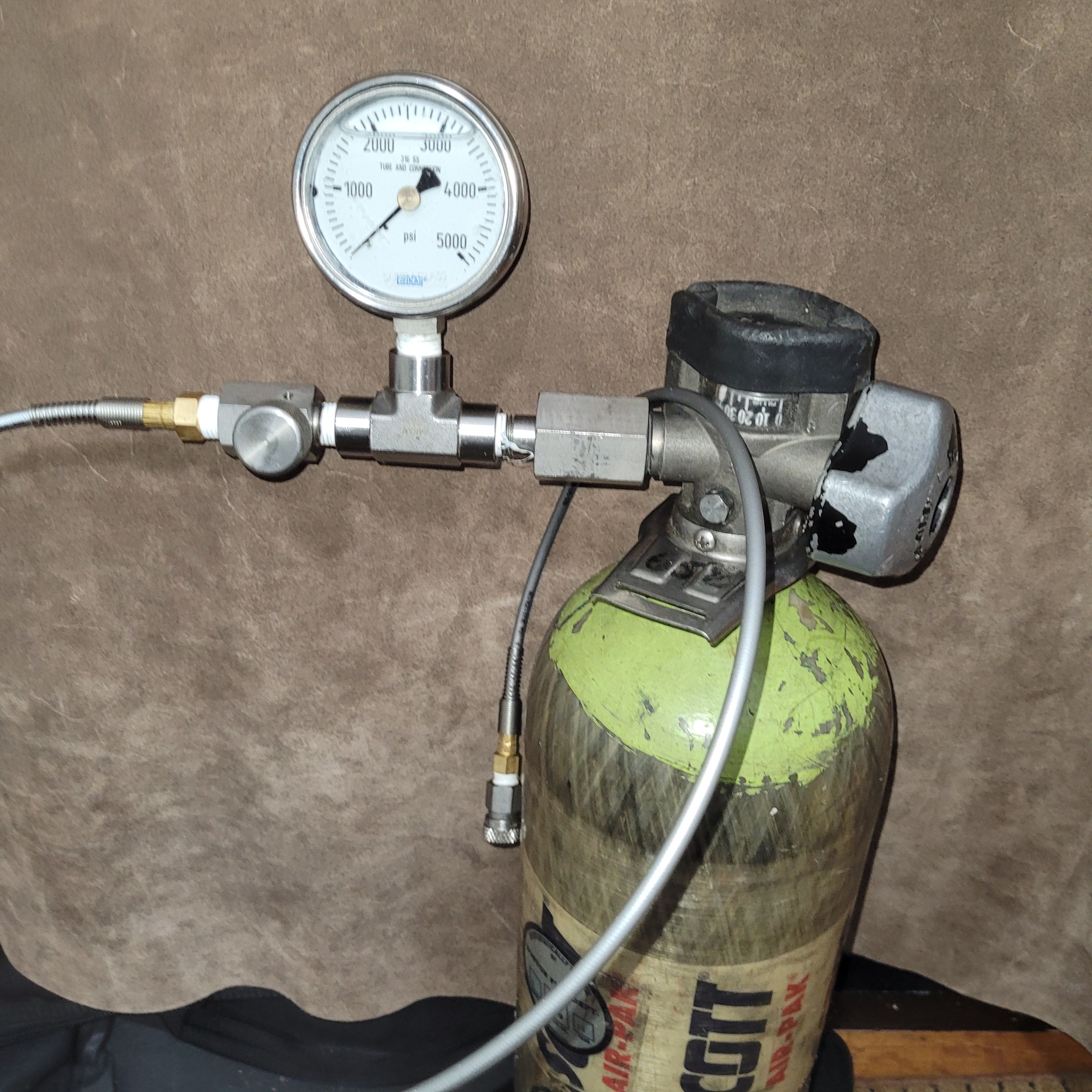

I’m sitting here struggling with the gauge thing again, and glad I found this thread. I have a hatsan 4500 psi guppy bottle and a GX 4 compressor. The gauge on the hatsan bottle is absurdly far off - at least 650 psi higher than my other gauges. My gx 4 and huben pistol agree that the hatsan gauge is inaccurate, but it still alarms me a bit to see the needle so far off for the hatsan. It will read well over 5000 psi if I actually fill it to 4500 (which I’ve never done). I would like to fill it to 4500 psi, of course, just to be able to carry a little more air in the tank but I’m unsure…. Your thoughts?
As suggested above, finding a neighbor/friend with a quality gauge might solve your dilemma.
Another idea, lacking that, is to swap gauges on the guns. If the gauge reading too high reads too high on the other gun (most likely) then that is the culprit. Should probably replace it.
In this case, the gauge on a guppy tank is off, but other gauges all agree. Just wish the gauge on the guppy tank read closer to the gx4.
I just moved to this area in the spring and so far I have not met anyone nearby who has anything to do with HP air, diving, airguns, etc..
There is a dive shop in Pittsfield - i will give them a call.
Ahh, sorry, I saw Hatsan, missed the guppy tank part, and assumed it was the rifle gauge.
I don't think you should have anything to worry about, personally. But agree with everyone else's advice on getting a high quality gauge for the tank. Should solve your woes.
I put the Saber Tactical valve/gauge/handle on my SCBA tank, love it, and the gauge is amazing. You might call PJ or Izzy tomorrow and see if they can sell you a stand-alone gauge. Their number is: 321-414-0417
