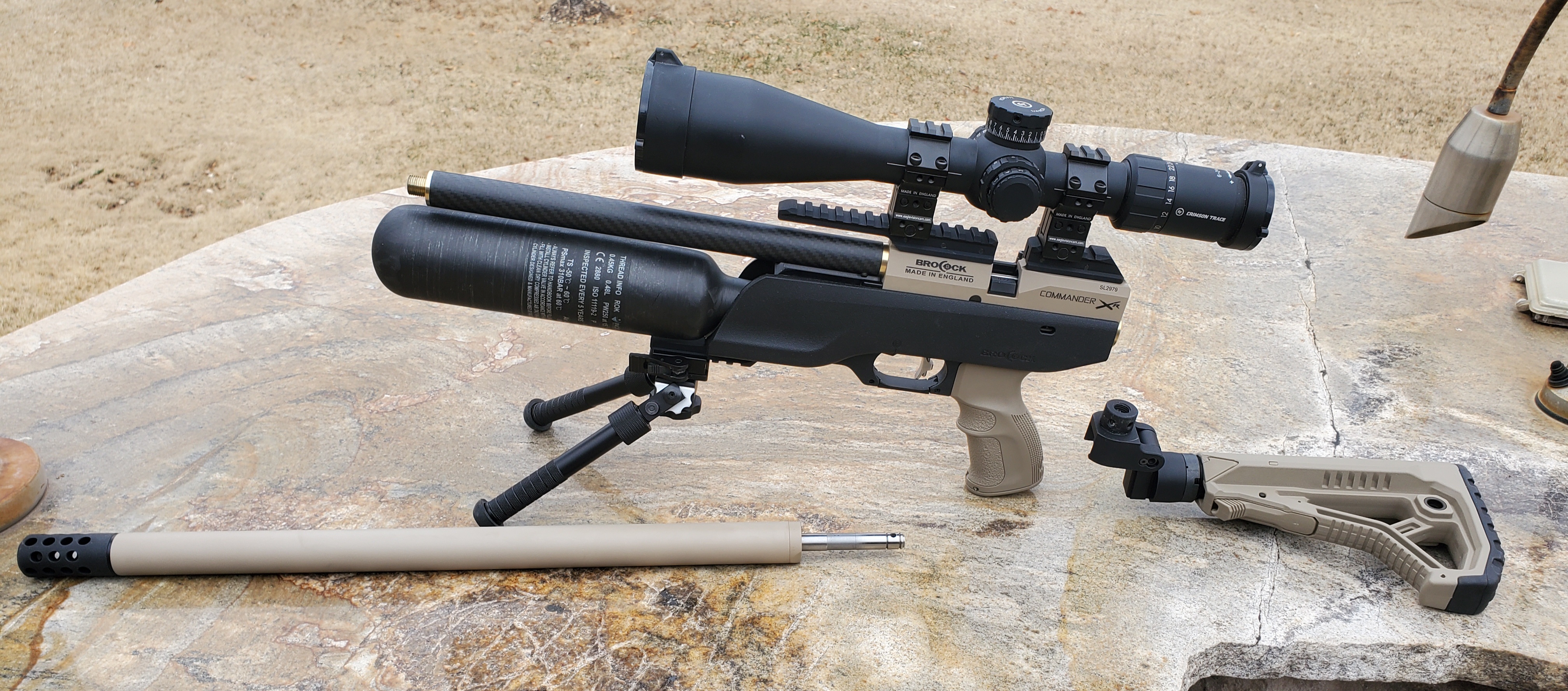

Here is a pic of the project "pifle"
A couple of details:

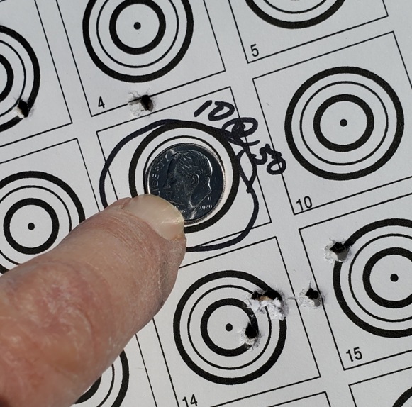

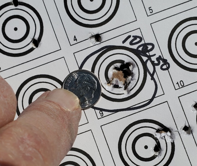

And a test target at 50 yds:
Now I want to point out where the original 22, 18.1s would have been ... a bc of 0.0223. Note that the WORST 177 in our previous testing was a bc of 0.0293 and the best 177s and both 20s are well above that. I fully realize that the bc is not all there is to wind drift but it comprises the bulk of the equation.

Derrick sent me some photos of his groups from the .20 and they look just like the ones shared above. Same gun, two different shooters, and exceptional accuracy. I think those Ranchito Ron Robinson shooters out in Texas are gonna have some serious competition from Derrick and his VERY special .20 custom pistol build in Ron's Extreme Pistol Field Target events.

To clarify a little, the above test target was 177 with 13.43 MRD's but I achieved at least as good with both 20 cals.

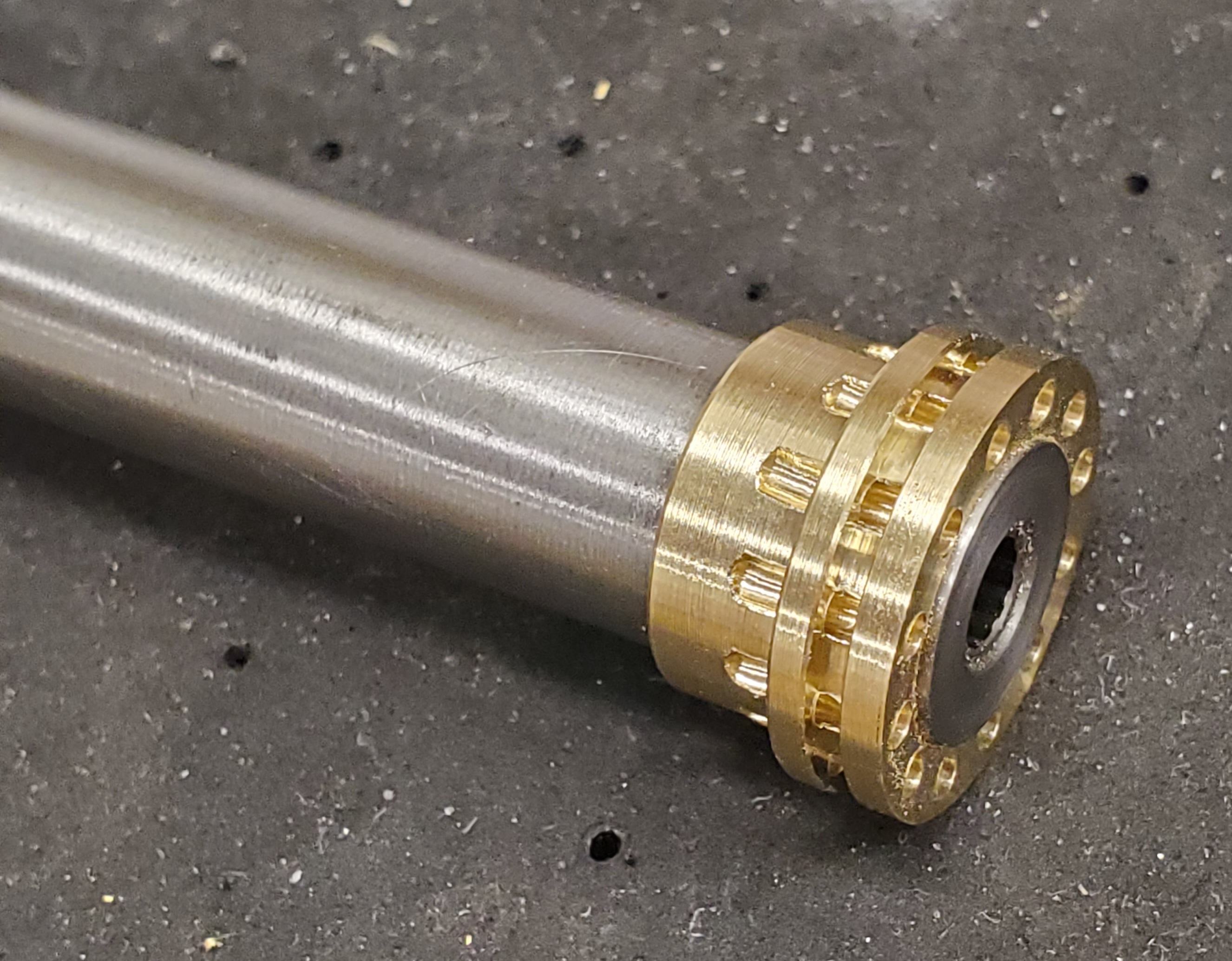

It was an interesting project that I've wanted an excuse to do for a long time. It was impressive enough that I fitted a 20 barrel for my Delta Wolf and that fits the Ghost also. This is one of many such groups at 50 with the 13.4s at 20 ft lb.
(I'll go back and edit this in... can't upload for some reason right now... it's very good though)
