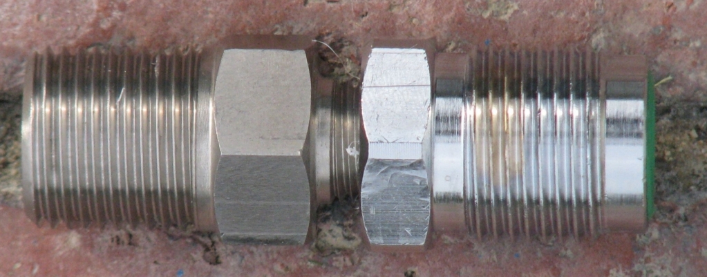

DIN300 Male to CGA347 Adapter?
I got the exact same DIN300 to CGA-347 adapter from Joe Brancato, airtanksforsale.com for my Great White.
mtnGhost:
If you want, you can get one of these:
Female 1/4 NPT to Male Din Adapter Thread 300 BAR - https://ebay.us/o3oW7J
And one of these:
CGA 347 (SCBA firefighting) x 1/4" MNPT Adapter (F-06181) - https://ebay.us/Omrm73
And for $35, you've got your adapter. I did mine this way and all you need is a bit of teflon tape for the npt thread. Or you can certainly buy the one referenced above for $65.
Reactions: mtnGhost
mtnGhost:
And one of these:
Awesome! That should work just fine :)
Thanks!
