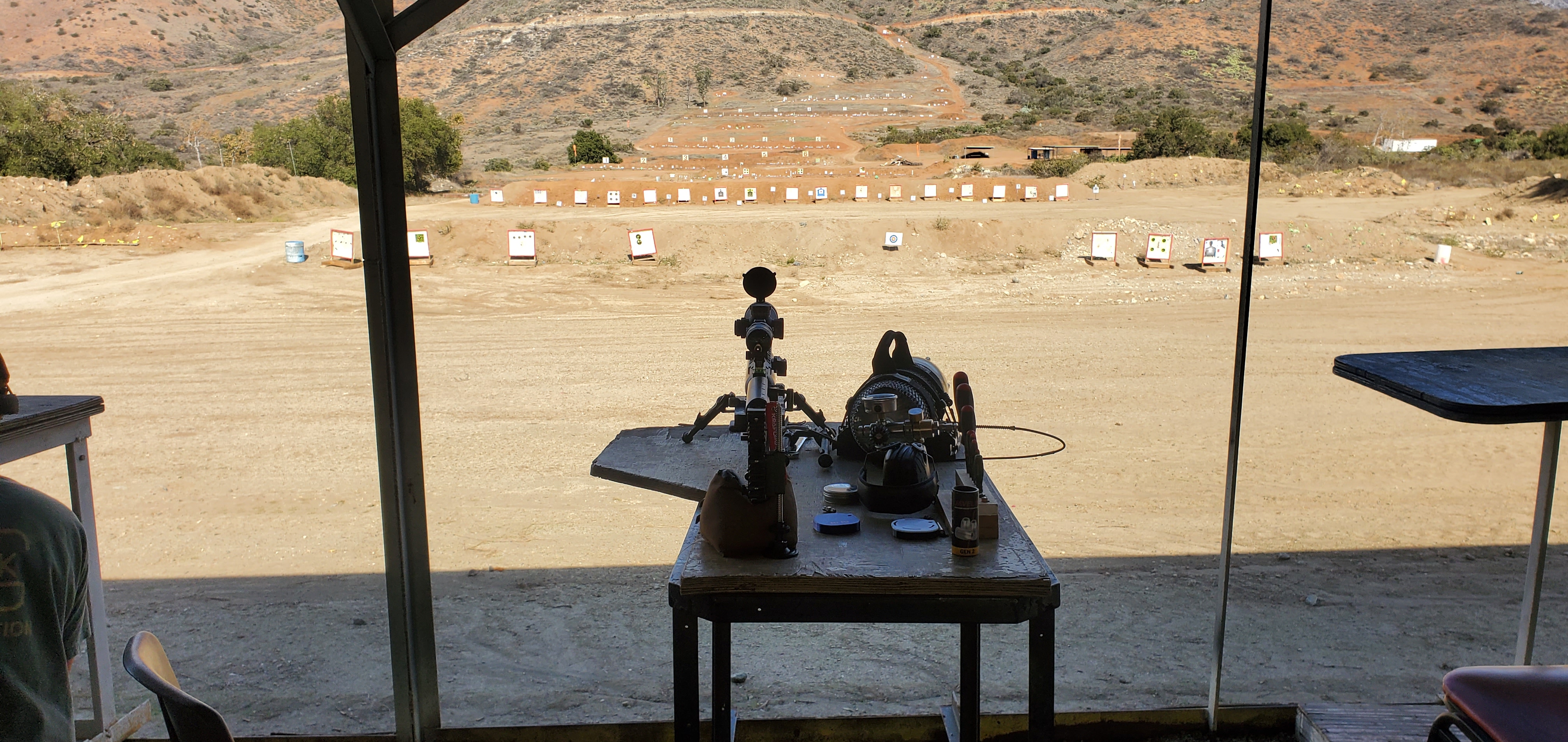

Yeah kinda sucks everything is going great then poi starts moving. It isn't realized until you made a couple adjustments to the gun that the bottle pressure dropped. Having the gun tethered makes it one less thing to worry about.

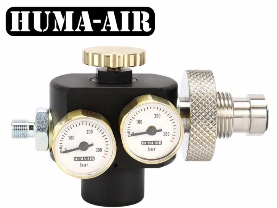

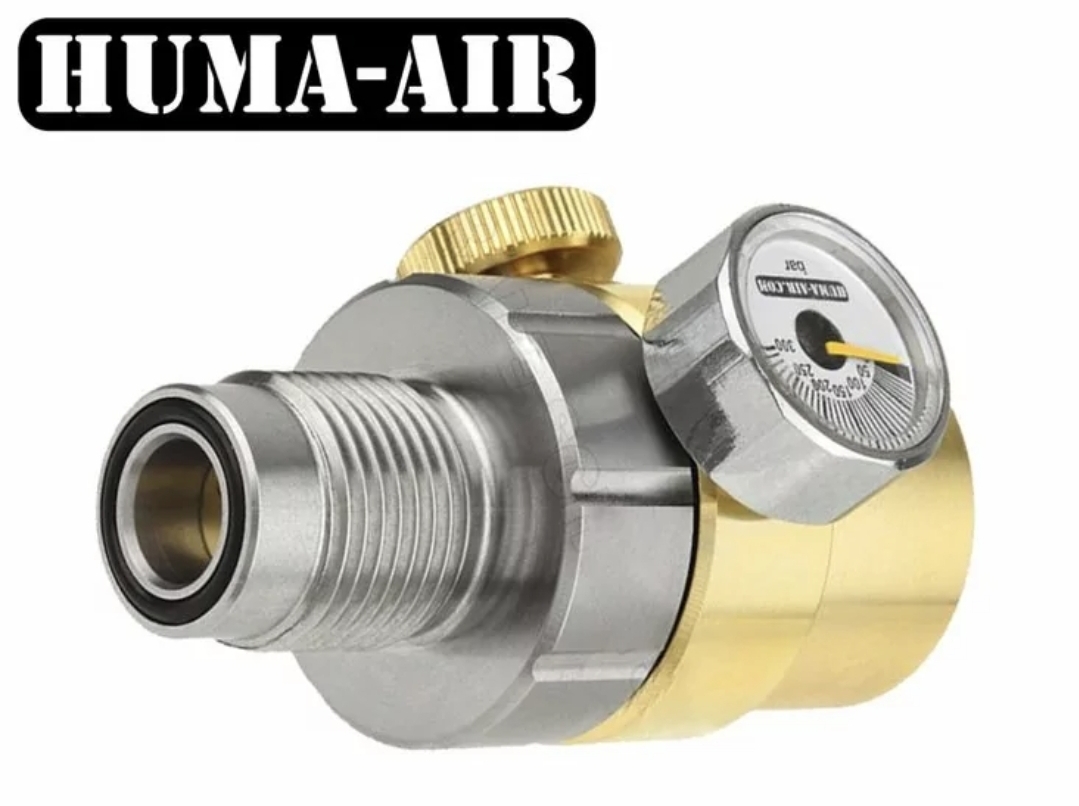

I use these to regulate pressure to the guns. Note with these two no more than 300 bar fill at the supply bottle.
I use these on the bench with my ELR impact. I have the reg pressure on the gun at 170 bar so 200-205 is what I have the bottle reg at.
