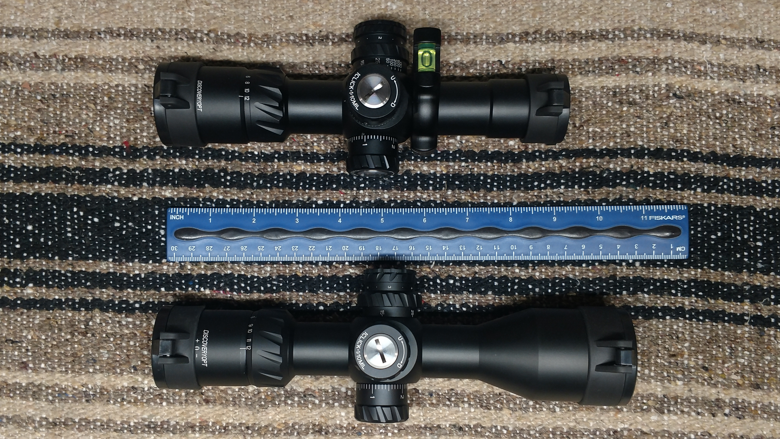

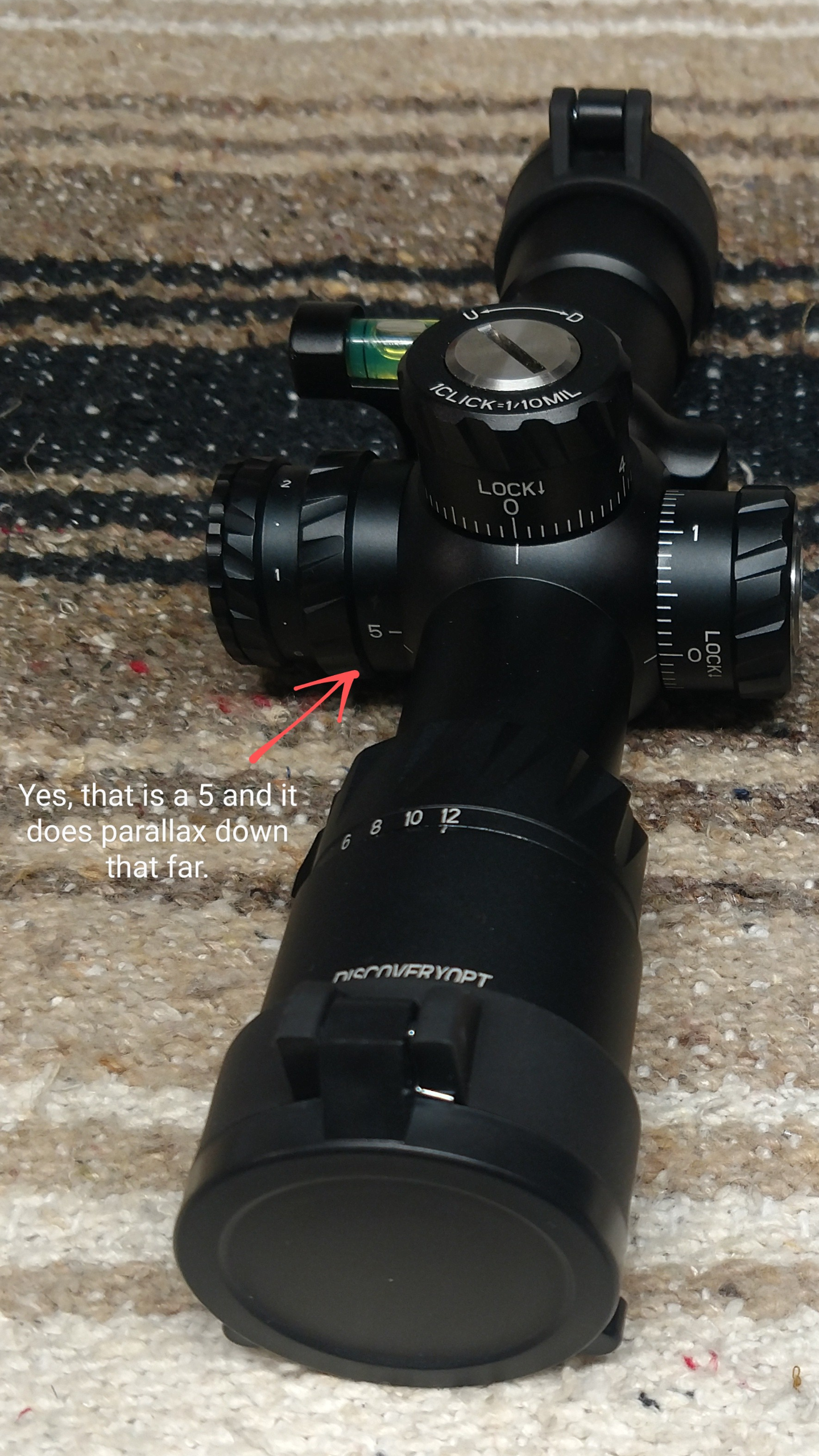

I bought a new offering from the Discovery factory this week to do a little experiment with. And when I say little, I mean it is a little scope at 81/2" long. Discovery HD 2-12X24 SFIR FFP is a gem of a scope for the price. In the daylight it compared on par with it's next biggest brother, the Discovery HD 3-12X44 SFIR, except for the parallax adjustment. This thing parallaxes down to the advertised 5 with clarity at high magnification! At low magnification the fish eye effect was really minimal, and only noticable if moving the eye and only at the edge of the glass. It was more of a parallax effect bending out towards the edges but remaining centered on target. Side by side at dusk the win goes to the bigger 44mm aperture for light transmission when looking a couple hundred yards into the dark tree canopy, but this was well after legal hunting hours in most places and really a non-issue for me. The one place both scopes sucked at was illumination in the dark. The red light slightly blurs the reticle as it shines on the glass. But again, this is in a dark room and it can be easily seen though at dusk. This is going to be a good little hunting scope. In case you were not realizing the true difference in size, there's picture next to a full-sized scope that came off the Evol.

I had a question from someone about getting behind the eye box. What I found as compared to a bunch of other scopes (some similar, some bigger) was that it was not bad at higher parallax, but at the lowest setting it was tighter. This was true with any scope but predictably tight with this one. It was roughly a half inch of eye/head movement from centered to off the scope's sight plane. I did not really feel that getting behind the scope was a hindrance even at close range and high magnification though.

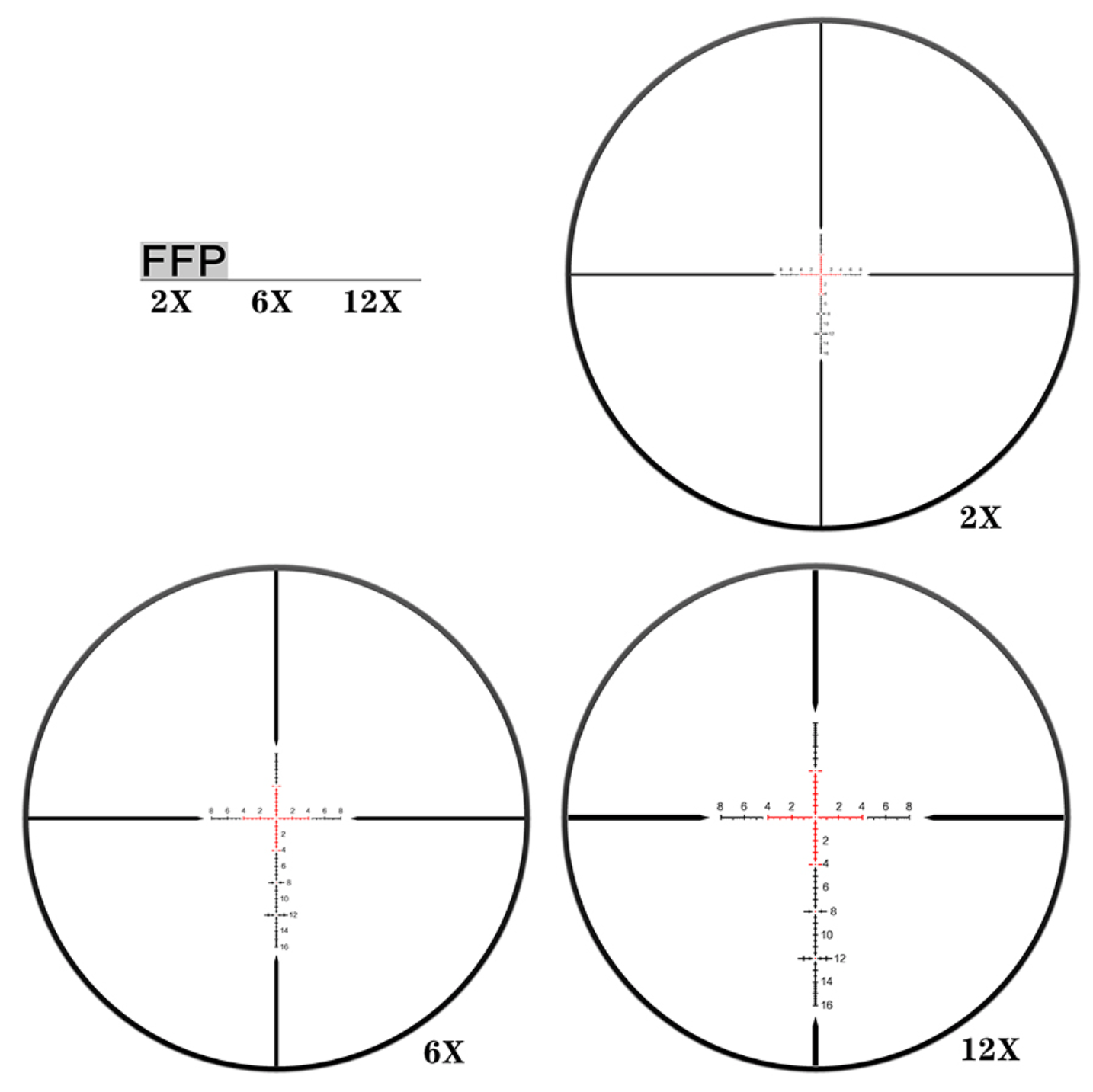

Yes, this reticle design is really nice. A light Christmas tree pattern underneath for quick elevation and wind holds would be ideal, but we'll see how it holds up to dialing for elevation.

By calibrated reticle do you mean FFP?
I used to have a 3-12x32 Bugbuster. My vague recollection is the reticle was true at 10x rather than full power. That & the eye box at higher powers were the main reasons I traded it away.
The Bugbuster, and I believe all UTG/Leapers scopes are second focal plane.
On the bugbuster in particular , the reticle has mil-dots, but there are no numbers associated with each dot (No 1, 2.5, 5, 10, etc.).
Not a huge deal, especially on a close-range scope, but numbers would indeed be nice, and the Discovery scope has them.
