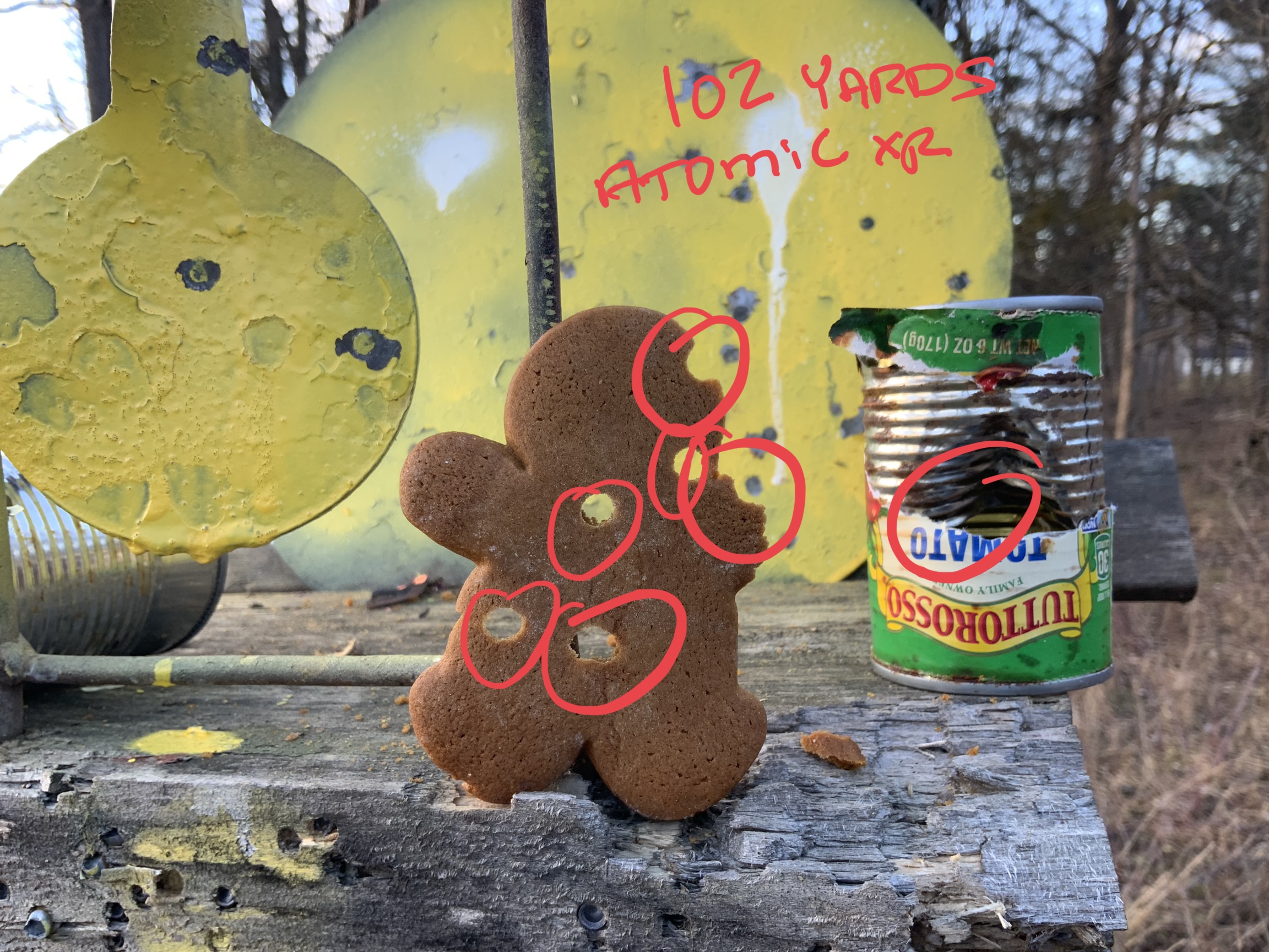

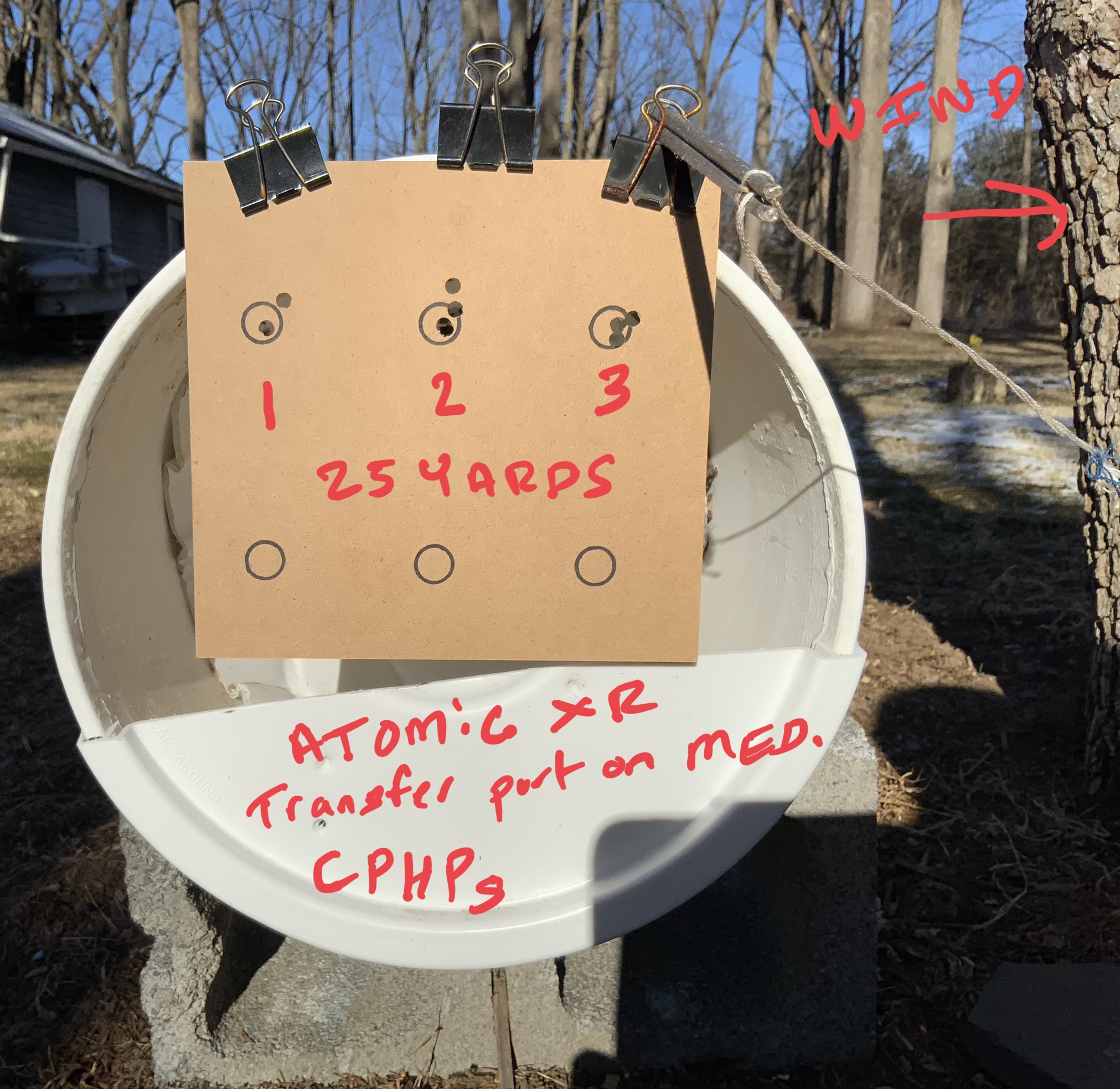

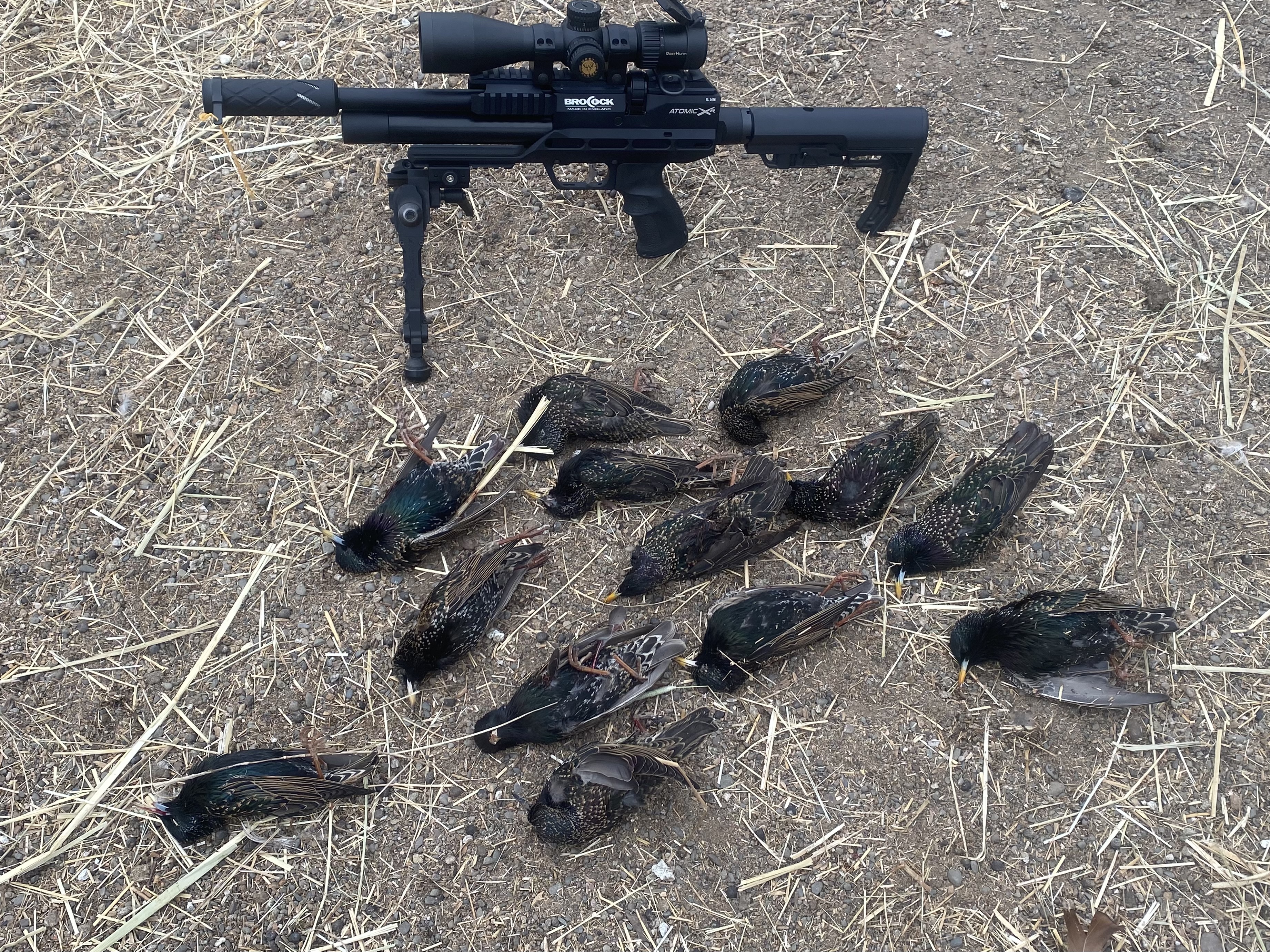

Three fine choices… I am partial to the BRKs… While you will definitely an airtank to fill the Safari and Katran. The Atomic XR can be easily hand pumped. Mine are good on small pests to 50+ yards, they are quite versatile little guns. The little Atomics punch way above their power level. My first Atomic was purchased singly. My second was a ”We the Plinkers“ package, very, very happy with both of mine. I also own a Pathfinder XR. If I had to choose one? The Atomic all the way, because they are quite capable and don’t require tanks or HPA compressors to keep filled.

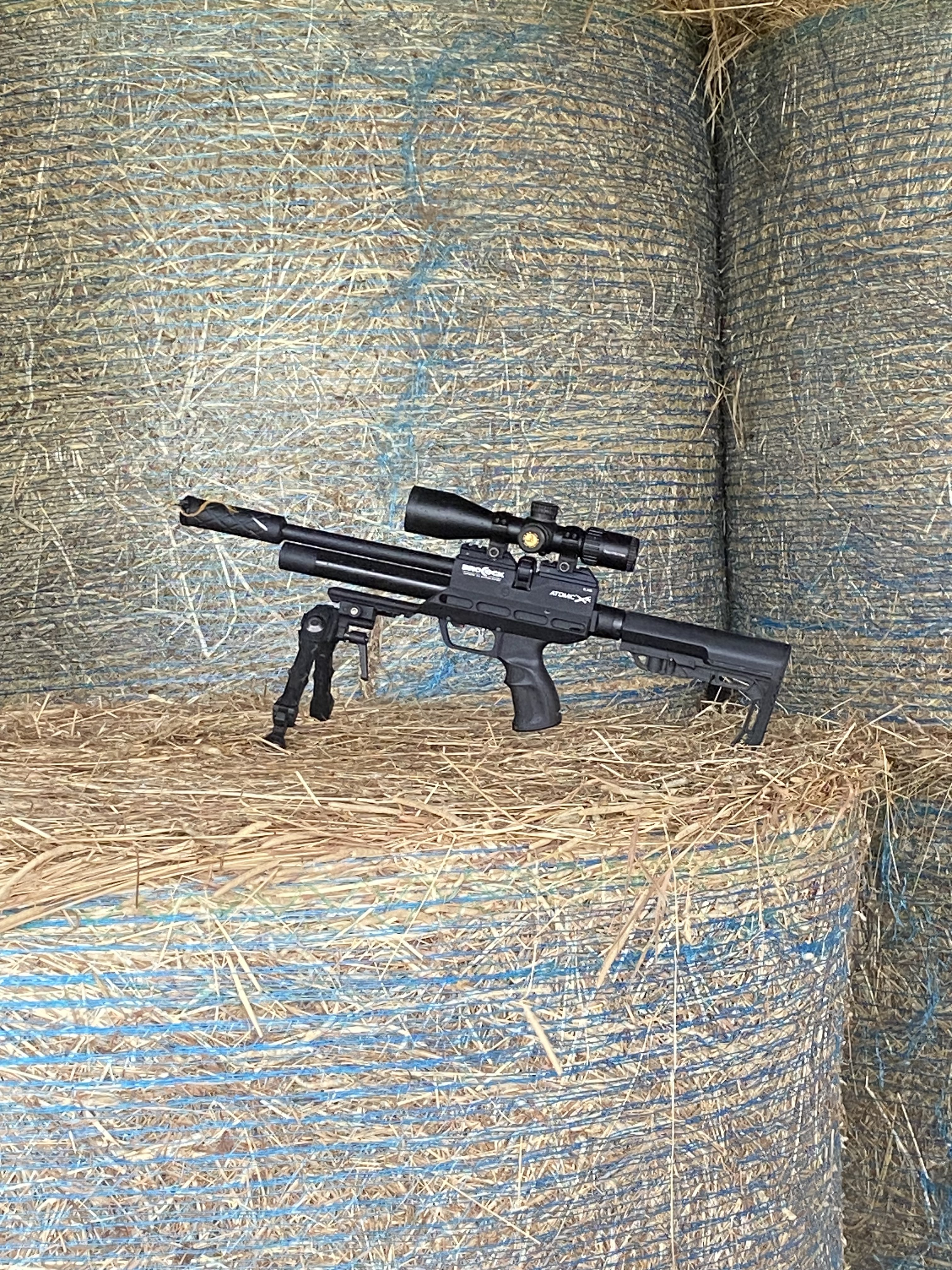

I wouldn’t get an Airmaks. It can be a lot of work to take them from their stock unfinished functionality to a reliable gun. Plus, the shorter the barrel, the more pain arises from the flaws with the reg, hammer system and valve. Maybe one day, Airmaks will release something that is ready to shoot. Just my 2cents having owned a Caiman, Krait and Katran L.
