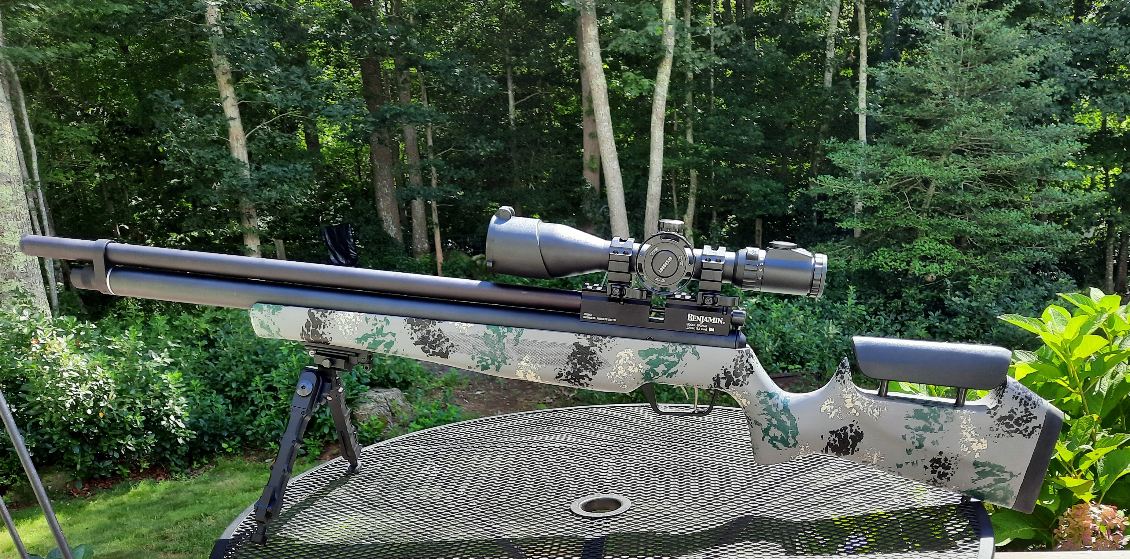

I removed the scope and degreased and taped off everything I didn't want to get painted, then I laid down a base coat of Khaki on the scope and rifle.
Next to go on were the first rubber bands.
Then the Earth Brown.
Followed by the Army Green.
The trick is to not move the rubber bands you just painted over when you are putting a new layer of them on.
After another round of rubber bands I finished up with another coat of Khaki.
Here's how it ended up looking after I cut all of the rubber bands off.
I still need to hit it with about 3 coats of mate clear. Honestly I like it! It's not boring anymore.
It was a lot of fun and very satisfying too. Not that difficult to do. Just got to be patient and take your time.
This technique really works great!
