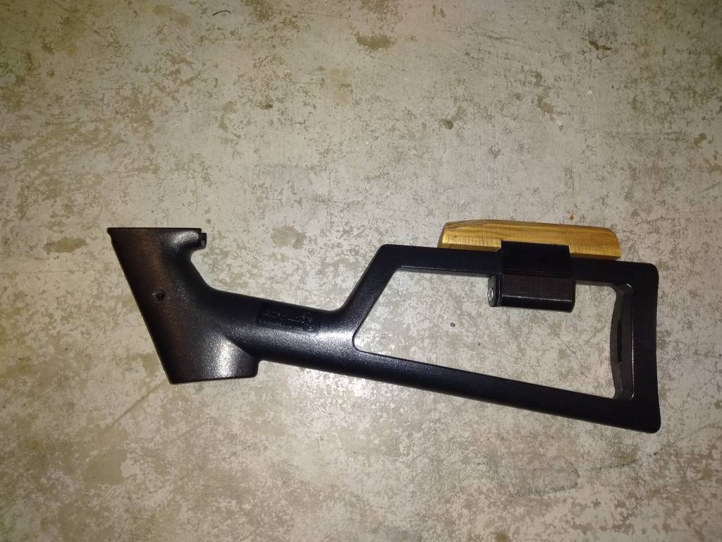

I chopped this one for my grand kids. Work real well.
