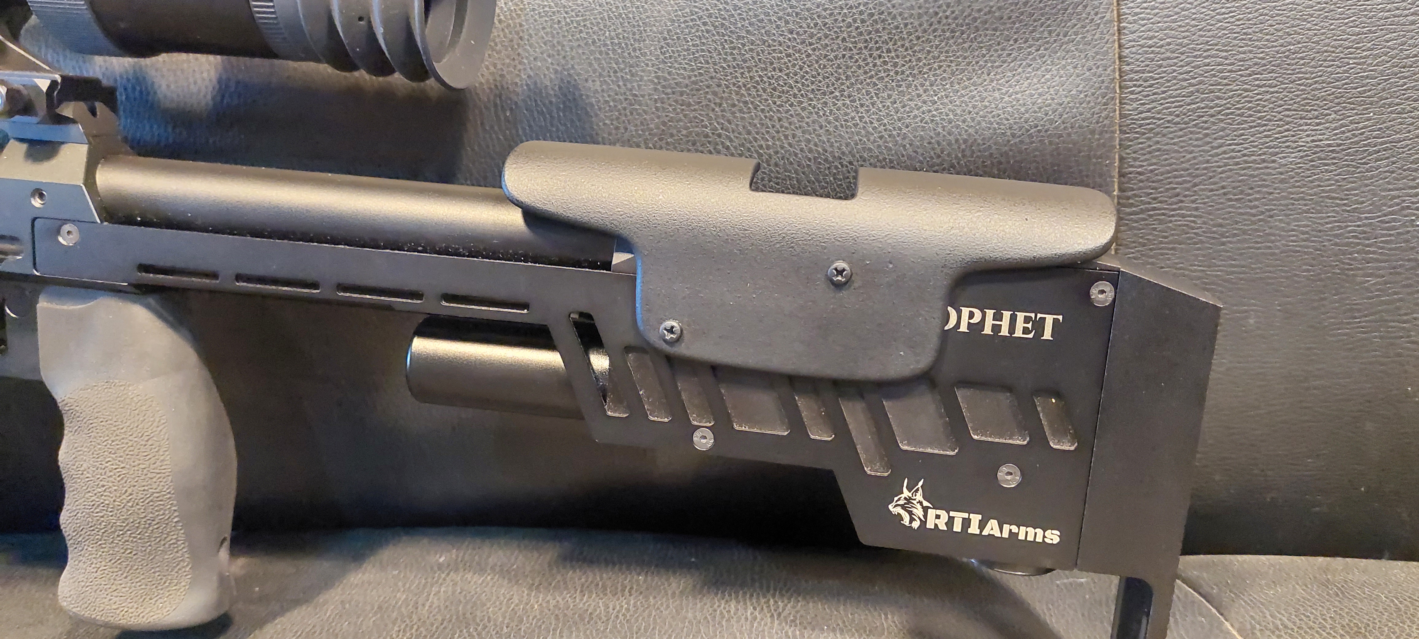

This is my solution to cold cheeks, turned up really good, and cheap as dirt .I try to Imitate the p3 cheekrest ,made a couple of cardboard templates to decide the shape and with a piece of 50mm pvc pipe cuted in lenght and a heat gun to shape it (its super easy) then sanded and painted mate black.

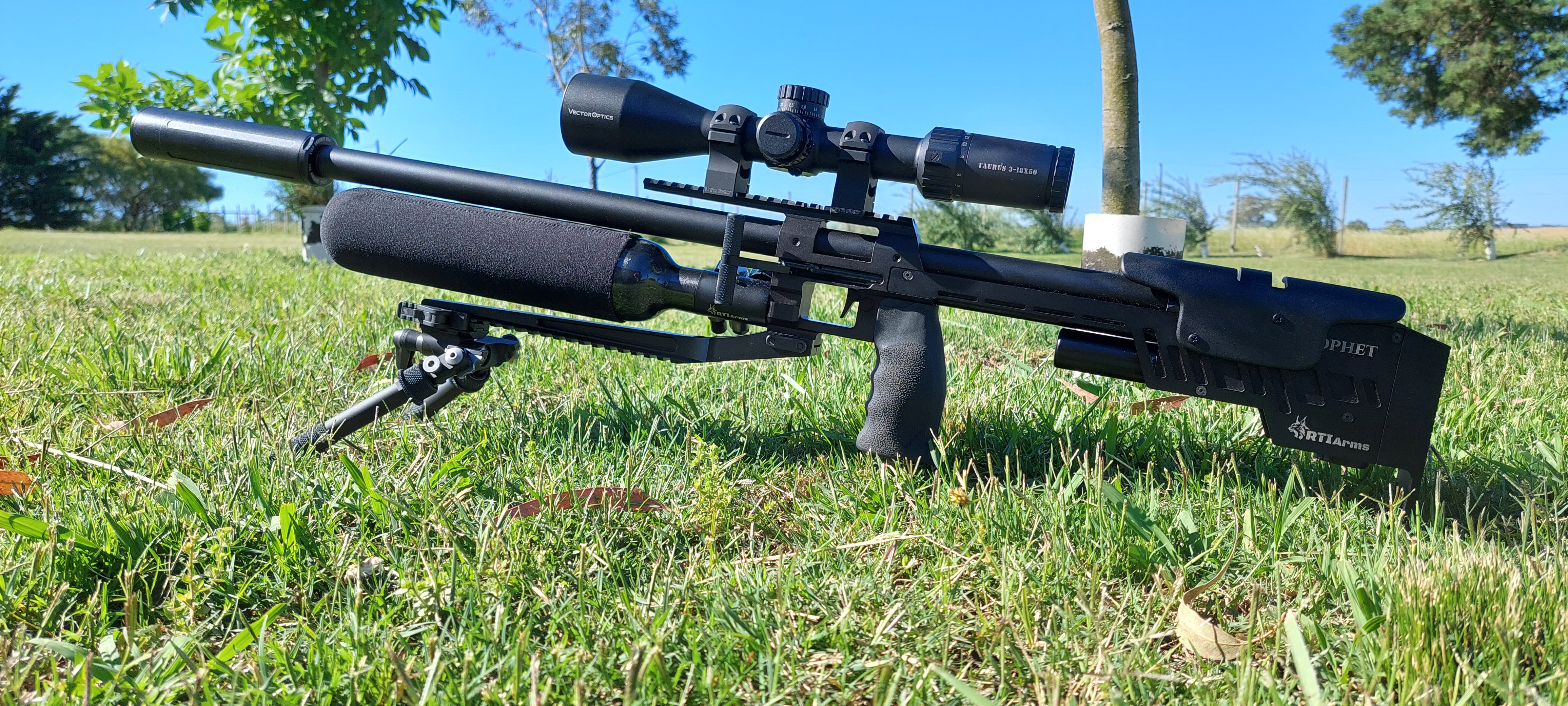

But I will ad a nice one of my setup later.

Looks awesome! Just one improvement to make it look factory: use black flathead screws and recess them in the plastic.
Believe me that I searched everywhere here in my country those flat head m3 longer screws but couldn't find it, those Philips screws kill my eyes , the stock ones are short for securing the cheek rest .I will keep searching, it's the last touch that I need .
