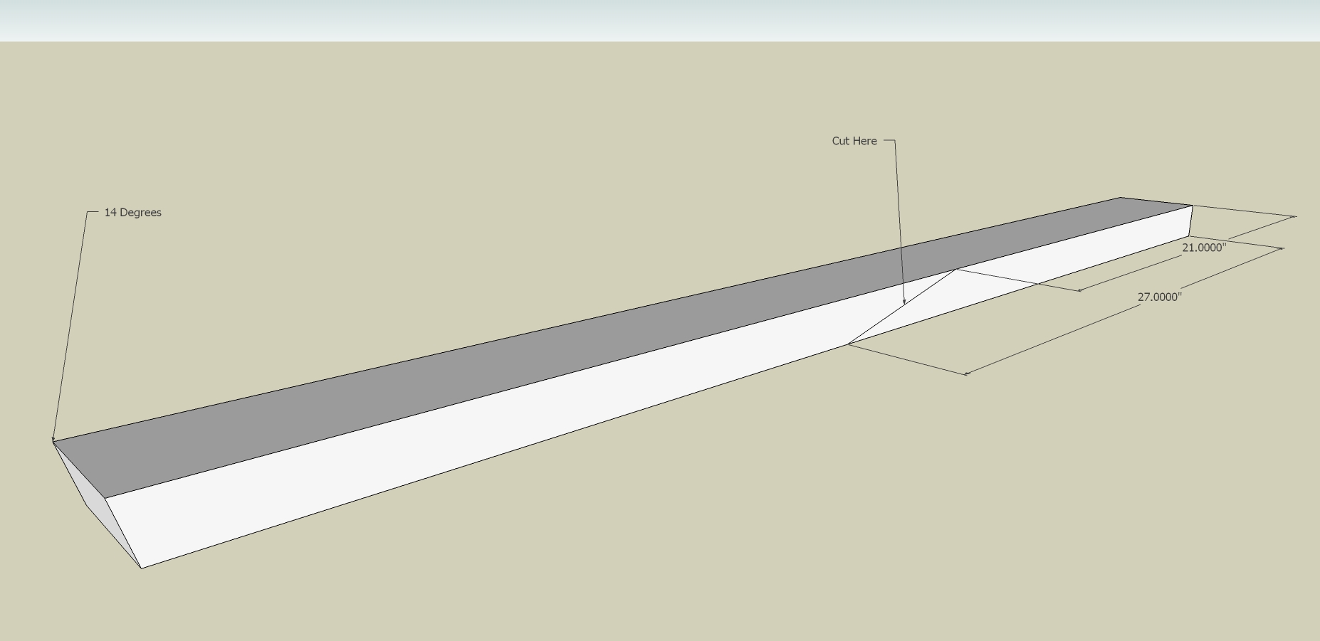

I started by marking the 2x4s along the short side at 21" and at 27" on the opposite side and drew a line across the two.
I used a miter saw to nip the tip of the boards at 15 degrees for the cant of the legs
I cut the boards widthwise to make two legs
Cut the other 2x4 the same way

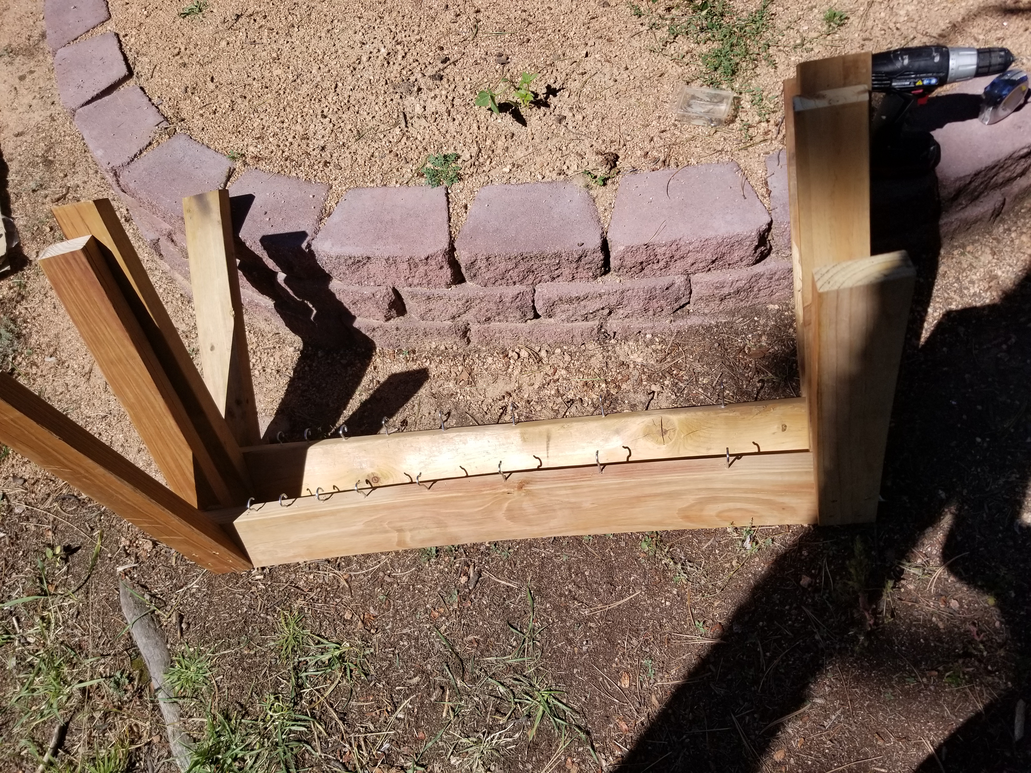

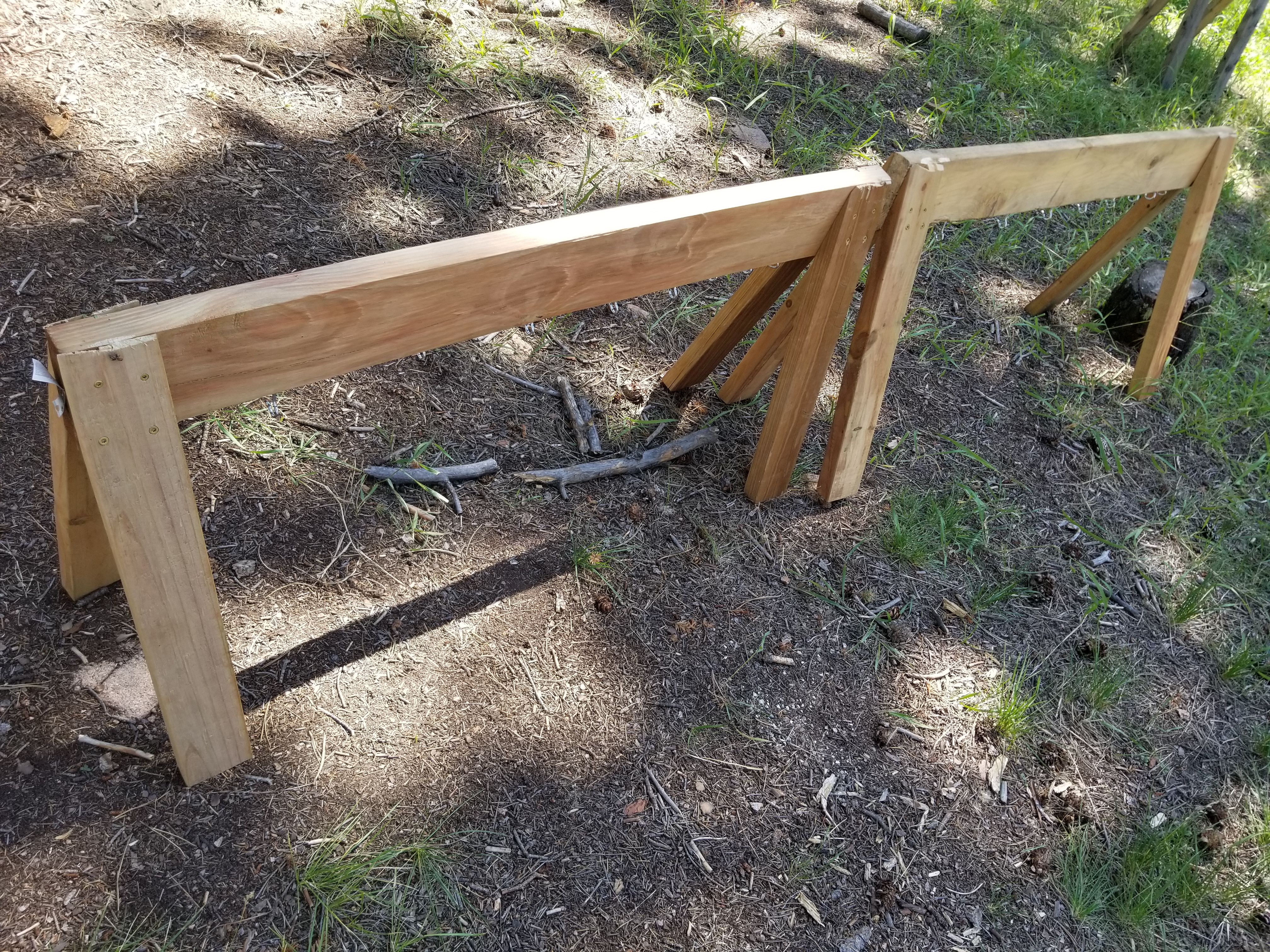

Screw to the 2x6 on the end using the 2" screws on top, and the 2 1/2" screws on the bottom
I used a reciprocating saw to trim the little 1/2" overhang on the top to neaten up the assembly

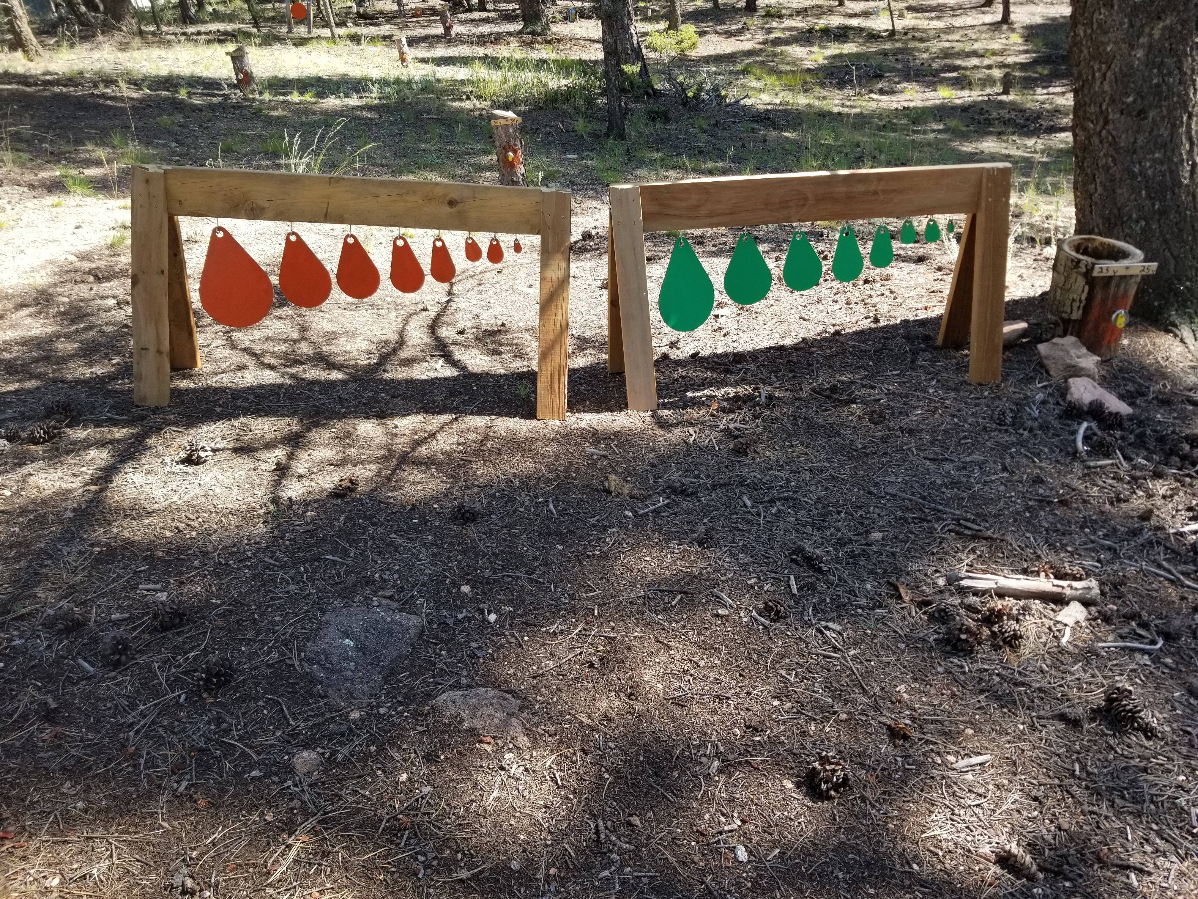

Install hooks on the bottom of the 2x6 spaced to accommodate the size of your targets like shown:
I painted one side Orange and the other side Green, and loaded the racks up.
I placed these at 25 yards, like the "Let's meet in the middle" speed challenge at RMAC this year. Now I am ready to challenge my son (Bwah, ha, ha, ha
