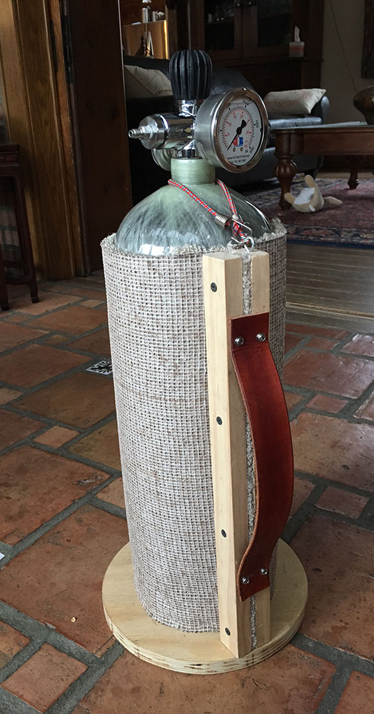

A few months ago I bought a "Great White" from Joe B. at airtanksforsale.com. I didn't want to spend an extra $100 for their protector/carrier which looked to me like it was worth about $10. So I put one together from scraps laying around the workroom for $0. Yeah, it might look a bit ghetto but it's very stable and at least as protective as the $100 one. It can be laid on its side and when filling can be easily pulled out to inspect the dates, etc..

Just a piece of carpet wrapped snug around and sandwiched between two 1x2 pieces of pine. On top of the wood base there is a smaller 3/4" thick wood disk screwed to the base and the bottom edge of the carpet is stapled into the edge of that. There's a piece of padding under the end of the tank. The little bungee at the top isn't really necessary but I use it to hold the end of the fill line and probe. I think there are a lot of low cost possibilities for protecting these tanks besides this one.
