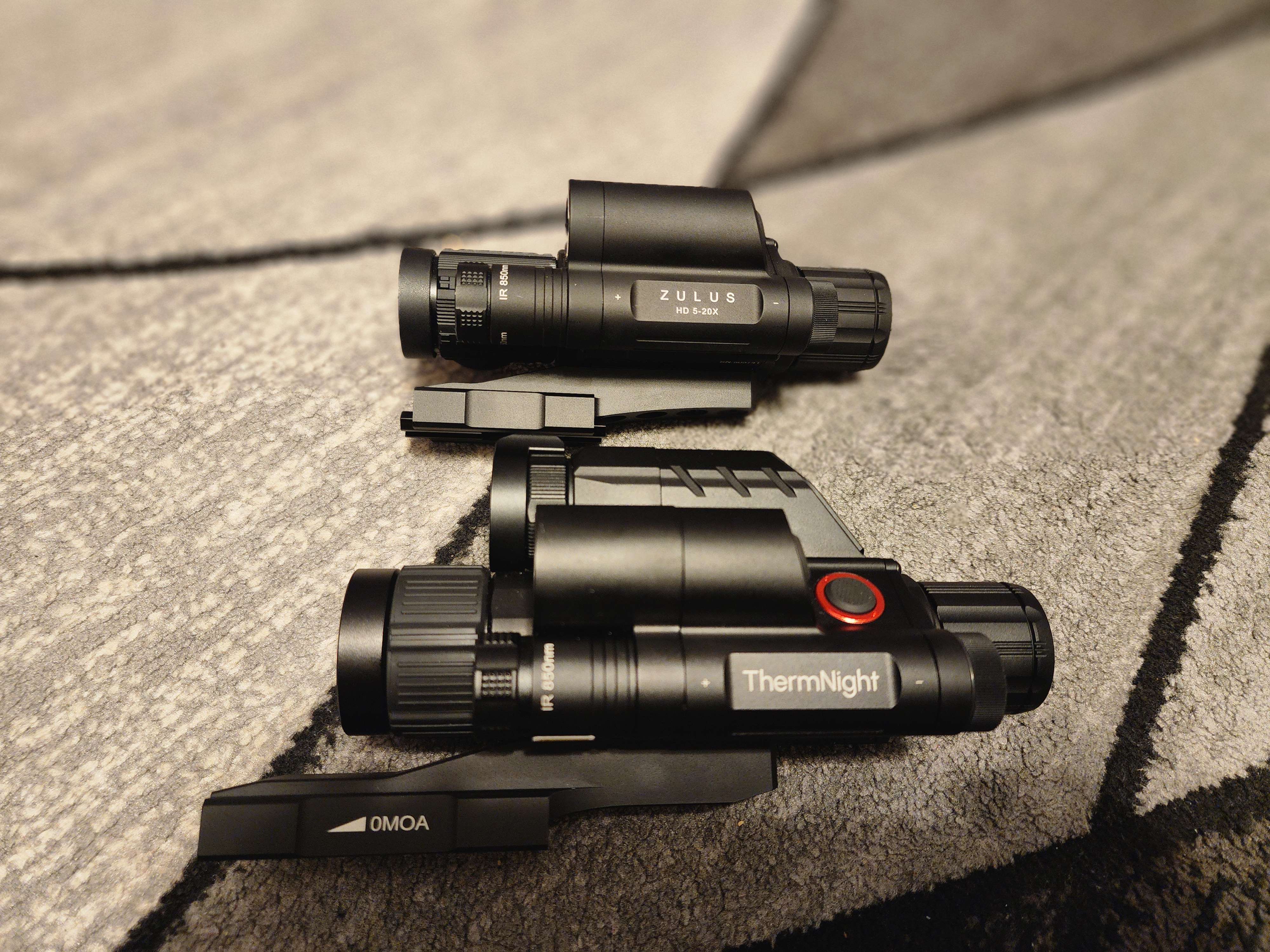

The Zulus is one of my favorites for a few reasons: compact size, everything built in, and it’s lightweight even with all the features it has. It is coming in with a weight of 22oz which includes the mount and battery. The ThermNight TNC225R follows that same lightweight trend and is only around 6oz more with a total weight of 28.50oz (including the mount and a battery). For a size comparison I added a picture below of both units side by side.

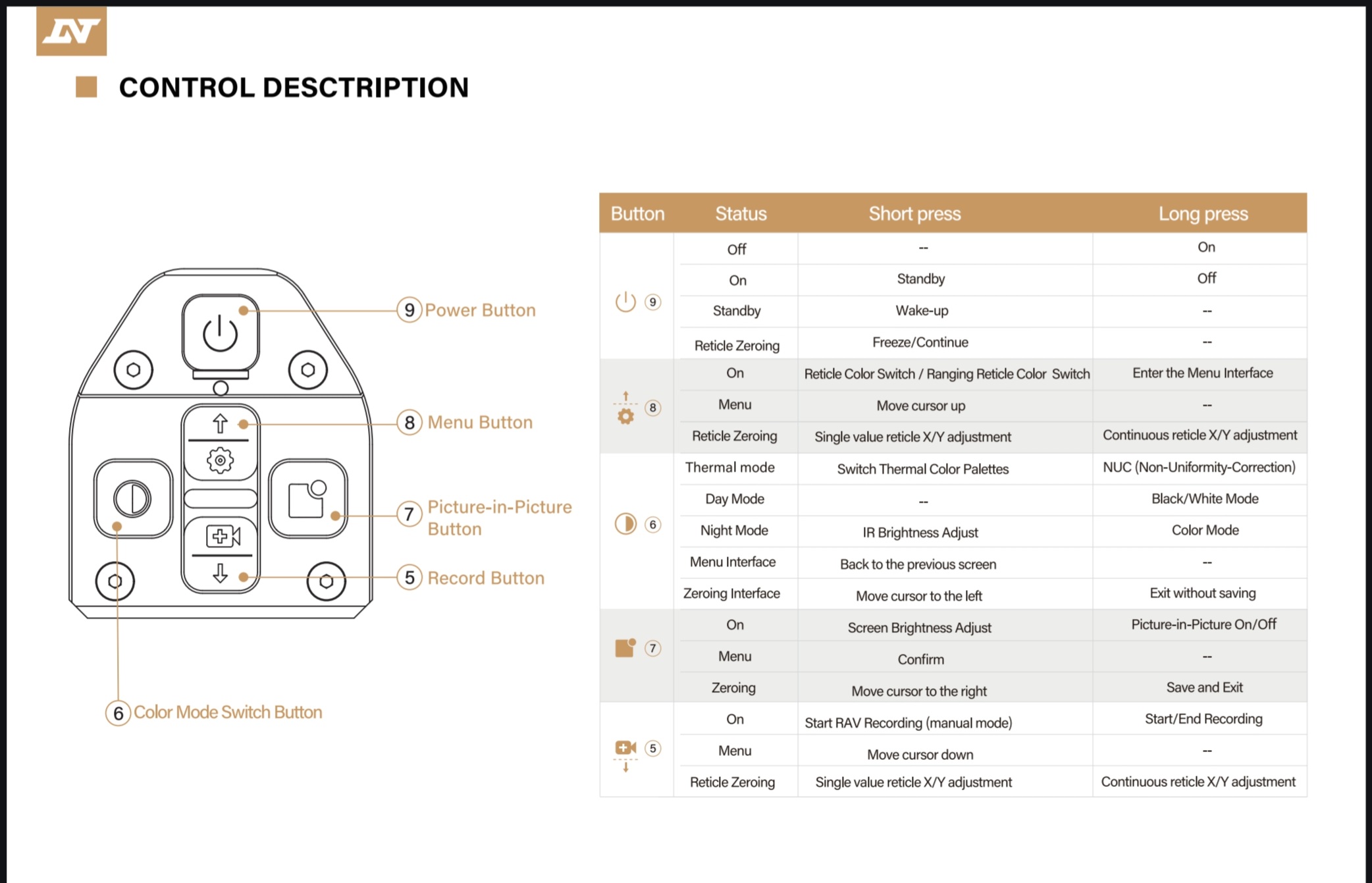

Next, we have the buttons and their functions attached. I also added a real picture of what you will see on the scope.

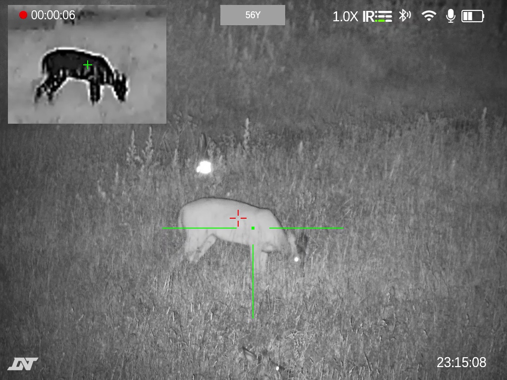

Since the ThermNight is a multispectral scope you will have the option to have the thermal as your main viewing screen or with a click of the side button you can make the digital image your main screen. After that you will have the option to turn on the PIP (Picture in Picture) mode and this will allow you to run both images at the same time, one in the main viewing screen and the other in the PIP window. You will be able to choose the location of the PIP window. Upper center, upper left or right corner. For me I like it in the upper left corner.

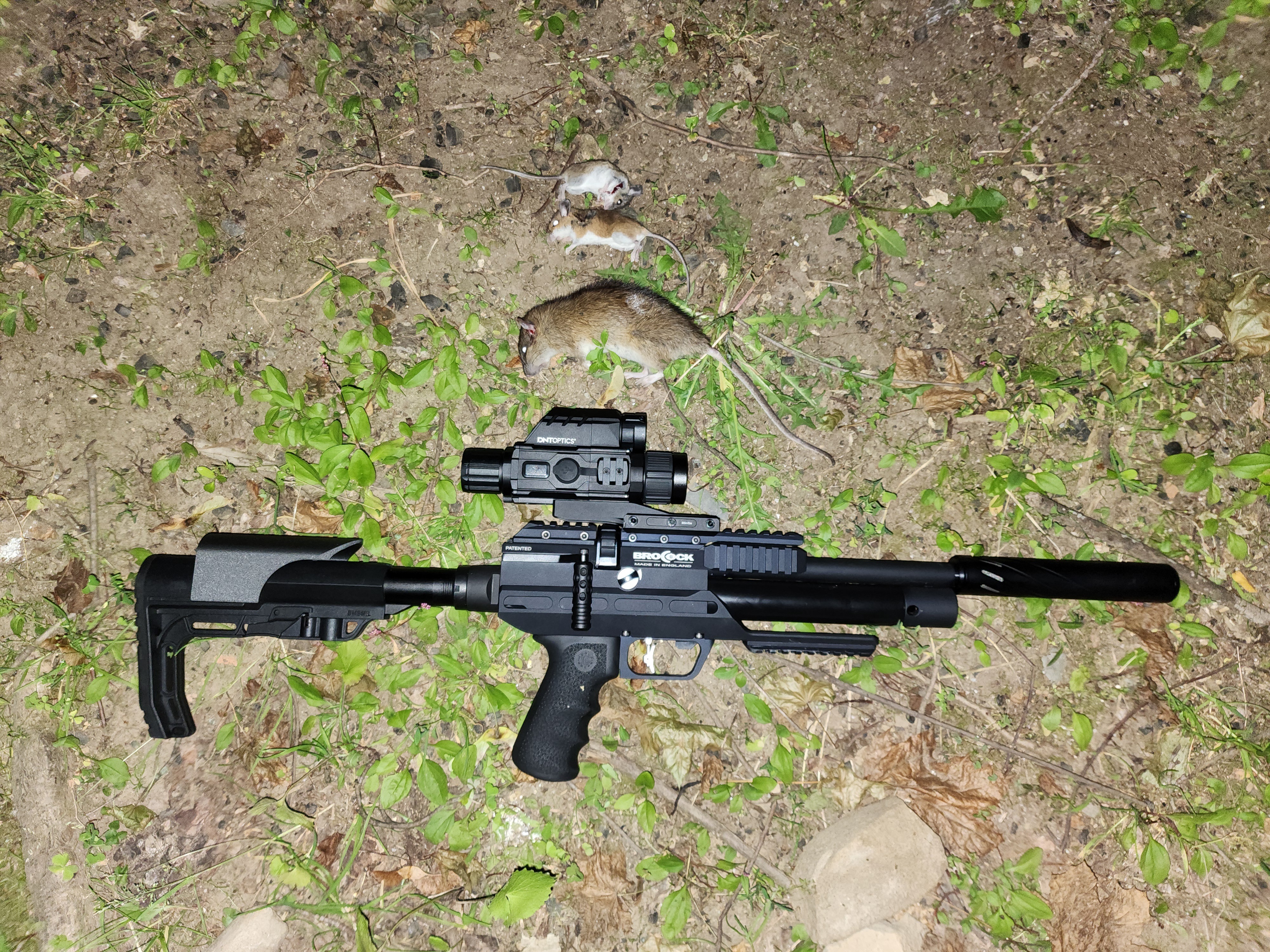

I have personally been using this device on my BRK Atomic in .177 which is set at 10fpe. Having a view of both the thermal and the digital all in one lets me get on target faster than ever. For me what I will do is scan with the thermal as my main screen while the digital is in the PIP, once I see the pest I’m after I swap it to have the digital in my main screen to take the shot.

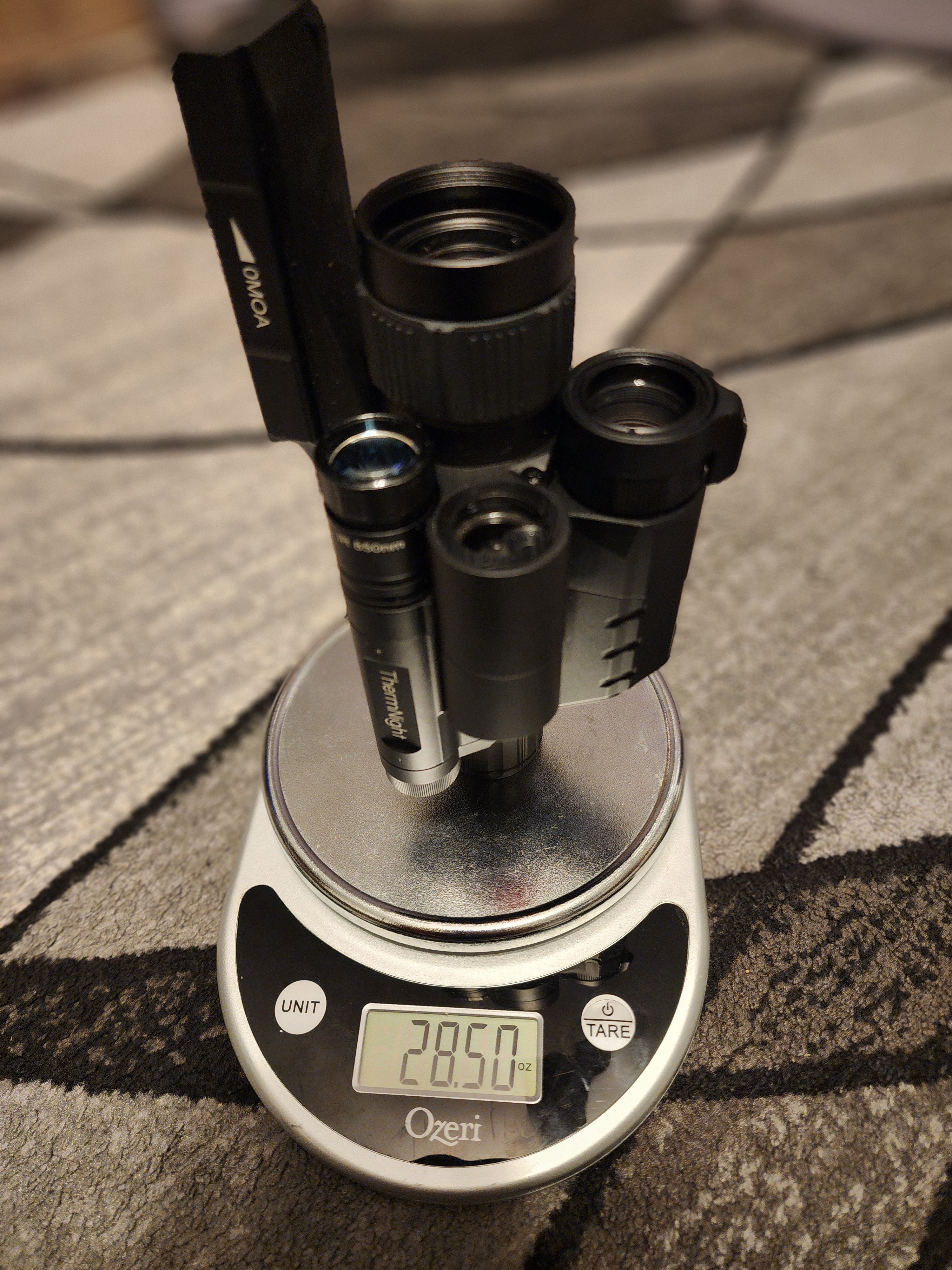

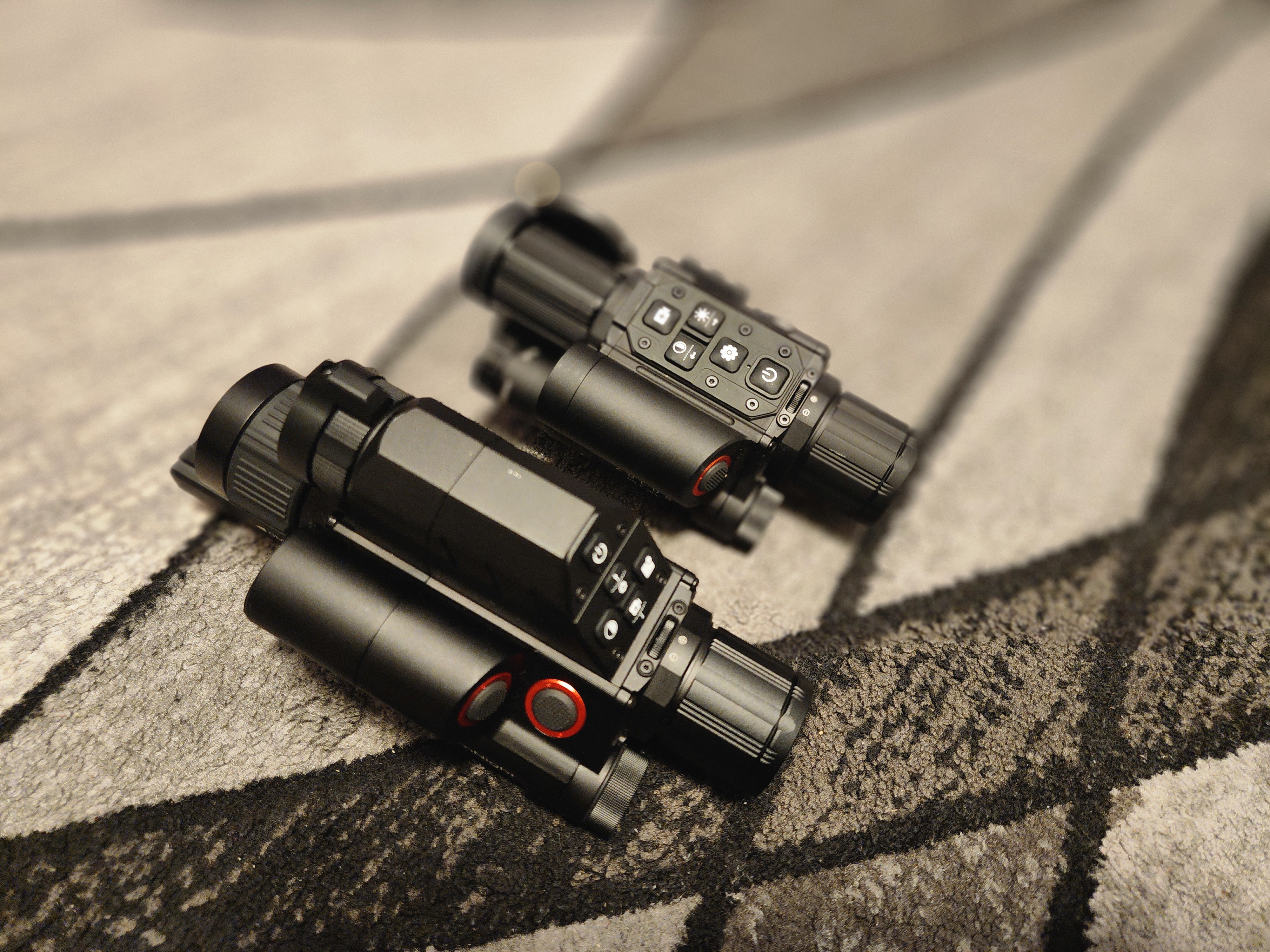

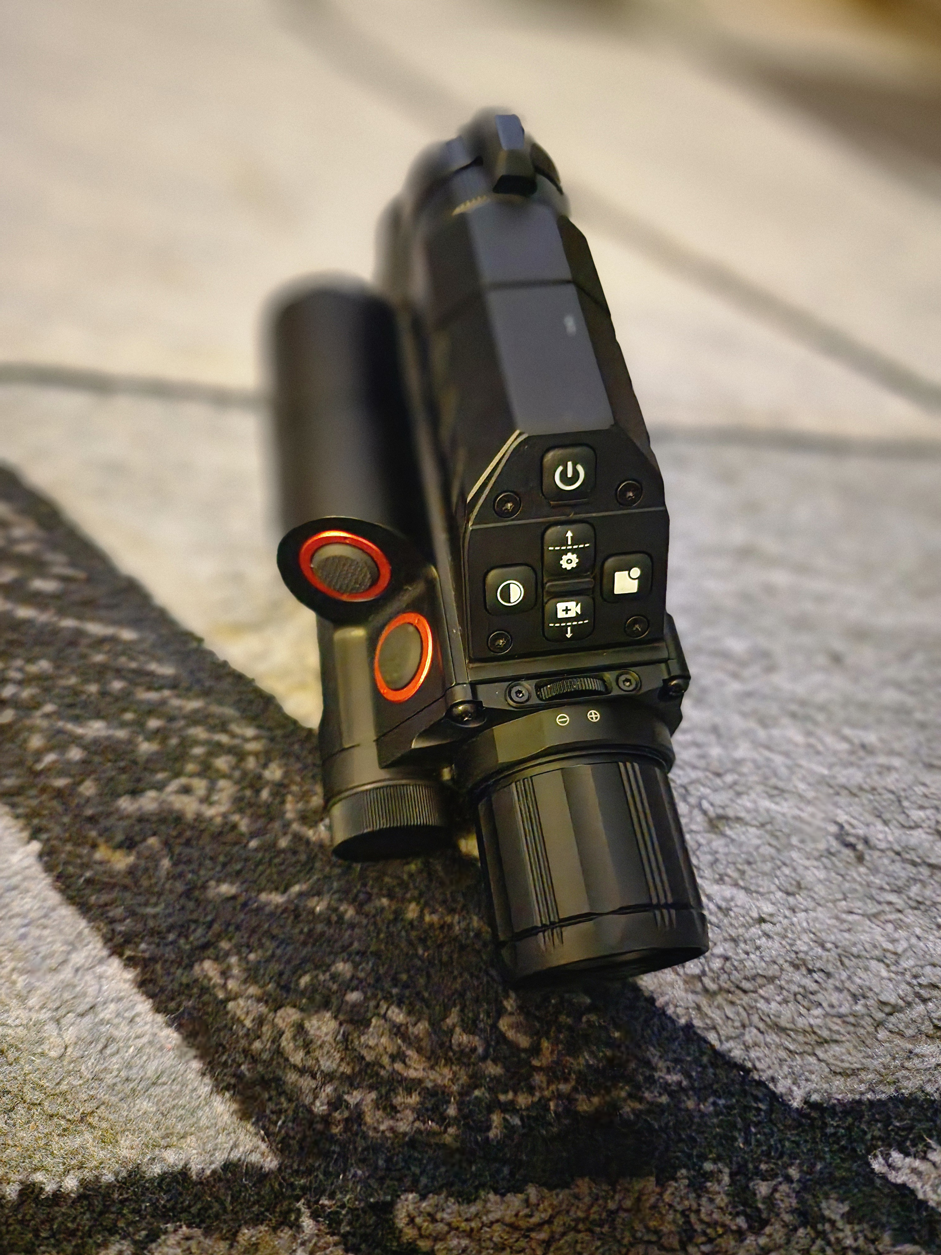

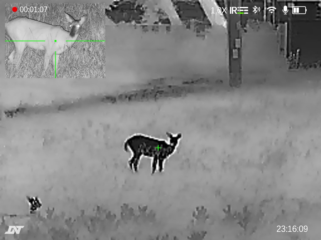

View attachment 480918View attachment 480919
In this next clip the you will see a heat signature of a canine at 145 yards with just the thermal that's all you can tell you would need to wait to see behavior to identify if it was a coyote. I go through the modes and than show the digital image and bam it was a clearly a dog yes it was a friend's dog and the ThermNight was mounted only on my tripod but you get it all the other clips below will show similar scenarios.
