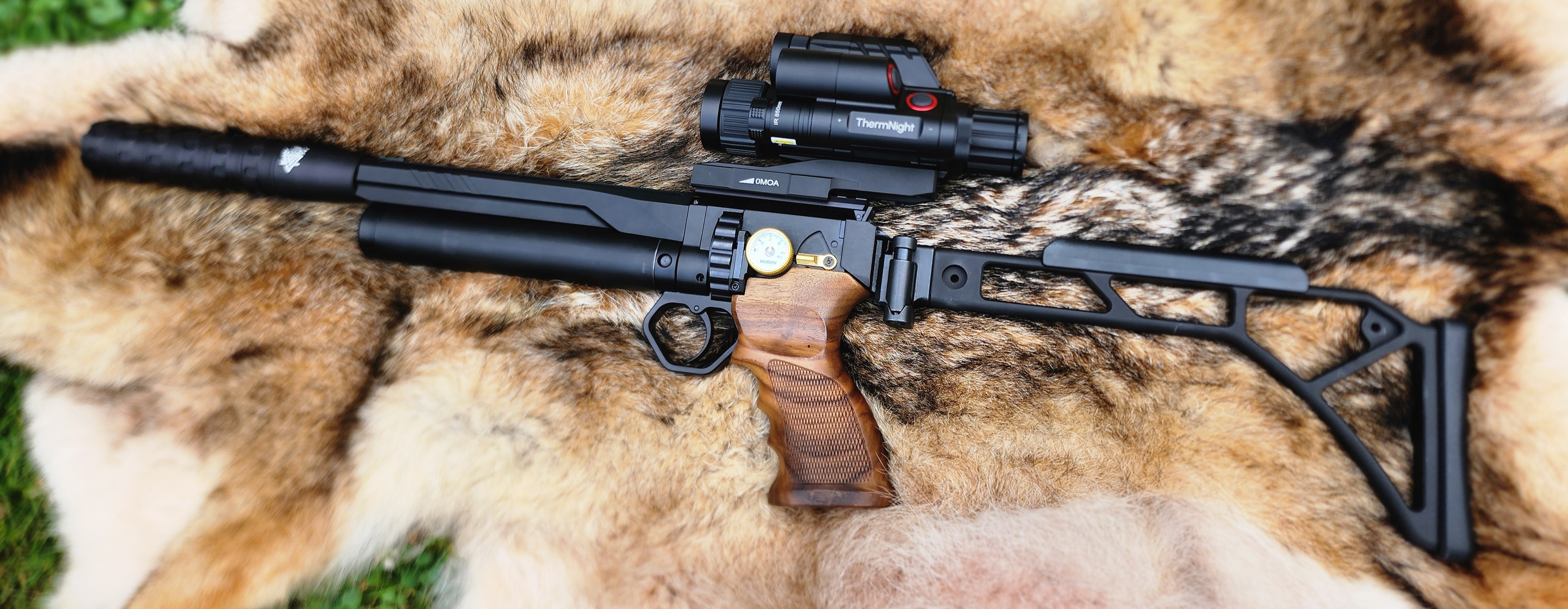

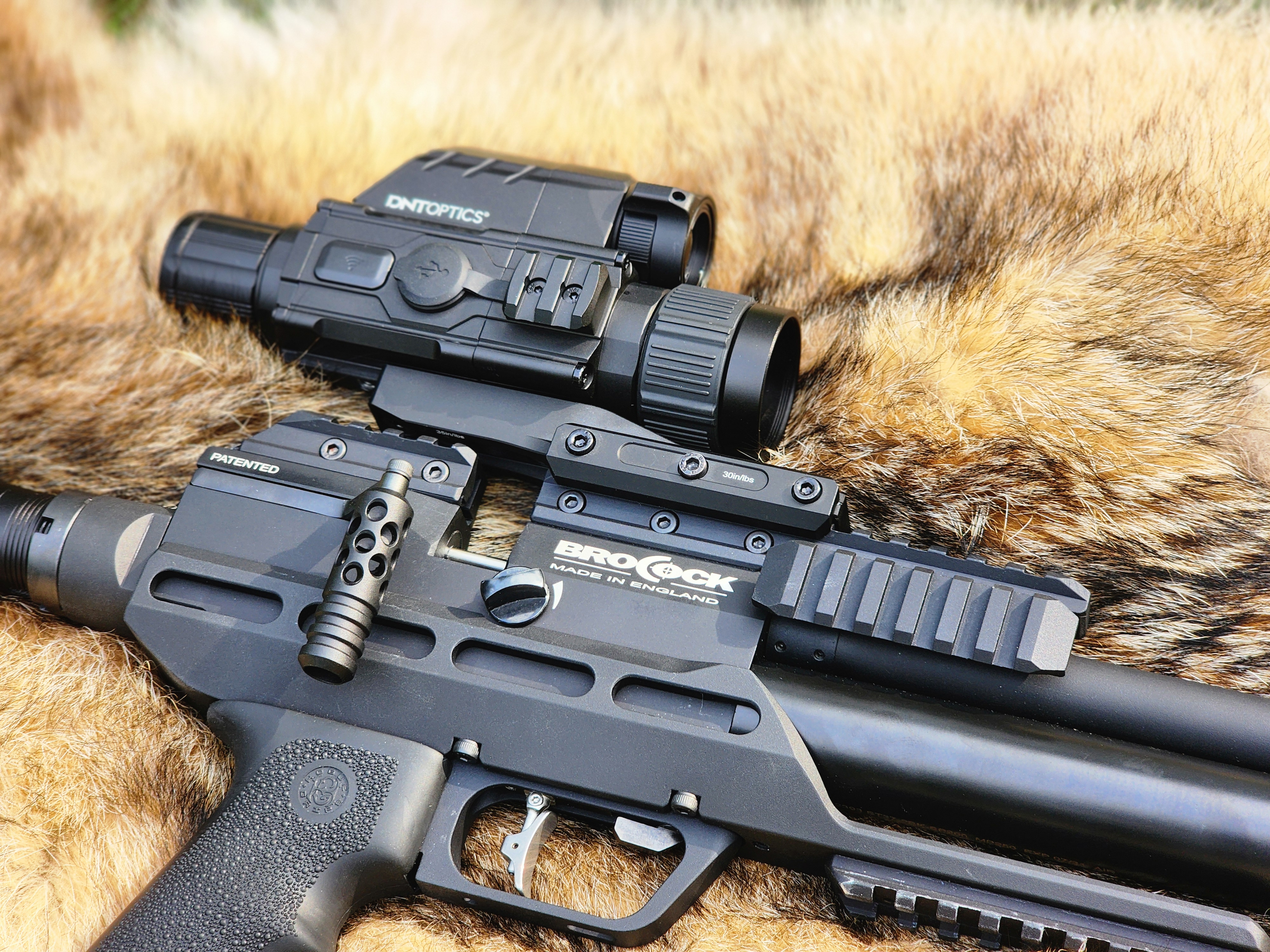

@Pfddi With the 0 MOA I was at the max which I think was -98 at 18 yds and still not zerod. With the 20 Moa which added an additional 1/2" of height I'm now "-11" on the Y

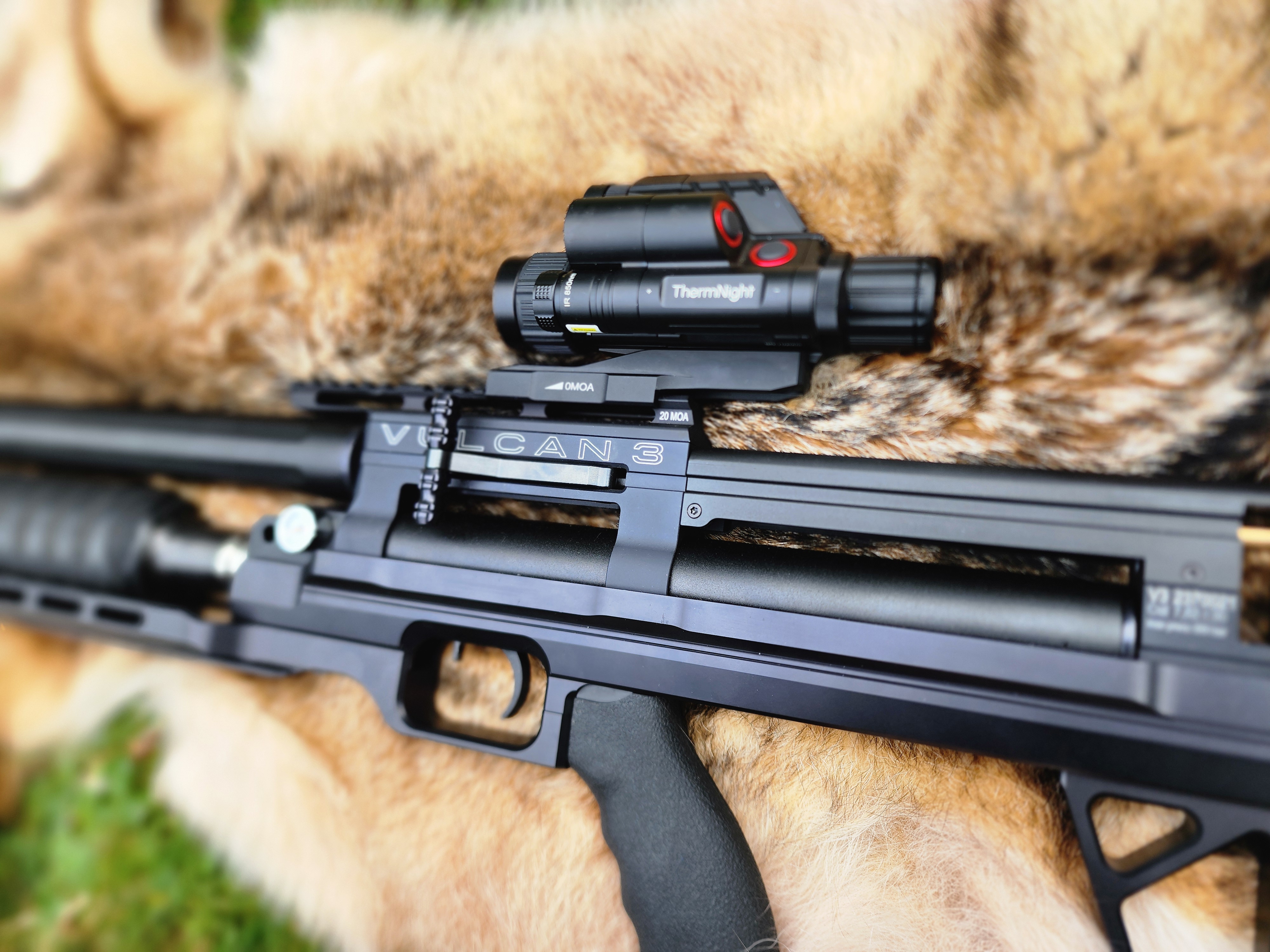

For some reason I've always had to shim every one of my digital/night Scopes on my air guns. They've always all shot too low. It's never taken much more than a small thin piece of brass to get it close to zero elevation. I have found that most of these night Scopes are not very airgun (magazine loaders) friendly for mounting. I wish somebody would come up with a better mounting system for airguns, like one that doesn't push the scope back so far. A simple mount that mounts the scope directly above the part that mounts to the rail would be nice.
@Coinwa - If you notice on the picture of mine above, I have the 0 MOA mount. I simply added 2 pieces of cut soda can on top of each other at the rear of the mount to add some lift and that made the difference. Not sure what the MOA is on my EVOL magnon, but the 2 pieces cut the Y axis down to 1/4 and now my reticle centers at all powers.
These Evol rails are already machined with a bunch of moa cant in them. I can see why other's are having issues with other guns needing an moa canted mount. But would using DNT's 35 moa mounting rail work better on the Evol to center things up?

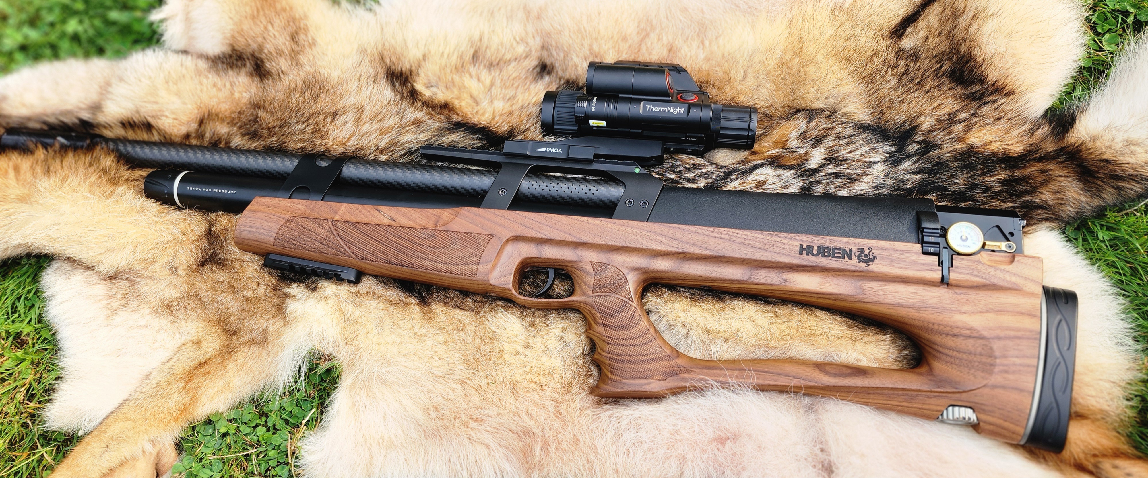

I’d rather work on shimming it. I’m sure it’ll be fine on the bullpups with full rails. It’s tough on any of the guns with a split-rail and magazine slot mid-ship.
If nothing else, I’m sure it’ll work fine on the .223 or 6 Creed for coyote work.

After getting creative with some scissors and a PBR can, I got it shimmed up pretty well and centered enough on low power. The largest part of the problem was the caddywhompus plastic pic rail behind the action on the Notos, that’s why it worked fairly well on the other guns.
Once I moved it to the front rail, and got the correct number of shims (2), things started falling in place quickly. These units are clearly made for the powder burning crowd (and it will be used in that application too)… so some experimentation will be in order for PCPs.

Ballistic Calculation is measured using the top digital lens I usually see 4"- 4.25". Are you saying not made for airguns because of the spilt mag? I find the split mag a pain like my BRK's but my flat tops are no issue. For this I am trying to get the extended mounts in as i would like more reach on the split rail systems.
Thanks Brawler… 4” is where everything jived well on the .30 Uragan this afternoon.
I’m not saying they won’t work, and work very well, on air rifles…. I’m saying the set-up will require a little extra diligence on an air rifle. The ranges are very compressed, which means you need to use a lot of adjustment to move a small amount.
I ended up needing to shim something or other in order to get stuff to end up near center on base magnification on all four rifles I tried it on. Right now, it’s at -71/-73… which is centered enough.
