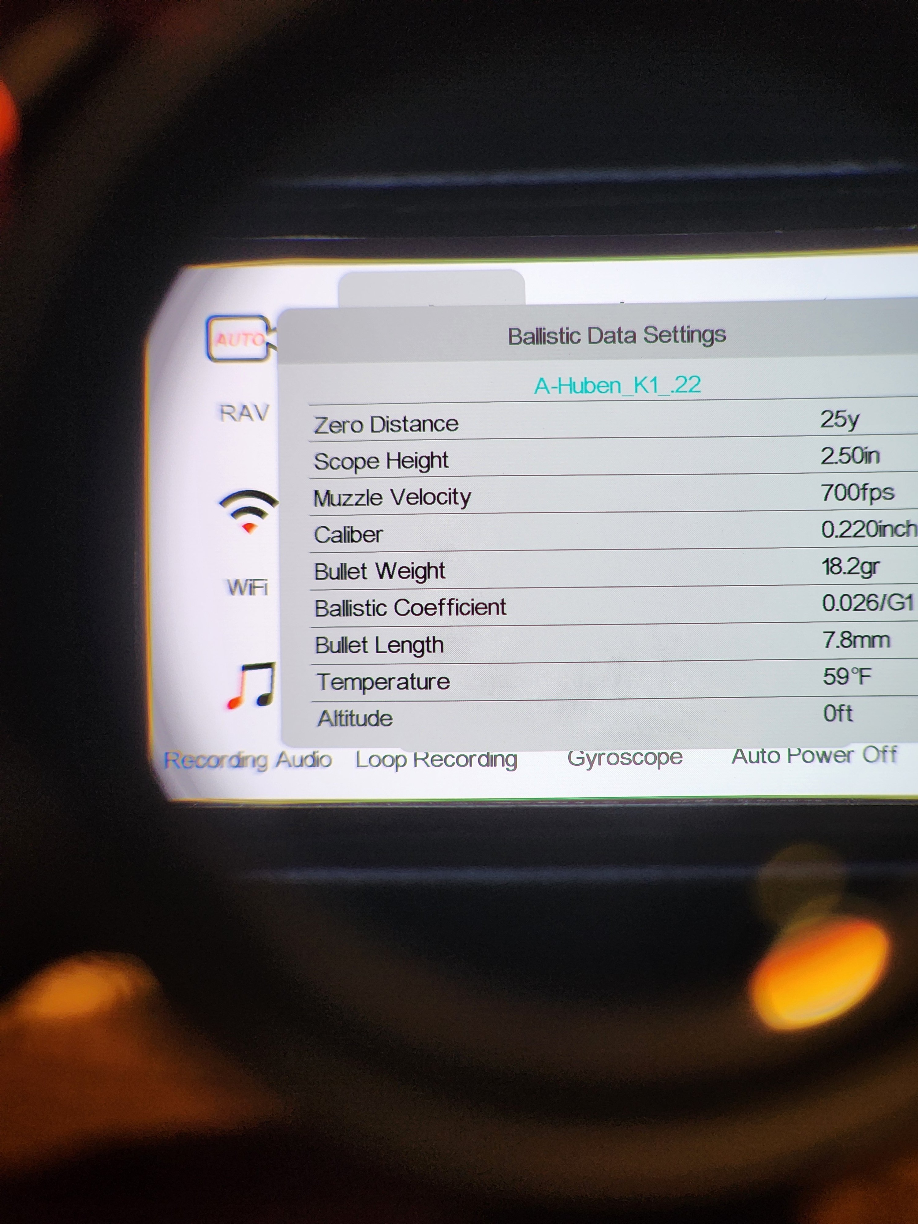

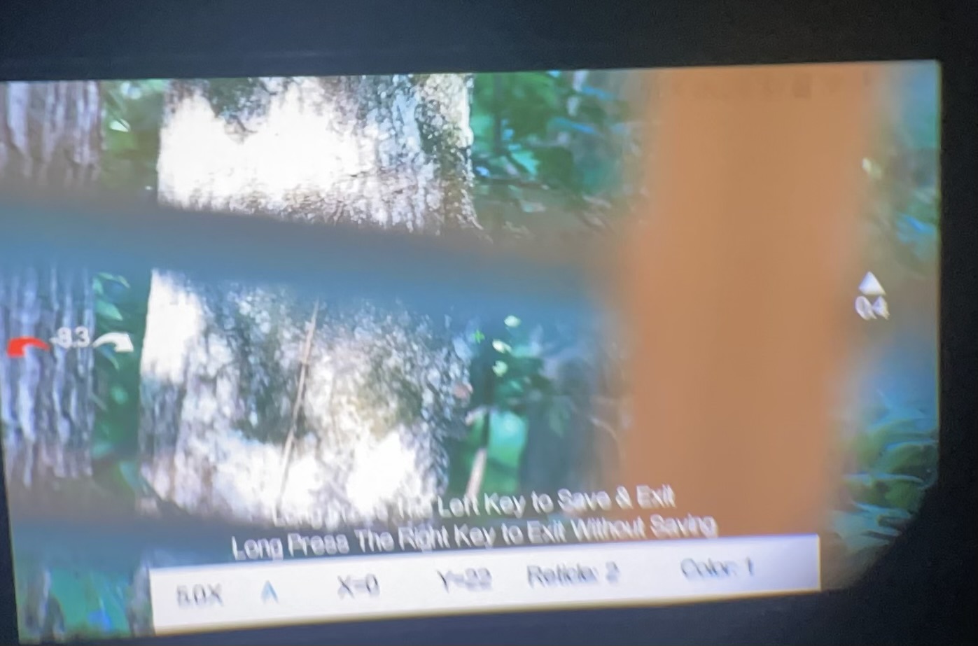

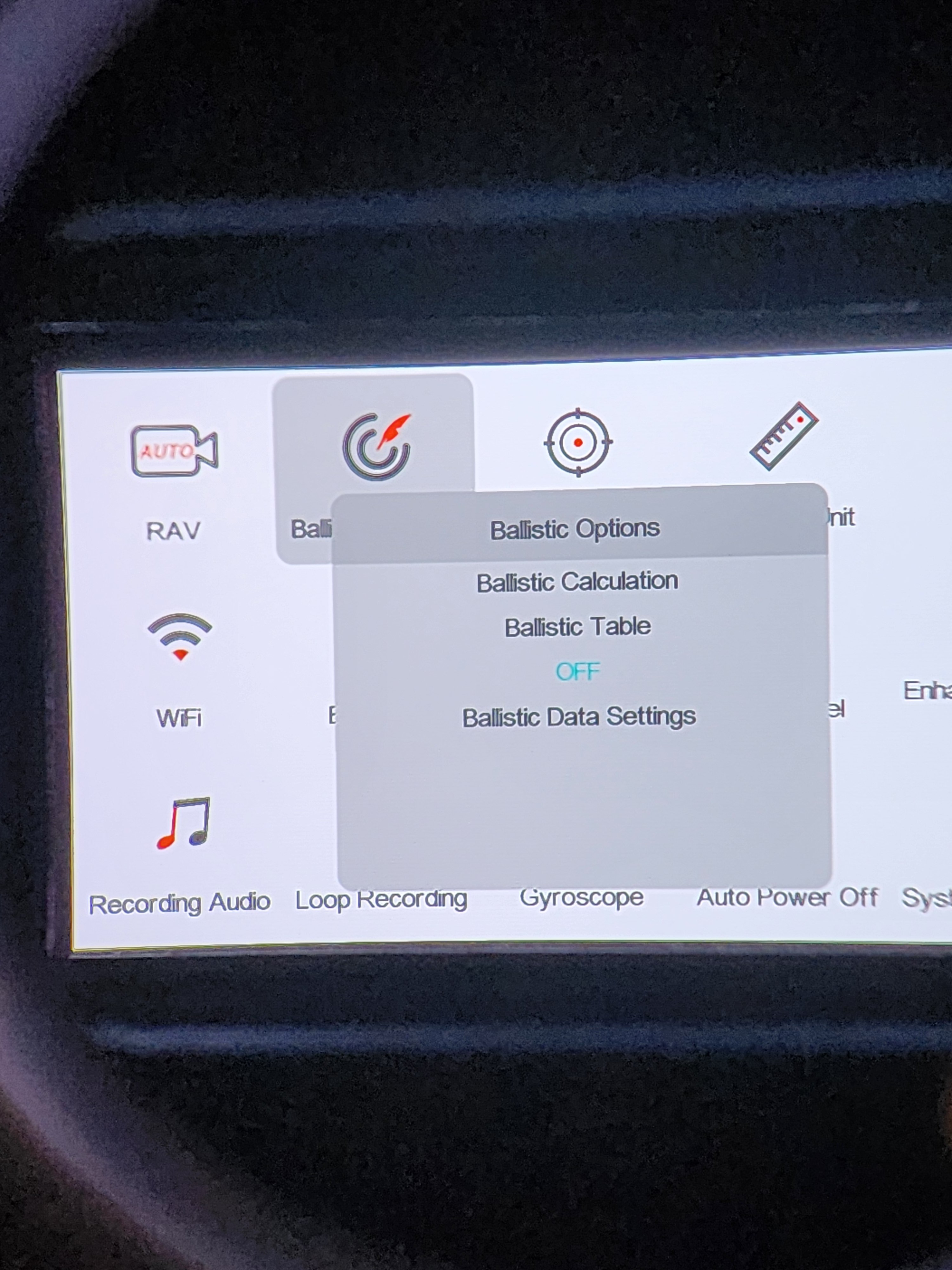

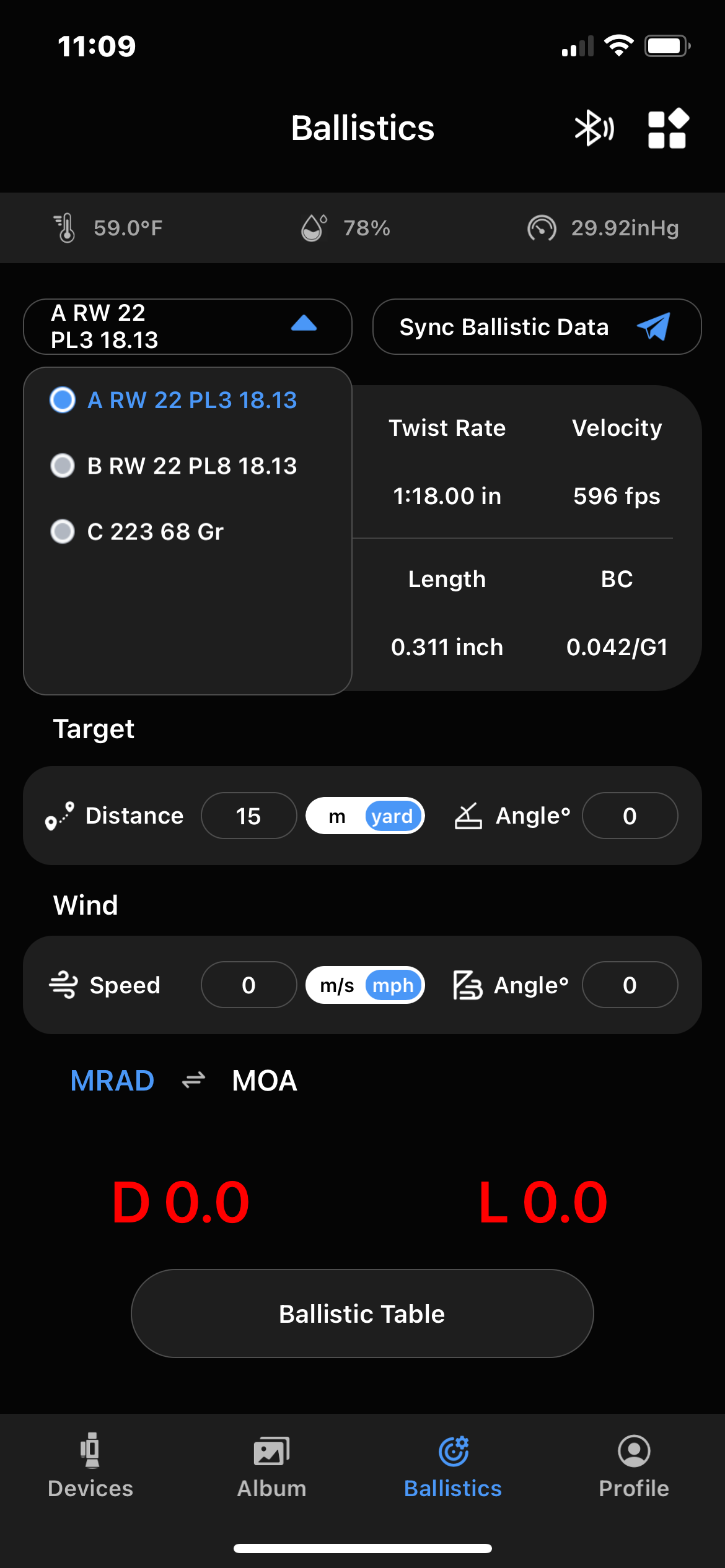

Are you talking about the zulus? If so yea you can save all 5 onto the scope and this is done while connected to wifi. Top right corner sync ballistic data that will pull up the A-E options that's your in scope profiles. Set those and make sure you are using ballistic calculation in the scope not table now. Also under that in the ballistic window you can see your profiles you sent over or you can edit directly in the scope now. LONG press left to save any changes.

Can you clarify this for me... I read in the Zulus manual that in the Ballistic Calculation mode, the scope needs to remain connected to the phone app via bluetooth, and the ballistic calculation from the LRF range is actually performed on the phone. In order to remain free of the phone bluetooth connection, the Ballistic Table mode needs to be used (and so restricted to 1 profile/table at a time). Is this still accurate?
The phone doesn’t need to be connected to the scope. you sync your Bc to the scope. I have a Red wolf with Helliboard I can switch from one power level to another then change settings in ballistic options and switch profiles, no phone connection
That's interesting, it contradicts what's printed in the manual for this ballistic mode.
I have my printed copy, and the PDF from the UK site.
But you're right, I tried it and it does work. Seems like the new FW added an onboard calculator. Nice!
I think with the new firmware update this just changed where as before you had to be connected with your phone. Sounds like you cam have 5 different ones in the scope now without the need to have your phone connected. So the manual is "outdated" for this now.
Not here anyway.
You can download the manual here page 19 talks about the in scope ballistics. Sending it over the phone via wifi is not covered. If you need any help or further explanation feel free to send me a message.
