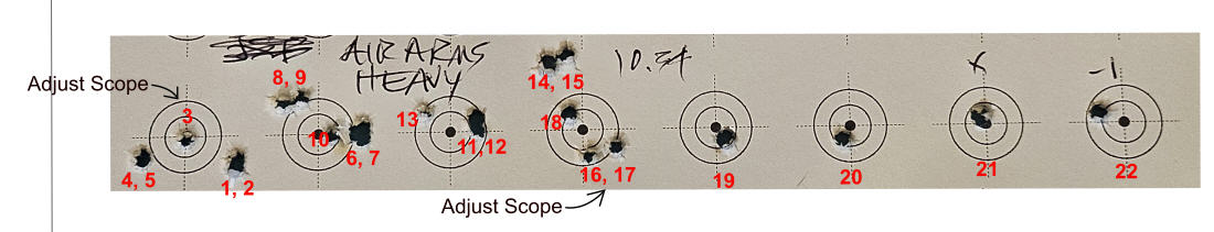

The image below illustrates a puzzling shift in poi. It's not the worst I've seen but it is a decent illustration. I was changing from shooting JSB 8.44 pellets to the heavy 10.34 grain pellets and re-zeroing the scope. It had been shooting normally for about thirty shots prior to this change. I've numbered the shots I took as I worked on zeroing the scope for the heavier pellet. I made an initial vertical adjustment of about 7 clicks to account for the bigger drop then started shooting. See the image below to track the process. I made one adjustment after the first two shots were right on top of one another. Then there were a lot of rather random seeming shots as I tried to confirm the adjustment. Then suddenly on shot 14 and 15 the POI jumps up a good two MOA. After the second one hit in the same spot I adjusted the scope back down and took a number of more shots to try to confirm that change. I finally got tired of messing with the zero and started shooting individual shots at the remaining targets. I shot at least 25 individual shots, all of which were pretty much on target.
So what would explain that big shift and then a solid consistent zero? The scope rings were torqued to spec. The rifle is shooting a reasonable consistent muzzle velocity. How do I explain a two MOA shift?

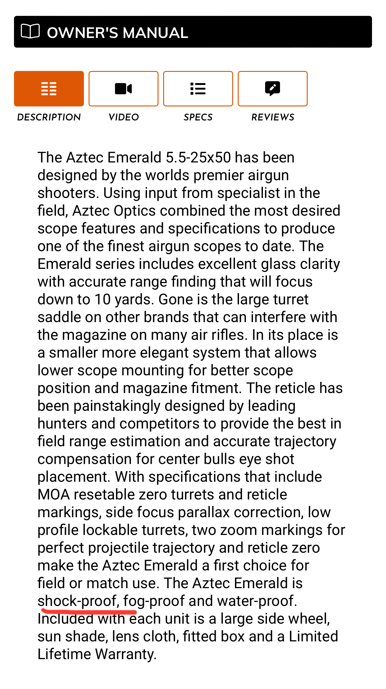

Is this scope rated for springers?
From deducing that this gun has broken this scope model already once, and then likely again, it appears it may not be?
-Matt
Yes, the scope is rated for springers. I'm still trying to figure out if the problem is the scope or something else. It seems unlikely that two springer rated scopes with a lifetime warranty would fail so I'm looking for other causes.

'Shock proof' doesn't necessitate that its springer rated or will survive long term on springers. However if the manufacturer states they're springer rated, and you come to the conclusion your hw97 is damaging them, I would personally assume the manufacturer is just...wrong, warranty it again, and keep it off springers or sell it, there is a decent knowledge base as to what scopes can handle springers with some google-fu.

@Cmiller Where did you find this information? On the AOA site, I only read that it is a shockproof rated scope. AOA is the main shop I have seen promoting this brand.
I do not believe that “shockproof” means “springer rated.” I’m under the impression that the term corresponds to an unspecified recoil rating with a caliber/cartridge limit.
Below is a link to Aztec Emerald Owner’s Manual. I may have missed something, but I didn’t see anything about shockproof or a springer rating after glossing over the owner’s manual. Based upon what I’ve read in these two links, I conclude that you’re probably tearing up a scope that’s not built to be used on the type of gun you’re mounting them on.
I suggest that you consider visiting and searching through some AGN threads in the “Traditional Airguns” forum to see what other springer owners and competitors use for reliable springer rated optics.

@Cmiller Where did you find this information? On the AOA site, I only read that it is a shock or off rated scope. AOA is the main shop I have seen promoting this brand.
When I spoke to AOA, they indicated that the scope is rated for springers, but I will confirm this.
