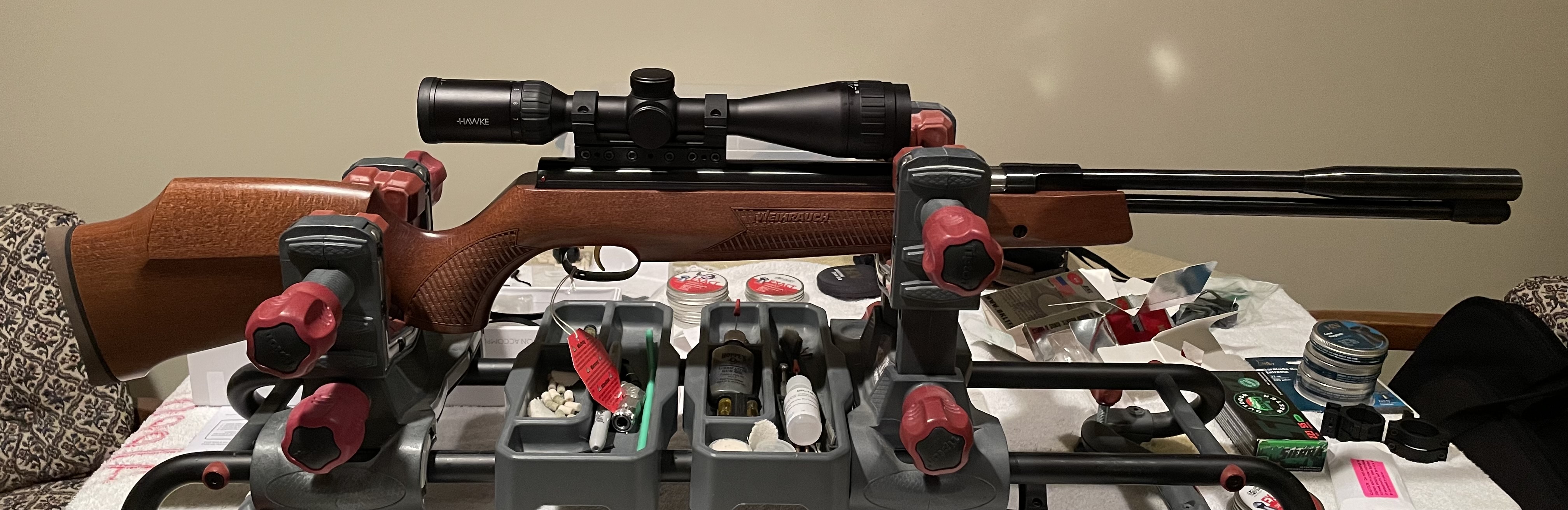

@Cmiller I have bad news and I agree with @Ezana4CE - sounds like a scope issue.
The good news is Hawke has a great scope that is on sale that I use on my .20 HW97k with great success. BKL 260 droop mount and the scope stays in the center of the elevation. Awesome mount.
Here is my setup. I got totally lucky on how low the scope sits on the rifle. Great mount.
Edit: I need to add a white spacer on the buttstock to enhance accuracy.

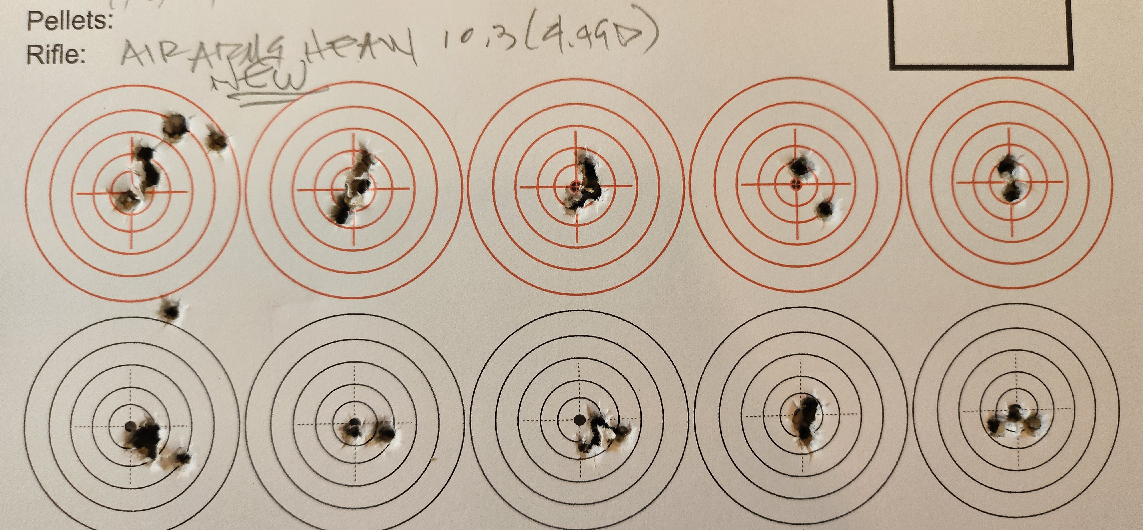

Also found pellet my gun really likes. Air Arms Field Heavy. They worked great before and a new batch is just as good. 25 yards off a bench. Top left was zeroing. Three shot groups so several through the same hole.

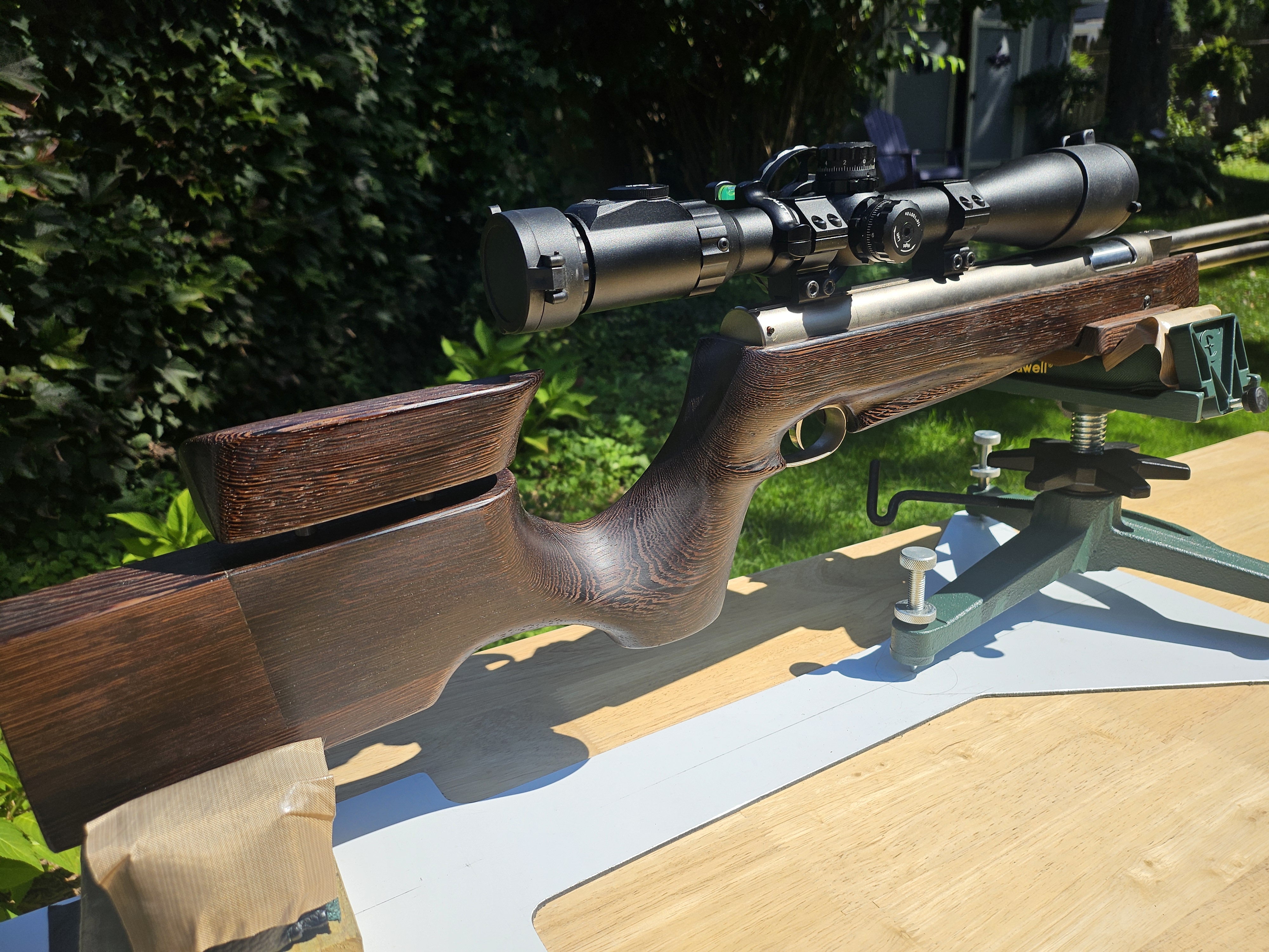

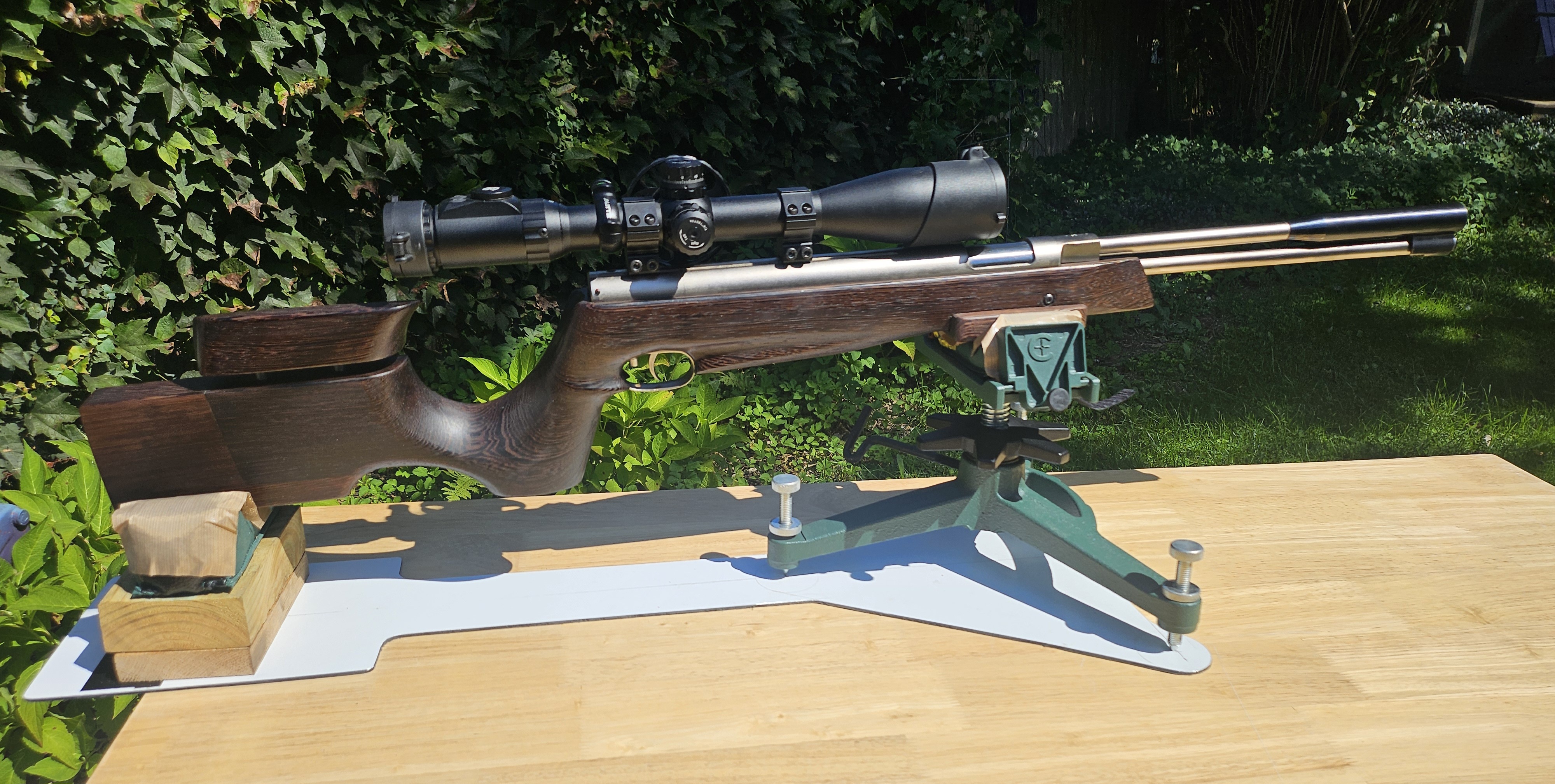

You did try it, twice...yea? I can't follow your train of thought, however...if I were you I would warranty it and use it on a non-springer or resell it.
Gorgeous stock by the way, stunning.
