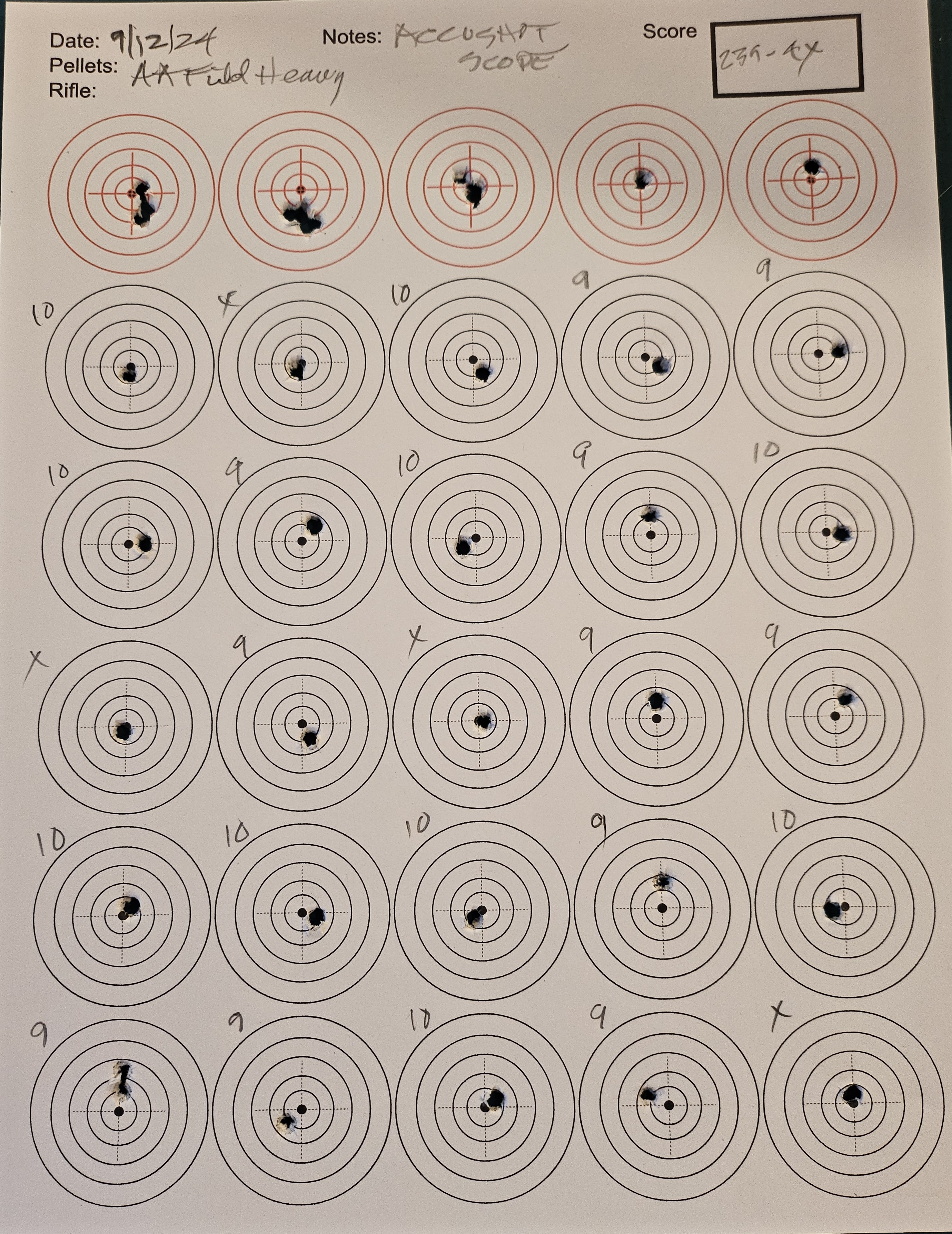

Well I'm still going around and around about that scope. I shot my cheaper Accushot scope for days and it seemed reliably solid. No big shifts at all. I switched back to the Aztec and found myself chasing smaller but constant shifts in poi. I'd be right on for several shots then the poi would shift a few clicks in one direction or another. I'd think I had pulled a shot but the next several go in the same place. I make an adjustment and hit a perfect x. A handful of shots later and it shifts again.
I would blame the scope and go back to the Accushot. I'm drilling the centers of the bull but then the poi creeps a few clicks. I make an adjustment after a few shots and I'm back in the bull again. And on and on.
Is this normal? Do you expect to be chasing your zero throughout a card? I've always assumed that when you zero a scope then all you should have to do is shoot well. I almost always find I have to watch for shifts and make adjustments to either the scope or my aim point. It's really frustrating when I feel like I can absolutely drill out the x if I know where to aim.
Here's tonight's card. I had to make three shifts in my aim point in 25 shots.

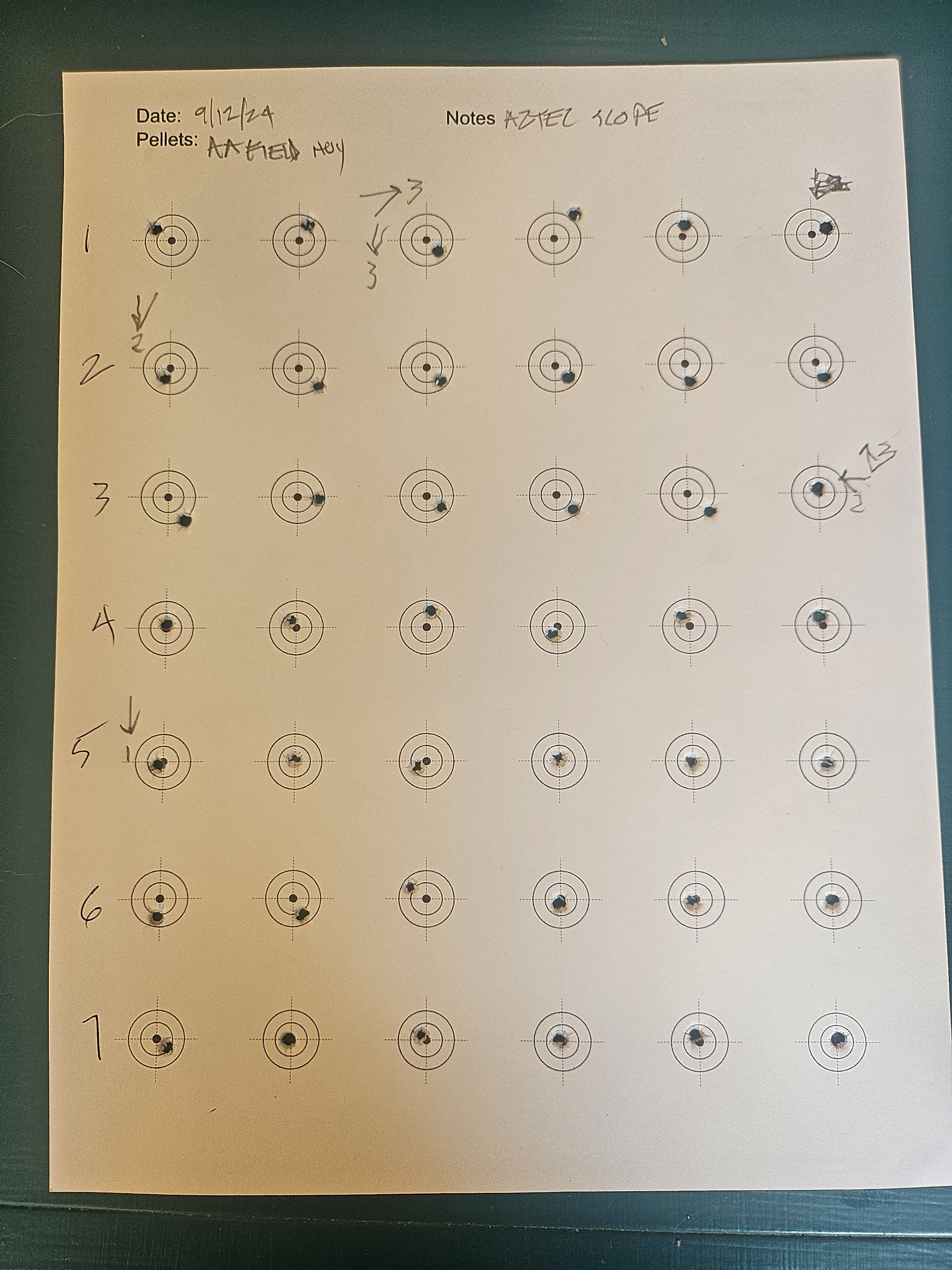

Today I was able to clearly document the problem I'm having. Shot a bunch of targets from 25 yards on the bench. Top row I'm trying to zero. Finally give up at the start of row 2. The scope immediately shifts low right. I kept shooting the bull and every shot goes exactly in the same place.
On row 5 i finally adjusted the scope and got back on center. There are 3 weird shots on row 6 but everything else is either an x or a 10. The problem is clearly not me or the gun. This is the most precise shooting I've ever seen from any gun I've owned.
Now, can I find a scope that will stay still?

Lol... If I shot all that at 20y with my HW I'd be ok with it .. lol
.. 🥴. I'd be blaming me , my hold or the wind ..

I've been doing the same. I've kept working on it because my instinct was telling me that the gun was great. I never felt like i was throwing those pellets all over. This card makes it clear to me that it's not me or the gun.
