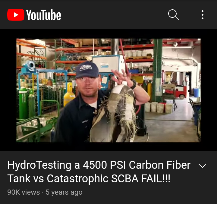

Must not look too hard.. one of the dive shops i used has pictures of them that spit there bits and holes in the wall then the tanks that did as lesson examples..

Ok.. then that aluminum liner woud be of concern id guess . Never had carbon tanks ..so? Maybe why its not dot'ed?
Hate to be filling this up in the house or standing close around to it.
Yup I saw that video aint no joke if it blows.

@Mo-Ron, I'm a certified hydrotest tech. Have been for 35 years. I saw that video QUITE a while back. YES, that CAN happen. The LIKELIHOOD of it happening is close to nil, IF the tanks have not been physically abused by getting too hot or through stupidity of not being cautious of how they're handled. In 35 years I've NEVER seen it happen or personally know anyone who has! There's about a 7,000psi margin of safety built in. So, in my PROFESSIONAL opinion, I'm OK with "playing the odds" against it happening. EVERYONE has to make their own choices. High Pressure Air needs to be handled safely and with common sense ("There's nothing COMMON about common sense" - Benj. Franklin)
