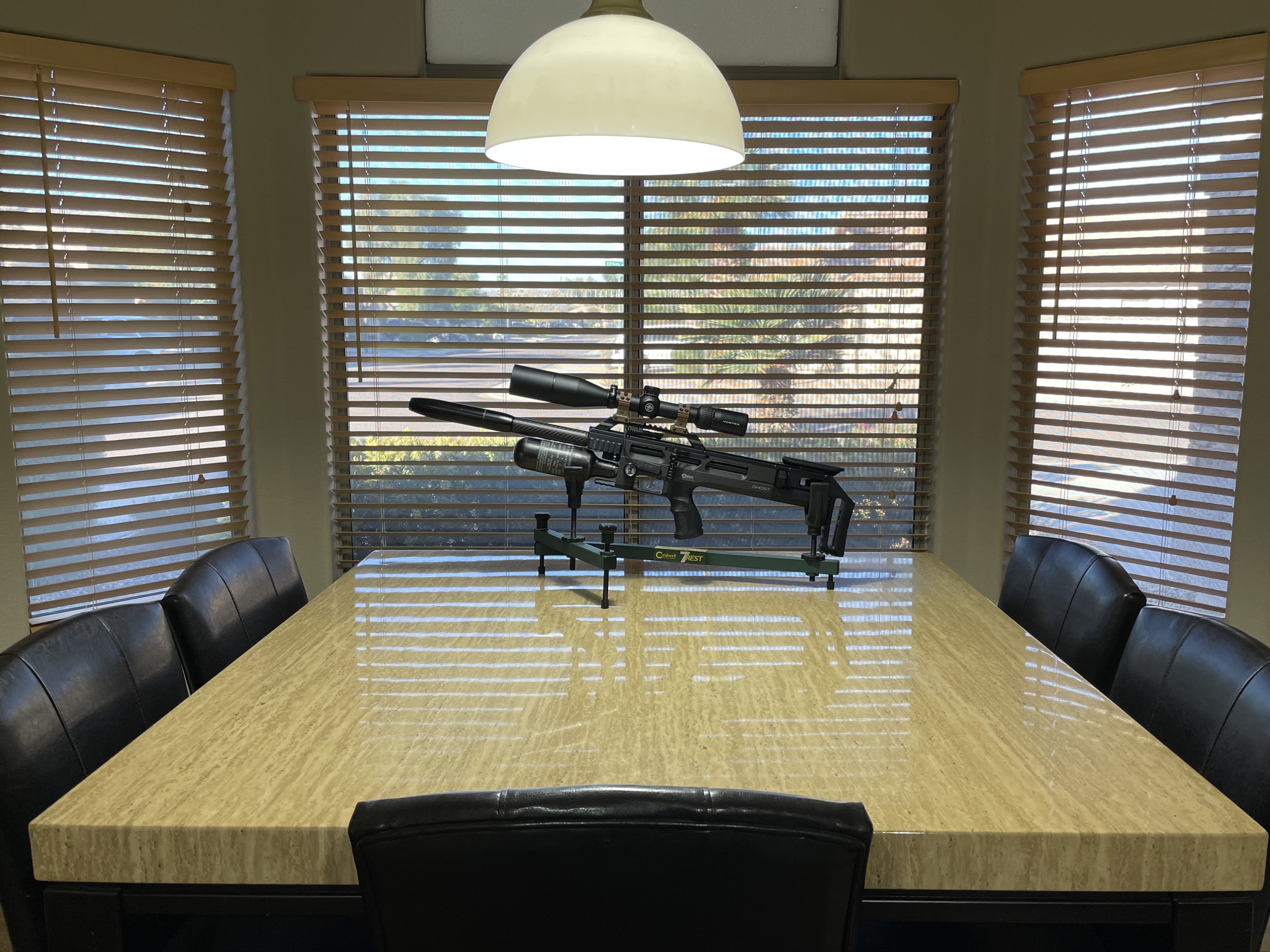

Here's a photo of my Ghost that I took on this beautiful Sunday morning in the valley of the sun:
