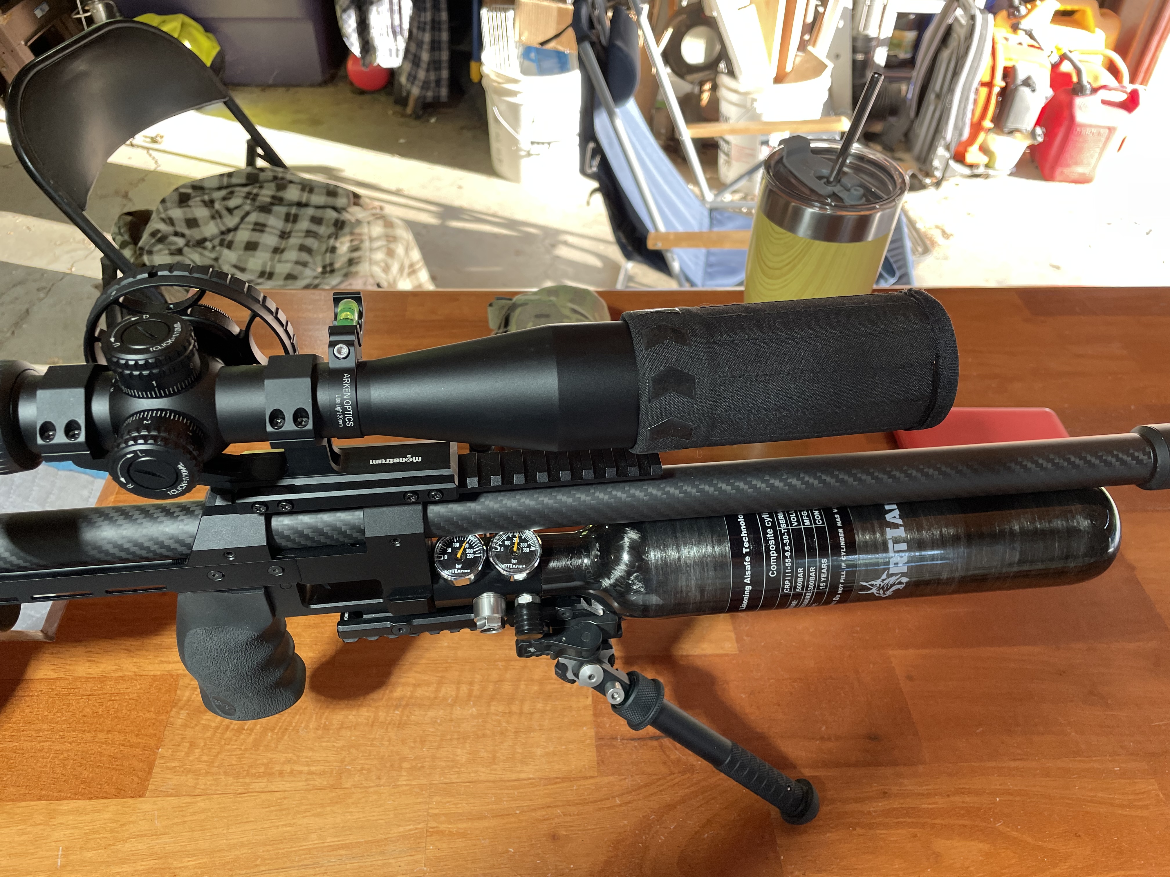

My Vector Veyron came with a kill flash instead of a traditional sun shade, and this scope, more than my others, really needs the glare reduction. I also use this cheap universal sun shade, which really helps. It looks silly, but I don’t mind at all.
@davecole I was wondering if a kill flash shared many benefits with a sunshade. Thanks for the bit about how it affected your video quality. I had some low-light footage on a squirrel and could not figure out why it came out the way that it did. I don’t even consider the effect of kill flash on the light gathering ability of the objective lens or the video quality.
