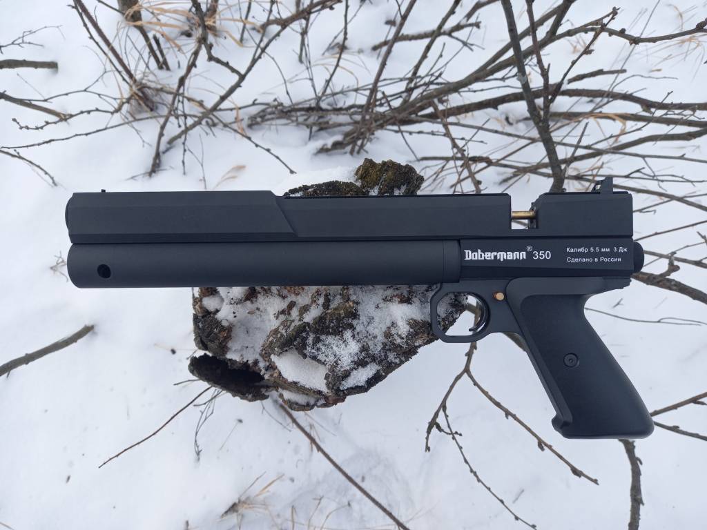

Hello. My name is John, i'm from Russia. I want to introduce you the pistol that i manufacturing. It is called DOBERMANN.

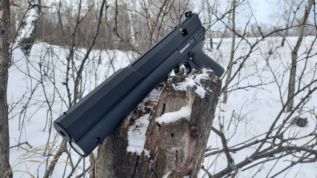

I assume the larger front half of the shroud in some of the photos relates to quieting the shot report?
The trigger block appears to be some variation of Crosman's. Considering the obvious quality of the whole gun, if the trigger is based on Crosman's I assume the trigger and sear components are highly improved on Crosman's?

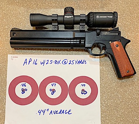

Thanks for good words. I start to make this pistol several years ago and always want to make it better and better. First time i was used to make Crosman's and Marauder's logos due to russian laws, but then i was qualified to make my own logo. Now it is a finished product and i can sell it, but i do not know if it is legal in USA. I can send it via EMS, DHL or other shipping company, but i don't know hor your customs office will react on such parcel.
Calibers - .177 /.22 /.25 (4.5 / 5.5 / 6.35)
Barrel lenght - 7.48 inches or 190 mm
Working pressure up to 3600 PSI (250 bar)
Shoots per fill up to 30 in .22 caliber
Mass 2.2 pounds

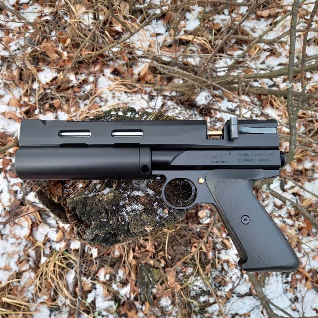

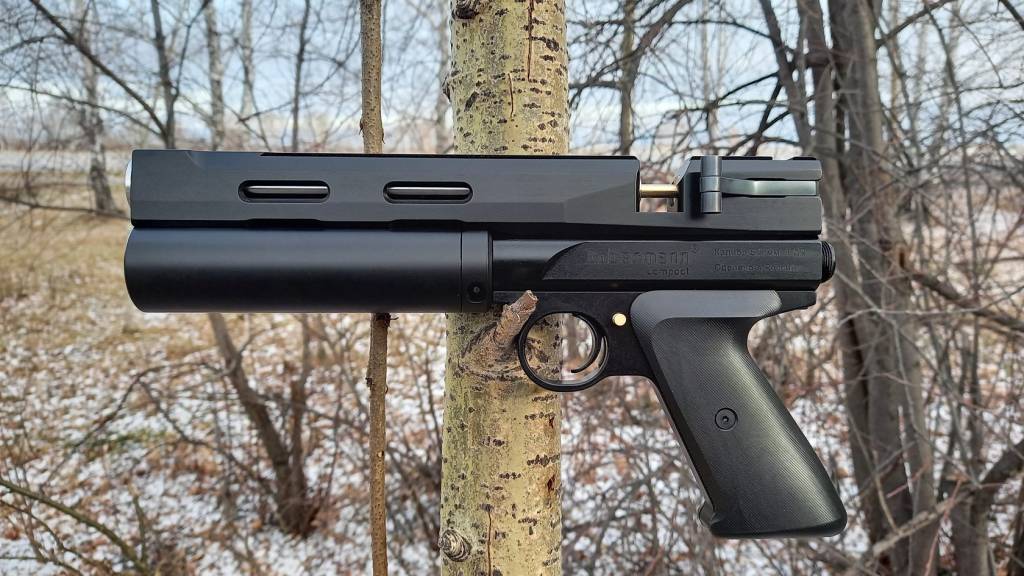

I have 2 models. First with inegrated shroud, second with separate shroud, so it is easier to transport it. Characteristics are the same.

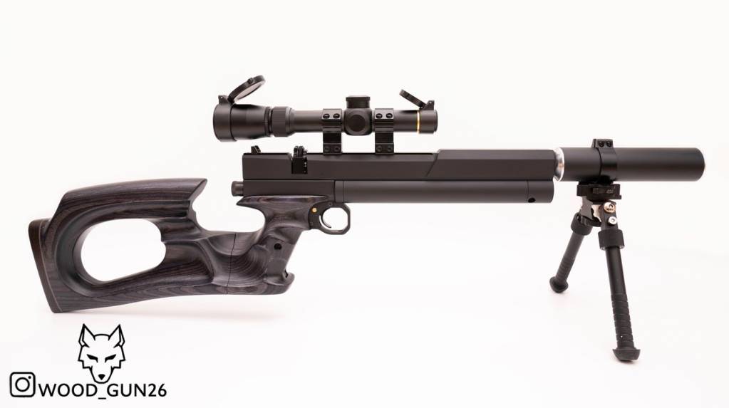

John, just a few questions :)
you mention you have 2 models, one with integrated shroud and one without. Are the picture above showing these?
If yes, then the model without integrated shroud also has smaller capacity air volume tank?

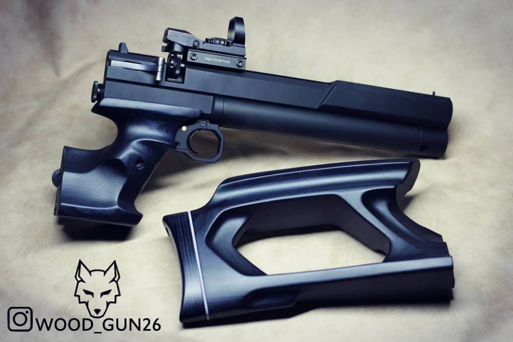

I really like the look! Expecially the Wood_gun26 version....

In the first post you can see both of them. First picture is without shroud, second picture shows pistol with integrated shroud. You are correct, pistol with integrated shroud have bigger capacity in the tank, but difference is not high, because in the short version tank is bigger in diameter.
