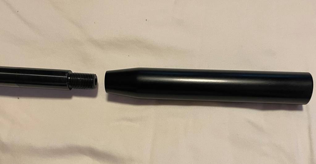

My HW95L .22 came with a moderator/silencer and after an ARH kit & GPL-205 lube this is the shot sound. The moderator is also useful for cocking the rifle. The rifle has an average of 710 FPS with FTT 14.66s and is very accurate.
