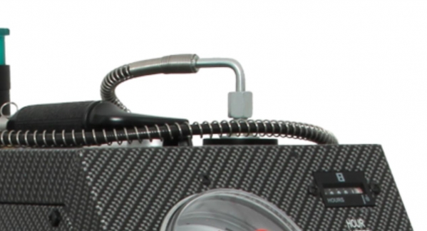

I have tried using Teflon tape and it only lasts a day or so when I use my Omega Super Charger. Does anybody have any experience using some kind of pipe dope for a sealant ... if so, what kind will hold up to that kind of pressure. My problem appears to be on the air output valve on top of the SC. When I use Teflon tape the pressure rises VERY well, but it only lasts a short time and I have to take the old off and put new tape on ... needs something more permanent or longer lasting

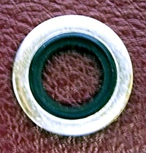

Does your output connector have a dowty seal. A dowty seal looks like a metal washer with a rubber inner edge. You don't use teflon tape on BSPP connectors which is what I think is on the Super Charger!

The fitting is on top of the compressor and it looks like a wide male fitting with a plastic o-ring in the hole on top. A steel ball with a hole in it fastens down to the plastic o-ring by a threaded encasement which screws down over the male fitting. I know it sounds weird but they changed out the fittings on the air output last year ... it used to be just a male fitting and a female quick release on top attached to the hose.
