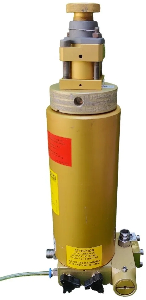

This is the same type of unit on my bauer. Based on the resale of the used units they last a long time.
It has all the bleeds necessary. The easy to replace filter/desiccant cartridge you can get for about $50 and will last you a long time considering it is made for filling diving tanks. Here is a current used one on ebay to give you an idea what a used one goes for.
