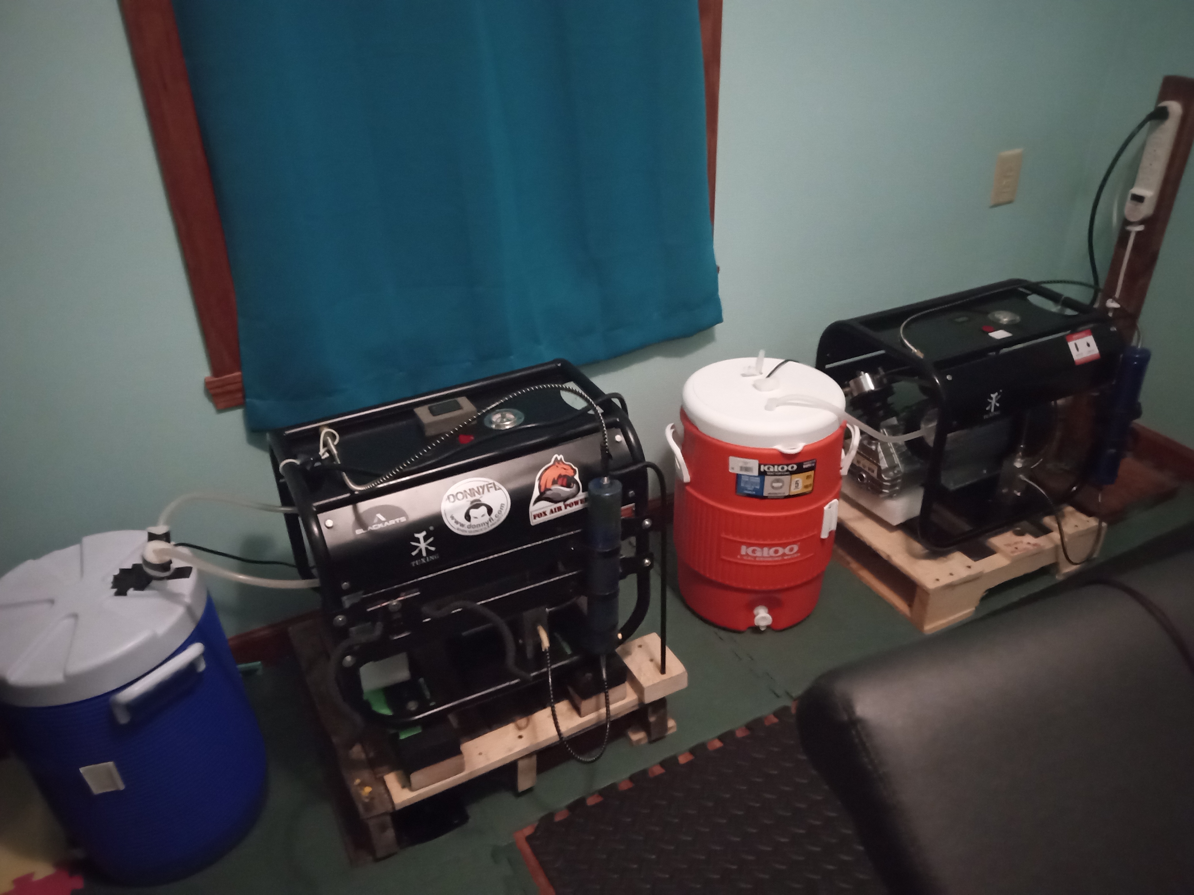

Now that's a air gunning mans room. :)
I have run ( for the past year ) one of the 4 Cylinder tuxing compressors ( knockoff on a Italian Coltri compressor )
So far no problems with it, but also just have like 4-5 hours of run time on it.
They are a whole other lower price than a Alkin or for that matter Coltri / Bayer / what ever western compressor.
