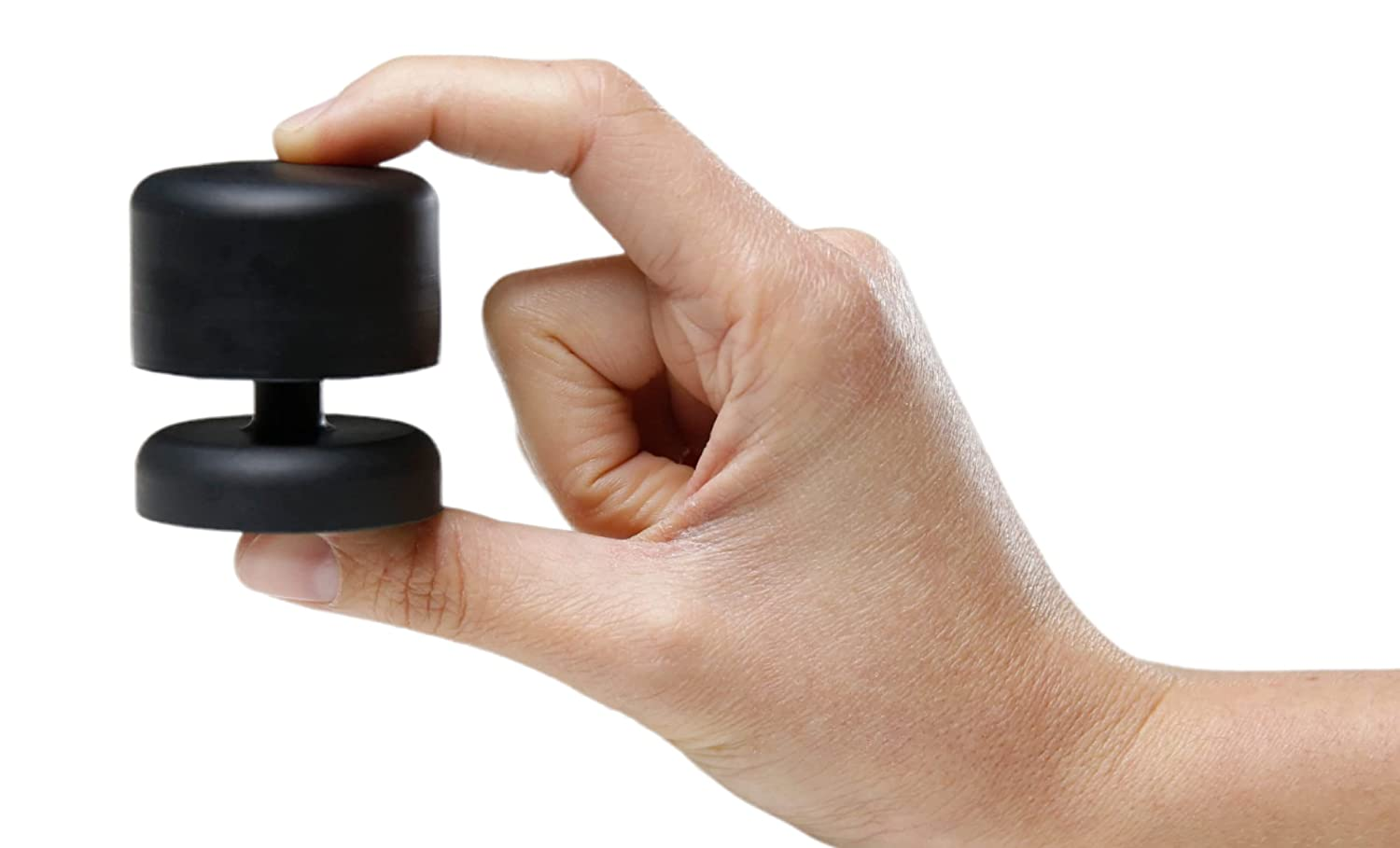

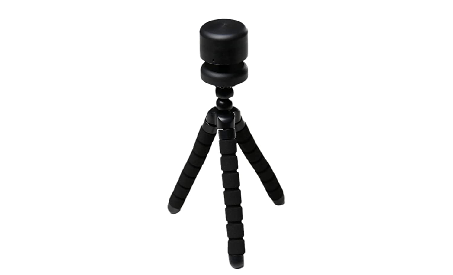

The Calypso case has a small hole on one side. Though that hole is sometimes referred to as a “dimple” or “arrow” in the documentation. The Calypso should be mounted in the vicinity of your shooting position, with that hole pointed toward your target. That will cause the Calypso to give the correct relative wind direction to Strelok.

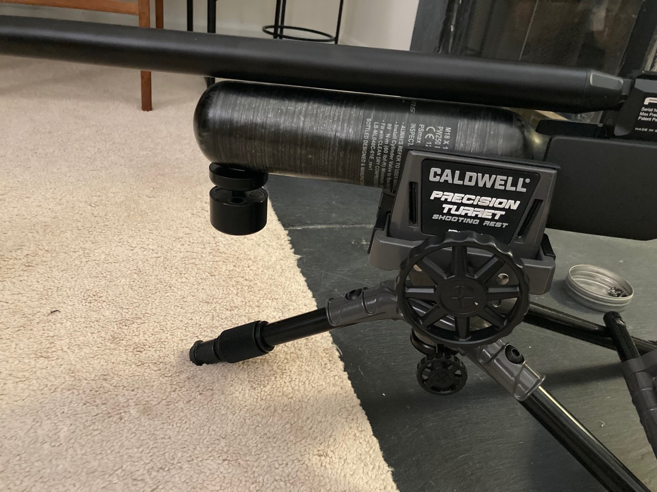

Mounting it upside down on your rifle (see photo above) should work in theory. It does not need to measure wind from behind you. Coupling your Strelok Pro or ATN scope with speed input (like from an FX Chrono) should give you a complete shooting solution (in addition to the Calypso). I think the ATN scope already has all the baro and temp data.

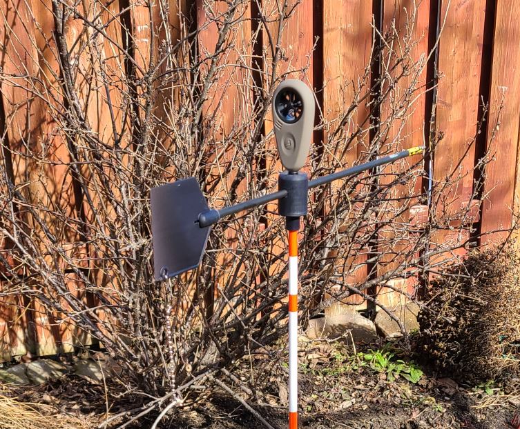

Mounting the Calypso on the airgun would make it very convenient to use. But some of my targets are far away and sometimes inclined up a hillside. I ordered a light stand that I can extend (up to 13’ high) to better have the Calypso up in the airstream.

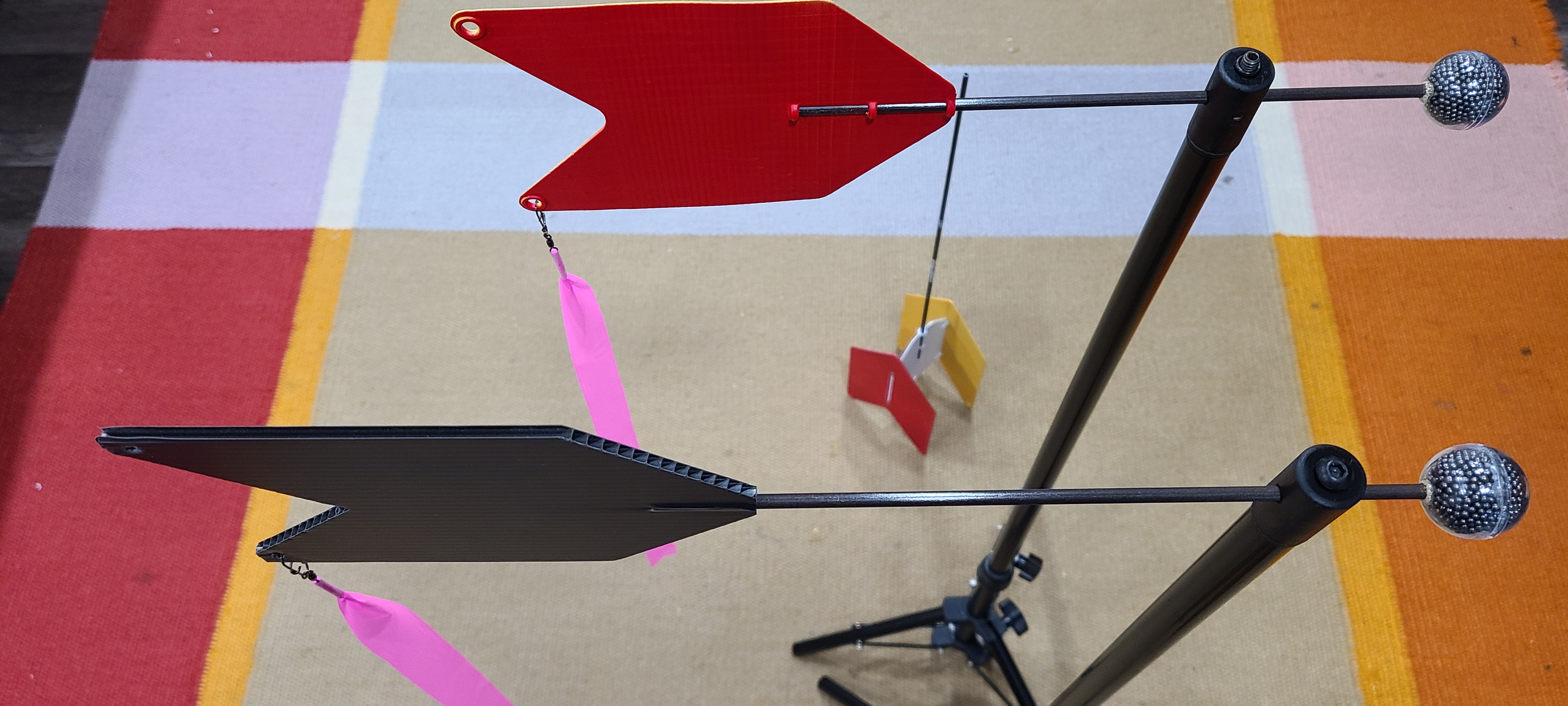

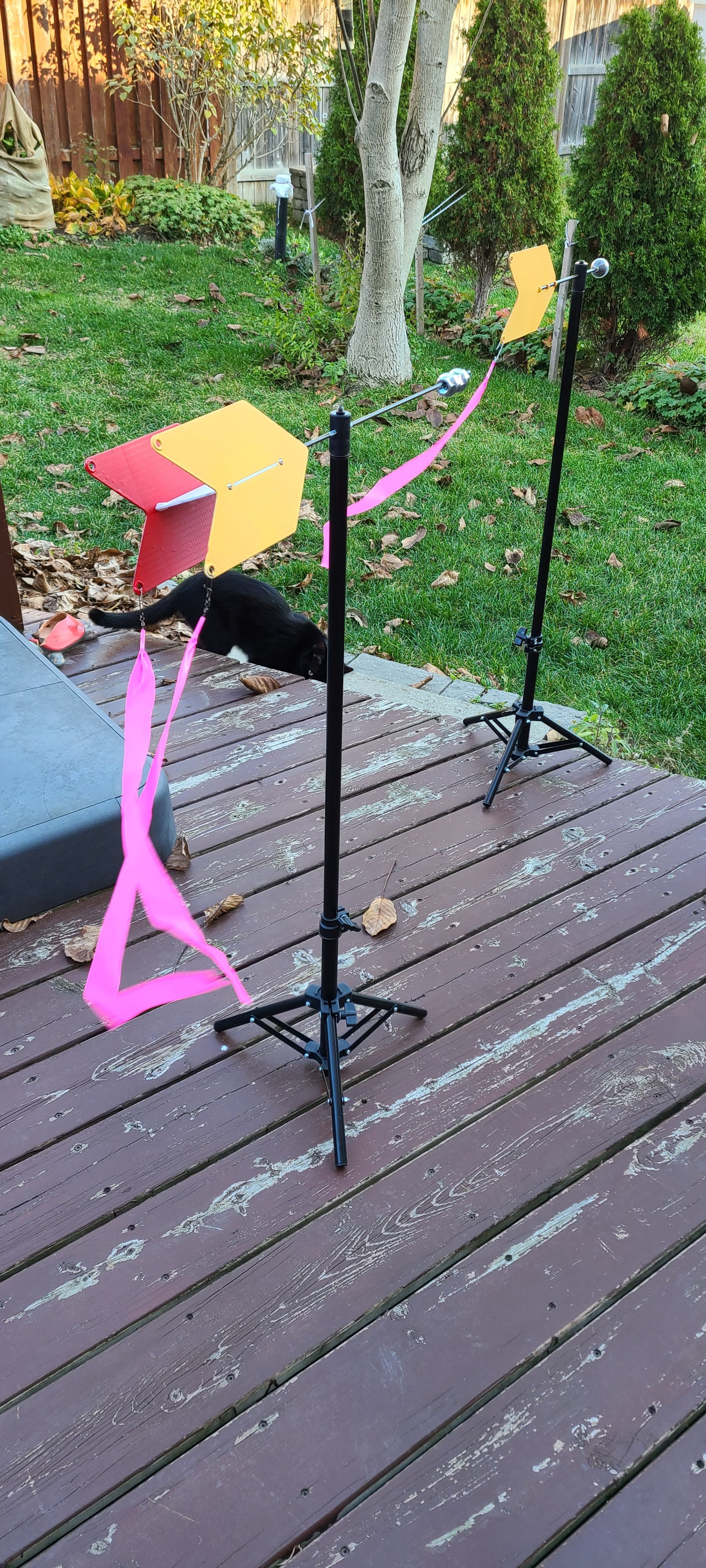

I have learned that heavier wind indicator blades with long wind tailes are much better, also played with the button in Strelok to slow down the bouncing.

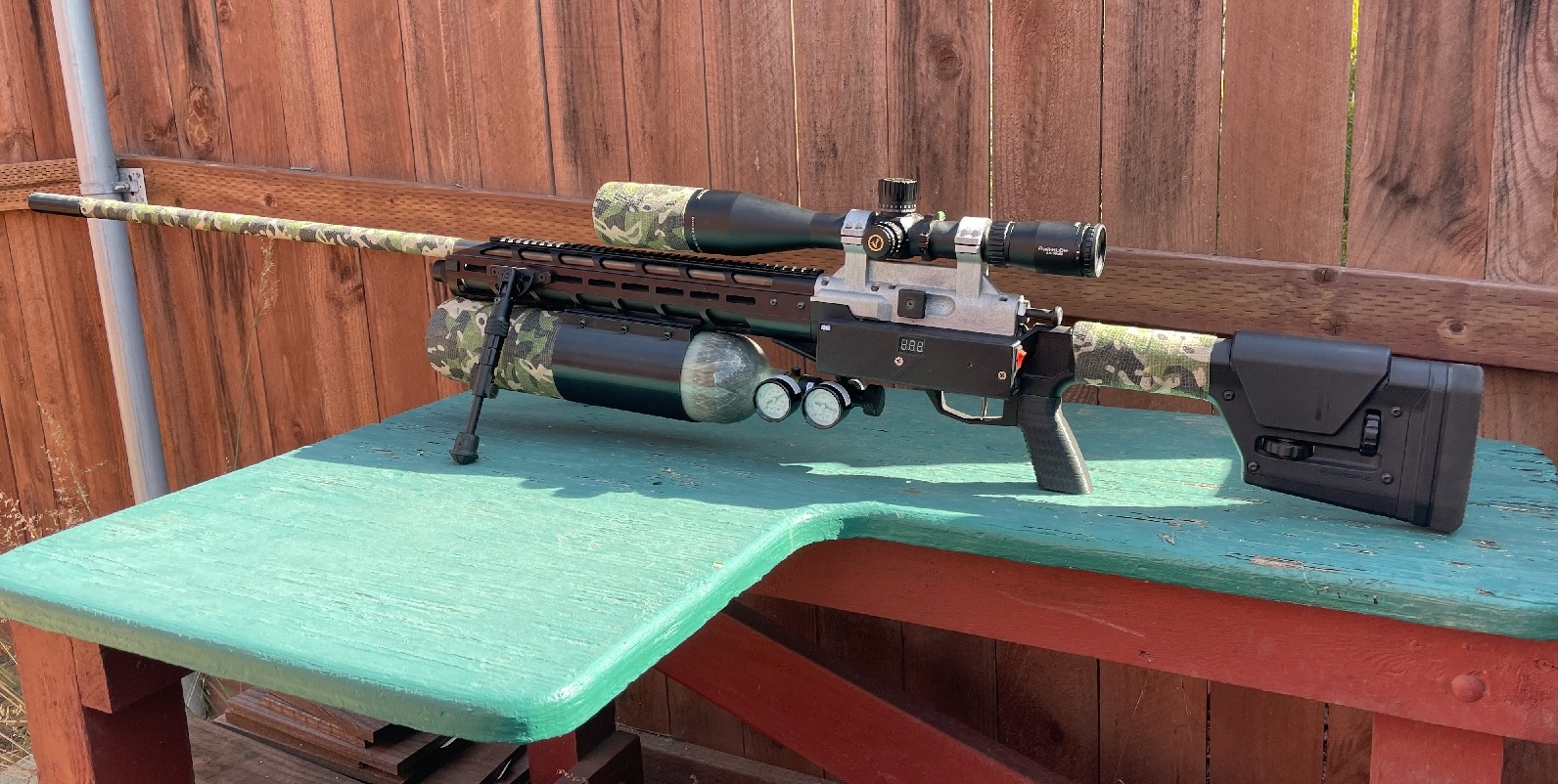

300m? What airgun do you have? o_O
That is a MONSTER! I read through the thread... Amazing build and congrats on the placings. Now doubt you need the wind that accurately. Good luck at the next ELR!
