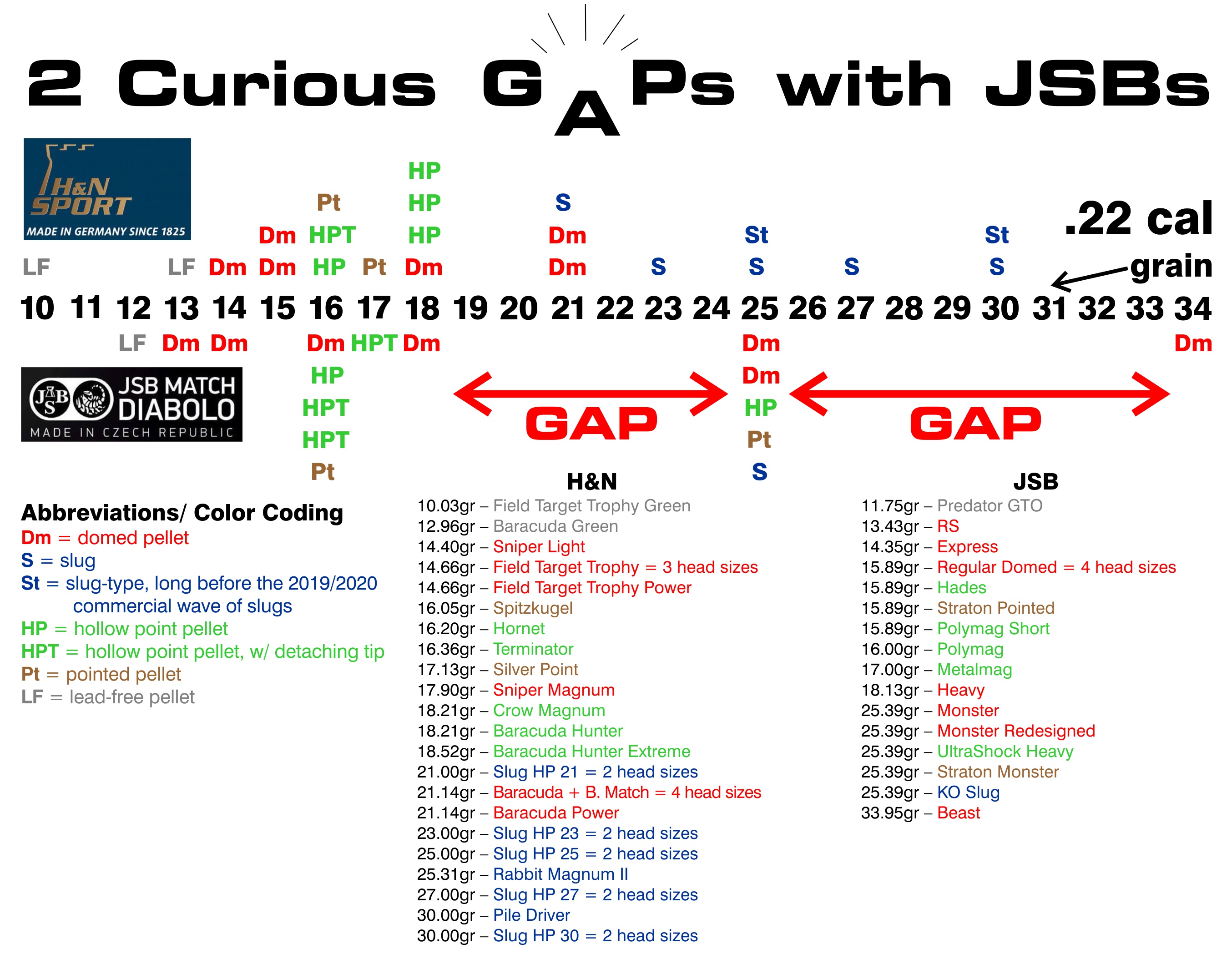

Does anyone wish that JSB would.....
I wish JSB would close up that curious hole in their .22cal offerings....
Glad that H&N keeps a full sortiment of weights, both domes and hollow points. 👍🏼

An 18 grainer to match the Heavy round nose would be good. I would like to see a JSB in a similar weight to the 21.1 H&N Barracuda. Why not, H&N makes weights similar to the 15.89 and the 18.13 JSBs. Can't beat 'em, copy 'em? The next weight JSB after the Heavy is the Monster.
I ordered some H&N Barracuda Hunter 18 HP to see how they do vs the JSB 18.13 from my HW100. It will be interesting to compare ballistics. Specs online show the BC nowhere near as good as the JSB though.
