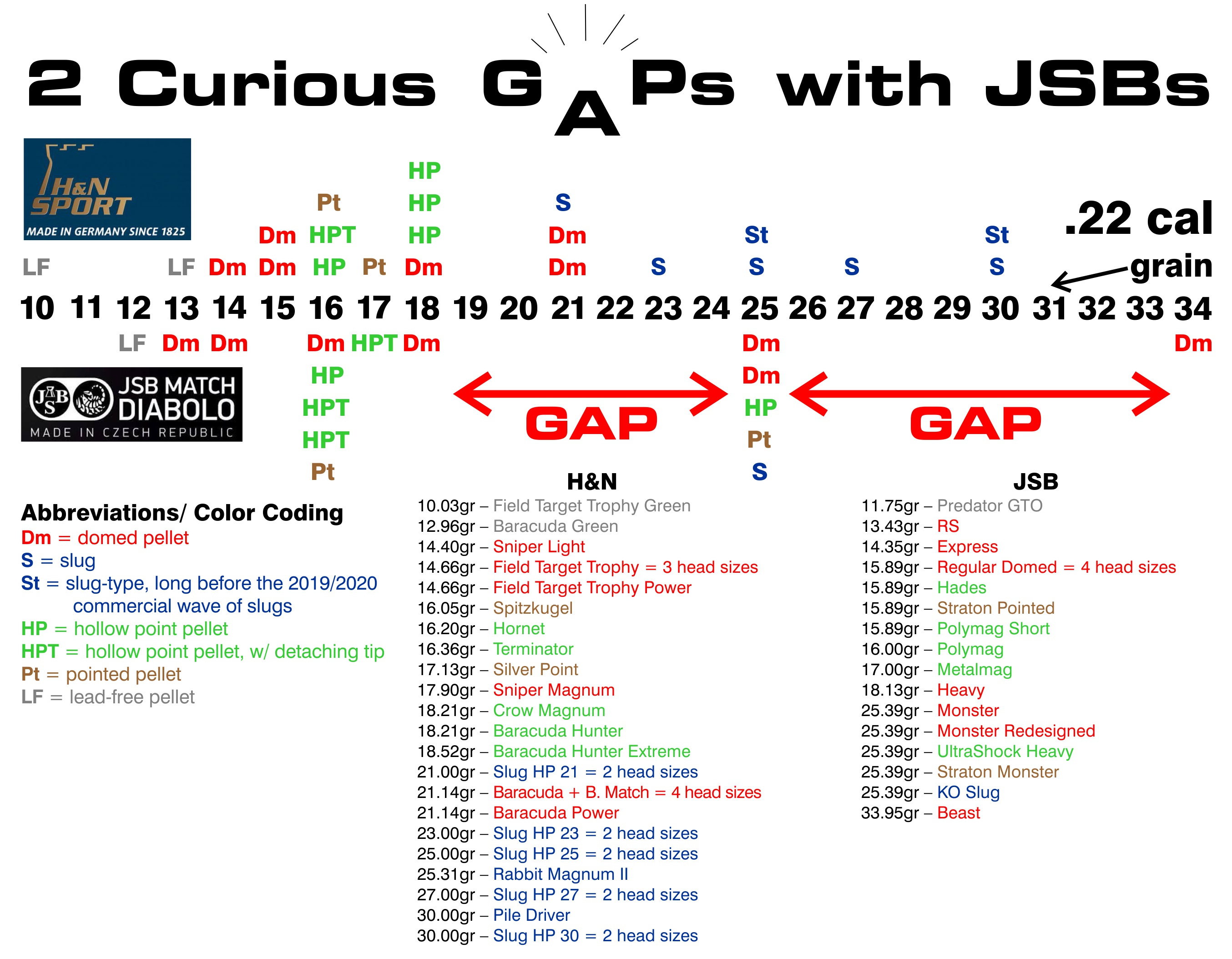

Does anyone wish that JSB would.....
I really like the 25 Hades. They shoot so close to the same POI as the 25.39 JSB’s that I don’t adjust my scope when i go shoot pigeons. Shots are 70 yds and closer so it works out well.
I cannot say the same for the Hades in 22 and the 18.13’s.
This is my experience as well with my .25 L2 -- MAYBE half a click difference at 30 yards, maybe. It's great because I'm zeroed for both pellets and can just go between them willynilly. Exact is very marginally more accurate, but it's so slight as to not matter.
I like the hadies but JSB really needs to update the weights , 10 years ago HN ammo used to be horrible today H&N makes a great selection of pellet and slug weights from light to heavy , Today I have more H&N ammo then JSB in stock and unless jsb changes weights I going to replace what I use meaning jsb to H&N for future stock , I really like accuracy of JSB but I need more weight selections then they offer today

It would be great if they went back to screw on lids.......(y)
H&N has been giving us screw-on lids for years...! 😊
JSB really needs to update the weights. [...]
H&N makes a great selection of pellet and slug weights from light to heavy.
Today I have more H&N ammo then JSB in stock.
I need more weight selections then [JSB] offers today.

LOU, that's exactly what bugs me about JSB, too!!
H&N has a much broader selection. Their pellets are made in Germany. And they just came out with a super heavy slug line, besides their regular slugs.

I wish JSB would close up that curious hole in their .22cal offerings....
Glad that H&N keeps a full sortiment of weights, both domes and hollow points. 👍🏼

Wouldn't mind Hades "heavies" in .25 and .30
Also 50.15 grain Diabolo needs to be redesigned IMO... poor accuracy compared to the 44.75
I think that depends on the gun. In the .30 Delta/Alpha Wolf and .30 Cricket TAC the 50 shoots better than the 44, and has a better BC.
